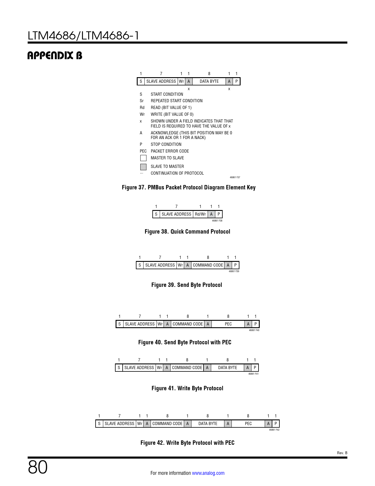

APPENDIX B. Figure 37. PMBus Packet Protocol Diagram Element Key. Figure 38. Quick Command Protocol
APPENDIX B Figure 37 PMBus Packet Protocol Diagram Element Key Figure 38 Quick Command Protocol
LTM4686/LTM4686-1
APPENDIX B
1 7 1 1 8 1 1 S SLAVE ADDRESS Wr A DATA BYTE A P x x S START CONDITION Sr REPEATED START CONDITION Rd READ (BIT VALUE OF 1) Wr WRITE (BIT VALUE OF 0) x SHOWN UNDER A FIELD INDICATES THAT THAT FIELD IS REQUIRED TO HAVE THE VALUE OF x A ACKNOWLEDGE (THIS BIT POSITION MAY BE 0 FOR AN ACK OR 1 FOR A NACK) P STOP CONDITION PEC PACKET ERROR CODE MASTER TO SLAVE SLAVE TO MASTER ... CONTINUATION OF PROTOCOL 46861 F37
1 7 1 1 1 S SLAVE ADDRESS Rd/Wr A P 46861 F38
1 7 1 1 8 1 1 S SLAVE ADDRESS Wr A COMMAND CODE A P 46861 F39
Figure 39. Send Byte Protocol
1 7 1 1 8 1 8 1 1 S SLAVE ADDRESS Wr A COMMAND CODE A PEC A P 46861 F40
Figure 40. Send Byte Protocol with PEC
1 7 1 1 8 1 8 1 1 S SLAVE ADDRESS Wr A COMMAND CODE A DATA BYTE A P 46861 F41
Figure 41. Write Byte Protocol
1 7 1 1 8 1 8 1 8 1 1 S SLAVE ADDRESS Wr A COMMAND CODE A DATA BYTE A PEC A P 46861 F42
Figure 42. Write Byte Protocol with PEC
