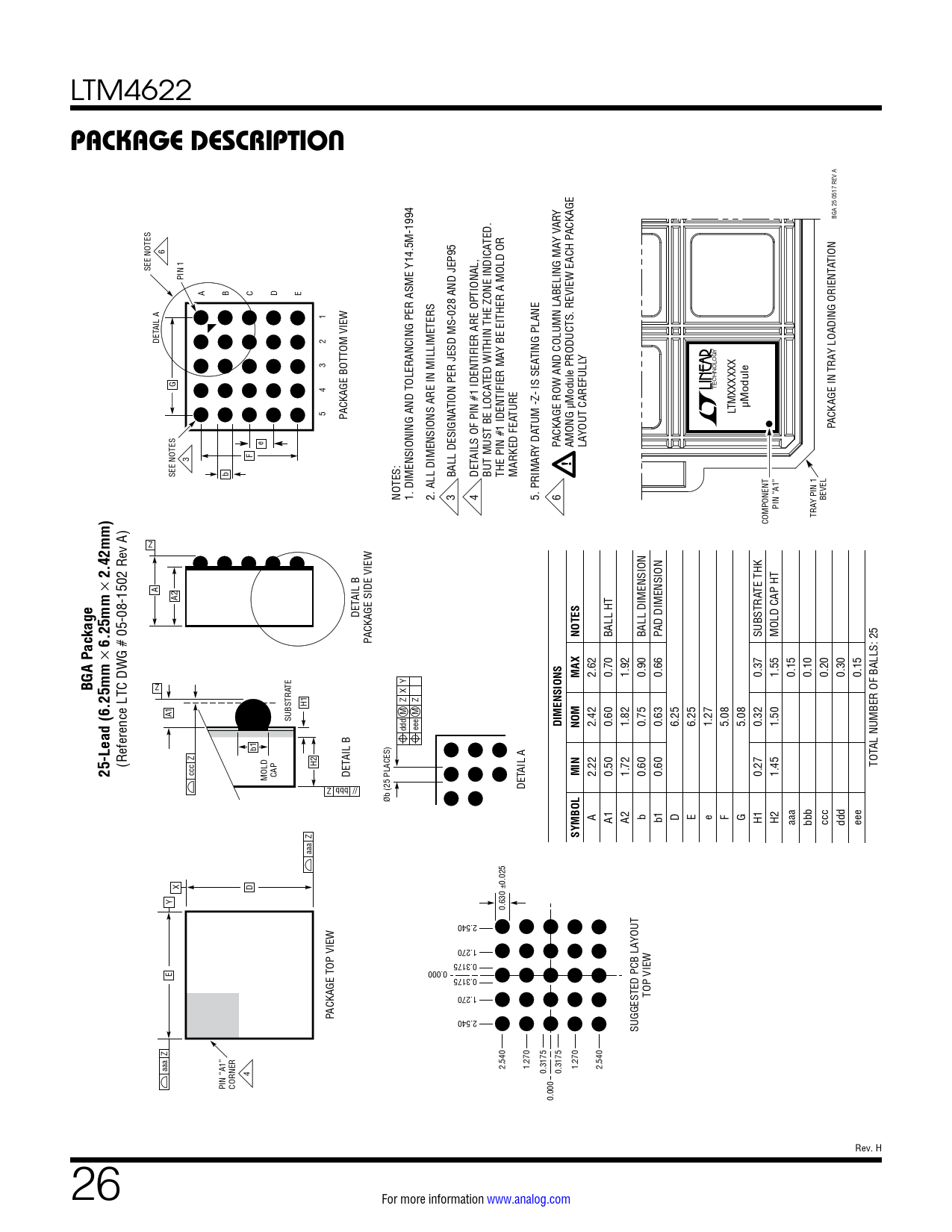

PACKAGE DESCRIPTION. 2.42mm). NOTES. 6.25mm. MAX. BGA Package. DIMENSIONS. NOM. 25-Lead (6.25mm. MIN. SYMBOL
PACKAGE DESCRIPTION 2.42mm) NOTES 6.25mm MAX BGA Package DIMENSIONS NOM 25-Lead (6.25mm MIN SYMBOL
LTM4622
PACKAGE DESCRIPTION
Y BGA 25 0517 REV A AR ACKAGE TED. Y V 6 ATION SEE NOTES PIN 1 A B C D E TIONAL, 1 AIL A DET 2 TOM VIEW Y BE EITHER A MOLD OR Y LOADING ORIENT TING PLANE Y 3 G TED WITHIN THE ZONE INDICA 4 TION PER JESD MS-028 AND JEP95 5 PACKAGE BOT TURE LTMXXXXXX µModule TUM -Z- IS SEA PACKAGE IN TRA YOUT CAREFULL e Y DA PACKAGE ROW AND COLUMN LABELING MA AMONG µModule PRODUCTS. REVIEW EACH P LA 3 F AILS OF PIN #1 IDENTIFIER ARE OP
SEE NOTES b DET BUT MUST BE LOCA THE PIN #1 IDENTIFIER MA MARKED FEA NOTES: 1. DIMENSIONING AND TOLERANCING PER ASME Y14.5M-1994 2. ALL DIMENSIONS ARE IN MILLIMETERS 3 BALL DESIGNA 4 5. PRIMAR 6 Y PIN 1 BEVEL PIN “A1” TRA COMPONENT Z ×
2.42mm)
A TE THK A2 AIL B DET PACKAGE SIDE VIEW
NOTES
BALL HT BALL DIMENSION PAD DIMENSION SUBSTRA MOLD CAP HT ×
6.25mm MAX
2.62 0.70 1.92 0.90 0.66 0.37 1.55 0.15 0.10 0.20 0.30 0.15 Z Y
BGA Package
TE X Z Z H1 M M A1 SUBSTRA
DIMENSIONS
ddd eee
NOM
2.42 0.60 1.82 0.75 0.63 6.25 6.25 1.27 5.08 5.08 0.32 1.50 b1 AL NUMBER OF BALLS: 25 (Reference LTC DWG # 05-08-1502 Rev A) AIL B H2 AIL A
25-Lead (6.25mm
TOT ccc Z DET
MIN
2.22 0.50 1.72 0.60 0.60 0.27 1.45 MOLD CAP // bbb Z DET Øb (25 PLACES) A A1 A2 b b1 D E e F G H1 H2 aaa bbb ccc ddd eee
SYMBOL
aaa Z X D Y 0.630 ±0.025 2.540 YOUT 1.270 0.3175 0.000 E 0.3175 1.270 TOP VIEW PACKAGE TOP VIEW 2.540 SUGGESTED PCB LA aaa Z 2.540 1.270 1.270 2.540 4 0.3175 0.3175 PIN “A1” CORNER 0.000 Rev. H 26 For more information www.analog.com Document Outline Features Applications Typical Application Description Absolute Maximum Ratings Pin Configuration Order Information Electrical Characteristics Typical Performance Characteristics Pin Functions Block Diagram Decoupling Requirements Operation Applications Information Safety Considerations Layout Checklist/Example Package Description Revision History Package Photo Design Resources Related Parts
