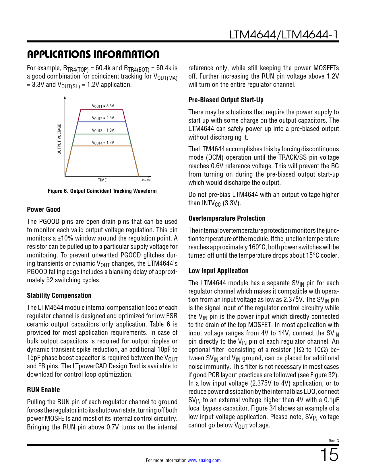

For example, RTR4(TOP) = 60.4k and RTR4(BOT) = 60.4k is reference only, while still keeping the power MOSFETs a good combination for coincident tracking for VOUT(MA) off. Further increasing the RUN pin voltage above 1.2V = 3.3V and VOUT(SL) = 1.2V application. will turn on the entire regulator channel.
Pre-Biased Output Start-Up
VOUT1 = 3.3V There may be situations that require the power supply to VOUT2 = 2.5V start up with some charge on the output capacitors. The TAGE VOUT3 = 1.8V LTM4644 can safely power up into a pre-biased output without discharging it. VOUT4 = 1.2V The LTM4644 accomplishes this by forcing discontinuous OUTPUT VOL mode (DCM) operation until the TRACK/SS pin voltage reaches 0.6V reference voltage. This will prevent the BG from turning on during the pre-biased output start-up TIME 4644 F06 which would discharge the output.
Figure 6. Output Coincident Tracking Waveform
