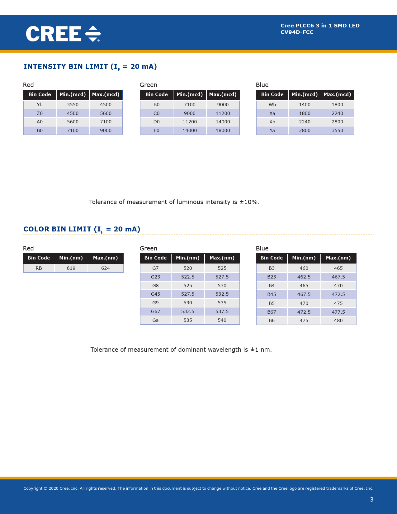

Pages / Page11 / 3 — Cree PLCC6 3 in 1 SMD LED. CV94D-FCC. INTENSITY BIN LIMIT (I = 20 mA). …
Cree PLCC6 3 in 1 SMD LED. CV94D-FCC. INTENSITY BIN LIMIT (I = 20 mA). Bin Code. Min.(mcd) Max.(mcd). Min.(mcd). Max.(mcd)
Cree PLCC6 3 in 1 SMD LED CV94D-FCC INTENSITY BIN LIMIT (I = 20 mA) Bin Code Min.(mcd) Max.(mcd) Min.(mcd) Max.(mcd)
Cree PLCC6 3 in 1 SMD LED CV94D-FCC INTENSITY BIN LIMIT (I = 20 mA) F
Red Green Blue
Bin Code Min.(mcd) Max.(mcd) Bin Code Min.(mcd) Max.(mcd) Bin Code Min.(mcd) Max.(mcd)
Yb 3550 4500 B0 7100 9000 Wb 1400 1800 Z0 4500 5600 C0 9000 11200 Xa 1800 2240 A0 5600 7100 D0 11200 14000 Xb 2240 2800 B0 7100 9000 E0 14000 18000 Ya 2800 3550 Tolerance of measurement of luminous intensity is ±10%.
COLOR BIN LIMIT (I = 20 mA) F
Red Green Blue
Bin Code Min.(nm) Max.(nm) Bin Code Min.(nm) Max.(nm) Bin Code Min.(nm) Max.(nm)
RB 619 624 G7 520 525 B3 460 465 G23 522.5 527.5 B23 462.5 467.5 G8 525 530 B4 465 470 G45 527.5 532.5 B45 467.5 472.5 G9 530 535 B5 470 475 G67 532.5 537.5 B67 472.5 477.5 Ga 535 540 B6 475 480 Tolerance of measurement of dominant wavelength is ±1 nm. Copyright © 2010 Cree, Inc. All rights reserved. The information in this document is subject to change without notice. Cree, the Cree logo and XLamp are registered trademarks of Cree, Inc. Copyright © 2020 Cree, Inc. All rights reserved. The information in this document is subject to change without notice. Cree and the Cree logo are registered trademarks of Cree, Inc. 3
