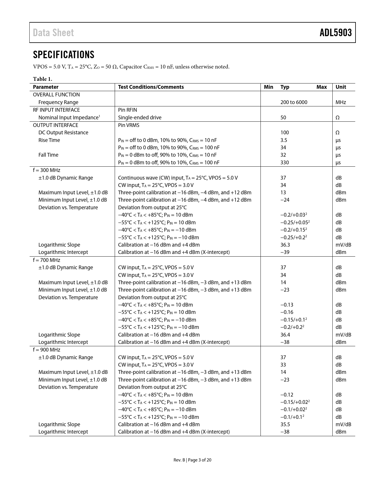

Data Sheet. ADL5903. SPECIFICATIONS. Table 1. Parameter. Test Conditions/Comments. Min Typ. Max. Unit
Data Sheet ADL5903 SPECIFICATIONS Table 1 Parameter Test Conditions/Comments Min Typ Max Unit
link to page 5 link to page 5 link to page 5 link to page 5 link to page 5 link to page 5 link to page 5 link to page 5 link to page 5
VPOS = 5.0 V, TA = 25°C, ZO = 50 Ω, Capacitor CRMS = 10 nF, unless otherwise noted.
Table 1. Parameter Test Conditions/Comments Min Typ Max Unit
OVERALL FUNCTION Frequency Range 200 to 6000 MHz RF INPUT INTERFACE Pin RFIN Nominal Input Impedance1 Single-ended drive 50 Ω OUTPUT INTERFACE Pin VRMS DC Output Resistance 100 Ω Rise Time PIN = off to 0 dBm, 10% to 90%, CRMS = 10 nF 3.5 µs PIN = off to 0 dBm, 10% to 90%, CRMS = 100 nF 34 µs Fall Time PIN = 0 dBm to off, 90% to 10%, CRMS = 10 nF 32 µs PIN = 0 dBm to off, 90% to 10%, CRMS = 100 nF 330 µs f = 300 MHz ±1.0 dB Dynamic Range Continuous wave (CW) input, TA = 25°C, VPOS = 5.0 V 37 dB CW input, TA = 25°C, VPOS = 3.0 V 34 dB Maximum Input Level, ±1.0 dB Three-point calibration at −16 dBm, −4 dBm, and +12 dBm 13 dBm Minimum Input Level, ±1.0 dB Three-point calibration at −16 dBm, −4 dBm, and +12 dBm −24 dBm Deviation vs. Temperature Deviation from output at 25°C −40°C < TA < +85°C; PIN = 10 dBm −0.2/+0.032 dB −55°C < TA < +125°C; PIN = 10 dBm −0.25/+0.052 dB −40°C < TA < +85°C; PIN = −10 dBm −0.2/+0.152 dB −55°C < TA < +125°C; PIN = −10 dBm −0.25/+0.22 dB Logarithmic Slope Calibration at −16 dBm and +4 dBm 36.3 mV/dB Logarithmic Intercept Calibration at −16 dBm and +4 dBm (X-intercept) −39 dBm f = 700 MHz ±1.0 dB Dynamic Range CW input, TA = 25°C, VPOS = 5.0 V 37 dB CW input, TA = 25°C, VPOS = 3.0 V 34 dB Maximum Input Level, ±1.0 dB Three-point calibration at −16 dBm, −3 dBm, and +13 dBm 14 dBm Minimum Input Level, ±1.0 dB Three-point calibration at −16 dBm, −3 dBm, and +13 dBm −23 dBm Deviation vs. Temperature Deviation from output at 25°C −40°C < TA < +85°C; PIN = 10 dBm −0.13 dB −55°C < TA < +125°C; PIN = 10 dBm −0.16 dB −40°C < TA < +85°C; PIN = −10 dBm −0.15/+0.12 dB −55°C < TA < +125°C; PIN = −10 dBm −0.2/+0.22 dB Logarithmic Slope Calibration at −16 dBm and +4 dBm 36.4 mV/dB Logarithmic Intercept Calibration at −16 dBm and +4 dBm (X-intercept) −38 dBm f = 900 MHz ±1.0 dB Dynamic Range CW input, TA = 25°C, VPOS = 5.0 V 37 dB CW input, TA = 25°C, VPOS = 3.0 V 33 dB Maximum Input Level, ±1.0 dB Three-point calibration at −16 dBm, −3 dBm, and +13 dBm 14 dBm Minimum Input Level, ±1.0 dB Three-point calibration at −16 dBm, −3 dBm, and +13 dBm −23 dBm Deviation vs. Temperature Deviation from output at 25°C −40°C < TA < +85°C; PIN = 10 dBm −0.12 dB −55°C < TA < +125°C; PIN = 10 dBm −0.15/+0.022 dB −40°C < TA < +85°C; PIN = −10 dBm −0.1/+0.022 dB −55°C < TA < +125°C; PIN = −10 dBm −0.1/+0.12 dB Logarithmic Slope Calibration at −16 dBm and +4 dBm 35.5 mV/dB Logarithmic Intercept Calibration at −16 dBm and +4 dBm (X-intercept) −38 dBm Rev. B | Page 3 of 20 Document Outline FEATURES APPLICATIONS FUNCTIONAL BLOCK DIAGRAM GENERAL DESCRIPTION TABLE OF CONTENTS REVISION HISTORY SPECIFICATIONS ABSOLUTE MAXIMUM RATINGS ESD CAUTION PIN CONFIGURATION AND FUNCTION DESCRIPTIONS TYPICAL PERFORMANCE CHARACTERISTICS MEASUREMENT SETUPS THEORY OF OPERATION RF INPUT INTERFACE BASIC CONNECTIONS CHOOSING A VALUE FOR CRMS DEVICE CALIBRATION AND ERROR CALCULATION EVALUATION BOARD SCHEMATIC AND CONFIGURATION OPTIONS OUTLINE DIMENSIONS ORDERING GUIDE
