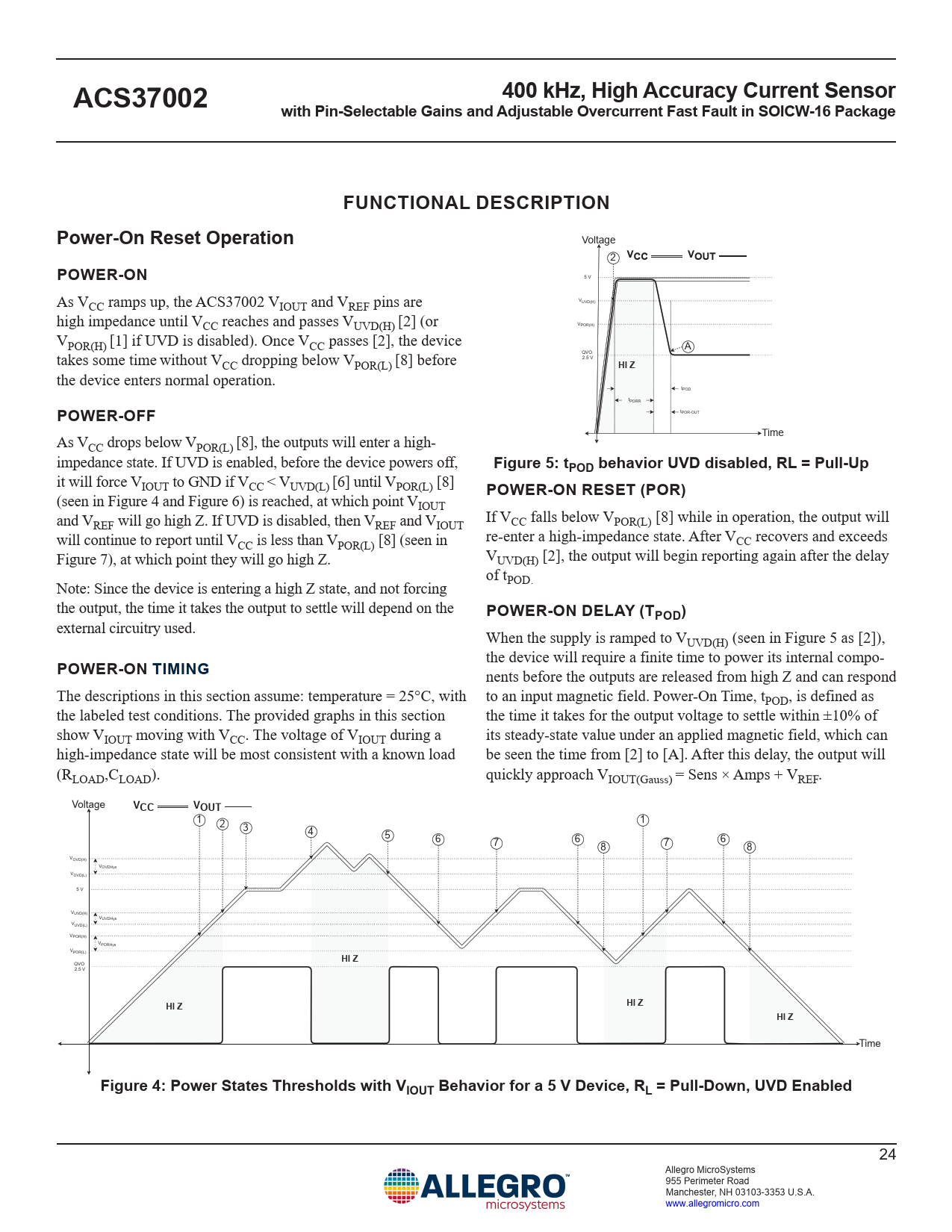

400 kHz, High Accuracy Current Sensor ACS37002 with Pin-Selectable Gains and Adjustable Overcurrent Fast Fault in SOICW-16 Package FUNCTIONAL DESCRIPTION Power-On Reset Operation
Voltage 2
VCC VOUT
5 V
POWER-ON
VUVD(H) As VCC ramps up, the ACS37002 VIOUT and VREF pins are V high impedance until V POR(H) CC reaches and passes VUVD(H) [2] (or VPOR(H) [1] if UVD is disabled). Once VCC passes [2], the device A QVO 2.5 V takes some time without VCC dropping below VPOR(L) [8] before
HI Z
the device enters normal operation. tPOD tPORR tPOR-OUT
POWER-OFF
Time As VCC drops below VPOR(L) [8], the outputs will enter a high- impedance state. If UVD is enabled, before the device powers off,
Figure 5: tPOD behavior UVD disabled, RL = Pull-Up
it will force VIOUT to GND if VCC < VUVD(L) [6] until VPOR(L) [8] (seen in Figure 4 and Figure 6) is reached, at which point V
POWER-ON RESET (POR)
IOUT and V If V REF will go high Z. If UVD is disabled, then VREF and VIOUT CC falls below VPOR(L) [8] while in operation, the output will will continue to report until V re-enter a high-impedance state. After V CC is less than VPOR(L) [8] (seen in CC recovers and exceeds Figure 7), at which point they will go high Z. VUVD(H) [2], the output will begin reporting again after the delay of t Note: Since the device is entering a high Z state, and not forcing POD. the output, the time it takes the output to settle will depend on the
POWER-ON DELAY (TPOD)
external circuitry used. When the supply is ramped to VUVD(H) (seen in Figure 5 as [2]), the device will require a finite time to power its internal compo-
POWER-ON TIMING
nents before the outputs are released from high Z and can respond The descriptions in this section assume: temperature = 25°C, with to an input magnetic field. Power-On Time, tPOD, is defined as the labeled test conditions. The provided graphs in this section the time it takes for the output voltage to settle within ±10% of show VIOUT moving with VCC. The voltage of VIOUT during a its steady-state value under an applied magnetic field, which can high-impedance state will be most consistent with a known load be seen the time from [2] to [A]. After this delay, the output will (RLOAD,CLOAD). quickly approach VIOUT(Gauss) = Sens × Amps + VREF. Voltage
VCC VOUT
1 2 1 3 4 5 6 7 6 6 8 7 8 VOVD(H) VOVDHys VOVD(L) 5 V VUVD(H) VUVDHys VUVD(L) VPOR(H) VPORHys VPOR(L)
HI Z
QVO 2.5 V
HI Z HI Z HI Z
Time
Figure 4: Power States Thresholds with VIOUT Behavior for a 5 V Device, RL = Pull-Down, UVD Enabled
