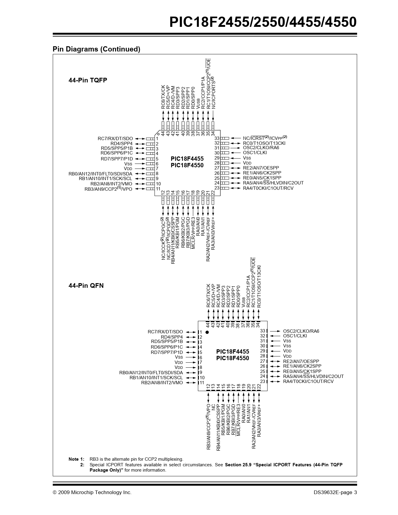

PIC18F2455/2550/4455/4550. Pin Diagrams (Continued). 44-Pin TQFP. (2). PIC18F4455. PIC18F4550. (1). 44-Pin QFN. Note 1:
PIC18F2455/2550/4455/4550 Pin Diagrams (Continued) 44-Pin TQFP (2) PIC18F4455 PIC18F4550 (1) 44-Pin QFN Note 1:
E O
/U
(1
2
) 44-Pin TQFP

44-Pin QFN

Note 1:
RB3 is the alternate pin for CCP2 multiplexing.
2:
Special ICPORT features available in select circumstances. See
Section 25.9 “Special ICPORT Features (44-Pin TQFP Package Only)”
