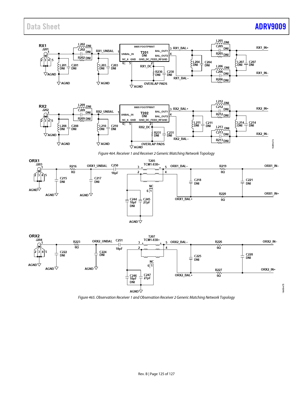

Data Sheet. ADRV9009. L205 DNI. L202. RX1. DNI. 0805 FOOTPRINT. C205. RX1_IN+. J201. C202. 3 RX1_BAL+. RX1_UNBAL. BAL_OUT1. T201. UNBAL_IN. R205
Data Sheet ADRV9009 L205 DNI L202 RX1 DNI 0805 FOOTPRINT C205 RX1_IN+ J201 C202 3 RX1_BAL+ RX1_UNBAL BAL_OUT1 T201 UNBAL_IN R205
Data Sheet ADRV9009 L205 DNI L202 RX1 DNI 0805 FOOTPRINT C205 RX1_IN+ J201 C202 3 RX1_BAL+ DNI 1 DNI RX1_UNBAL 1 BAL_OUT1 T201 UNBAL_IN 4 R205 DNI BAL_OUT2 DNI R202 DNI NC_6 GND GND_DC_FEED_RFGND 2 3 4 5 6 5 2 L204 C204 L207 C207 L201 C201 L203 C203 RX1_DC DNI DNI L206 DNI DNI DNI DNI DNI DNI DNI R230 C230 C206 RX1_IN– AGND DNI DNI DNI RX1_BAL– R206 DNI AGND AGND OVERLAP PADS AGND L212 DNI L209 RX2 DNI 0805 FOOTPRINT C212 RX2_IN+ J202 C209 3 RX2_BAL+ DNI 1 DNI RX2_UNBAL 1 BAL_OUT1 T202 UNBAL_IN 4 R212 DNI BAL_OUT2 DNI R209 DNI NC_6 GND GND_DC_FEED_RFGND 2 3 4 5 6 5 2 L211 C211 L214 C214 L208 C208 L210 C210 RX2_DC DNI DNI L213 DNI DNI DNI DNI DNI DNI DNI R231 C231 C213 RX2_IN– AGND DNI DNI DNI RX2_BAL– R213 DNI
74
-4
AGND
499 16 Figure 464. Receiver 1 and Receiver 2 Generic Matching Network Topology
ORX1 T205 J203 TCM1-83X+ ORX1_UNBAL C250 R216 ORX1_BAL– R219 ORX1_IN– 1 3 5 18pF 2 4 2 3 4 5 C215 C217 C218 C221 DNI DNI DNI DNI NC AGND 6 1 R220 ORX1_IN+ AGND AGND C244 C245 ORX1_BAL+ 10pF 27pF DNI AGND ORX2 T207 J204 C251 TCM1-83X+ R223 ORX2_UNBAL 1 3 5 ORX2_BAL– R226 ORX2_IN– 18pF 2 4 2 3 4 5 C222 C224 DNI DNI C228 C225 DNI DNI NC AGND 6 1 AGND AGND R227 ORX2_IN+ C246 C247 ORX2_BAL+ 10pF 27pF DNI
