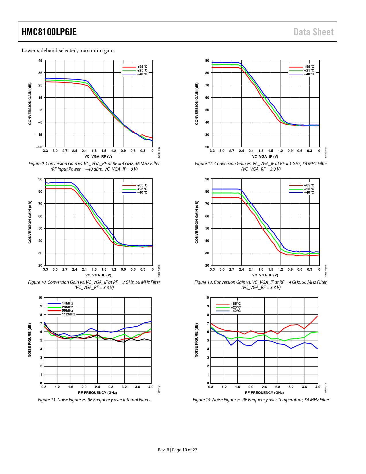

Lower sideband selected, maximum gain.
45 90 +85°C +85°C +25°C +25°C 35 –40°C 80 –40°C ) ) B 25 B 70 d d ( ( IN IN A A 15 60 G G N N O O SI 5 SI 50 VER VER N N O –5 O C 40 C –15 30 –25 20 3.3 3.0 2.7 2.4 2.1 1.8 1.5 1.2 0.9 0.6 0.3 0

1386 Figure 9. Conversion Gain vs. VC_VGA_RF at RF = 4 GHz, 56 MHz Filter Figure 12. Conversion Gain vs. VC_VGA_IF at RF = 1 GHz, 56 MHz Filter (RF Input Power = −40 dBm, VC_VGA_IF = 0 V) (VC_VGA_RF = 3.3 V)

1386 Figure 10. Conversion Gain vs. VC_VGA_IF at RF = 2 GHz, 56 MHz Filter Figure 13. Conversion Gain vs. VC_VGA_IF at RF = 4 GHz, 56 MHz Filter, (VC_VGA_RF = 3.3 V) (VC_VGA_RF = 3.3 V)
10 10 14MHz +85°C 9 28MHz 9 +25°C 56MHz –40°C 8 112MHz 8 7 7 B) B) d d ( ( E 6 E 6 R R U U IG 5 IG 5 F F E E 4 4 IS IS NO 3 NO 3 2 2 1 1 0

13 Figure 11. Noise Figure vs. RF Frequency over Internal Filters Figure 14. Noise Figure vs. RF Frequency over Temperature, 56 MHz Filter Rev. B | Page 10 of 27 Document Outline FEATURES APPLICATIONS GENERAL DESCRIPTION FUNCTIONAL BLOCK DIAGRAM REVISION HISTORY SPECIFICATIONS ELECTRICAL CHARACTERISTICS: 800 MHz TO 1800 MHz RF FREQUENCY RANGE ELECTRICAL CHARACTERISTICS: 1800 MHz TO 2800 MHz RF FREQUENCY RANGE ELECTRICAL CHARACTERISTICS: 2800 MHz TO 4000 MHz RF FREQUENCY RANGE ABSOLUTE MAXIMUM RATINGS ESD CAUTION PIN CONFIGURATION AND FUNCTION DESCRIPTIONS TYPICAL PERFORMANCE CHARACTERISTICS EXTERNAL AGC CONFIGURATION INTERNAL AGC CONFIGURATION THEORY OF OPERATION REGISTER ARRAY ASSIGNMENTS AND SERIAL INTERFACE Read Example REGISTER DESCRIPTIONS REGISTER ARRAY ASSIGNMENTS Enable Bits Image Reject and Band-Pass Filter Bits Band-Pass Filter Bits: OTP and SPI AGC AGC: IF Gain Limit Bits Band-Pass Filter Bits: Calibration and 8-Bit Word Frequency AGC: Blocker Power Detector Bits Phase I Bits Phase Q Bits APPLICATIONS INFORMATION SCHEMATIC/TYPICAL APPLICATION CIRCUIT EVALUATION PRINTED CIRCUIT BOARD (PCB) OUTLINE DIMENSIONS ORDERING GUIDE
