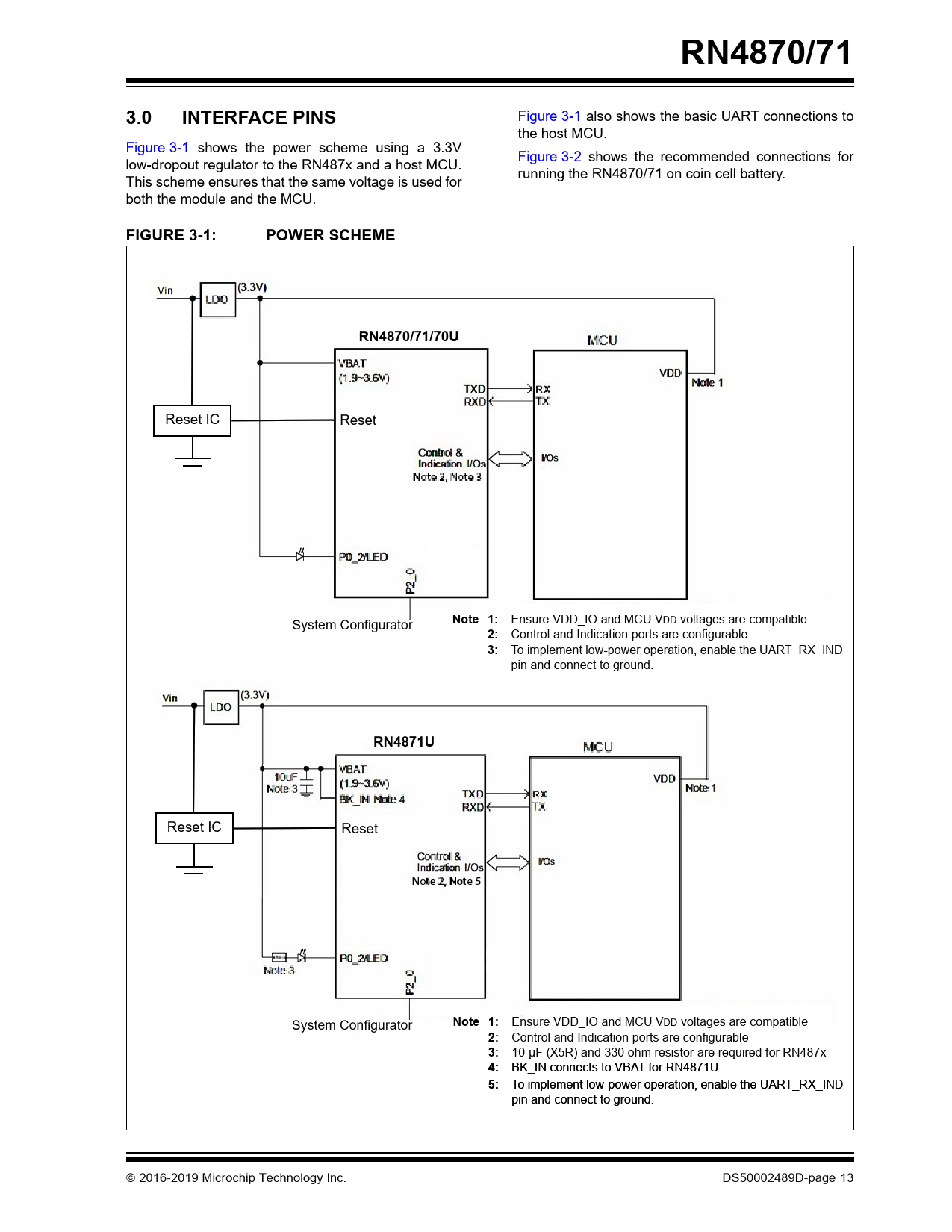

RN4870/71 3.0 INTERFACE PINS
Figure 3-1 also shows the basic UART connections to the host MCU. Figure 3-1 shows the power scheme using a 3.3V low-dropout regulator to the RN487x and a host MCU. Figure 3-2 shows the recommended connections for running the RN4870/71 on coin cell battery. This scheme ensures that the same voltage is used for both the module and the MCU.

Ensure Ensur VDD_IO and D M _IO and CU V U DD v oltage ol s tage ar a e co e c mpati m b pati le or

To T i mple mpl me m nt l nt ow-p - ower ow o er pera o t pera ion, o enab n, l enab e t he U he ART AR _ T RX_IN _I D pin an pi d connect to g n an r d connect to g ound. oun

10 µF ( 10 µF X5R ( ) and 33 ) 0 ohm and 33 res 0 ohm i res stor o are ar requi r re equi d for re d for RN487x N

BK_IN c BK_IN onnec c t onnec s to VBA s T to VBA for T for RN4871U N

To T i mple mpl ment me l nt ow-pow - er pow o er pera o ti pera on, on enabl , e enabl th e e th U e ART R _R T X_IND X_IN pin and pi c n and onnect to gr o o nnect to gr und. und  2016-2019 Microchip Technology Inc. DS50002489D-page 13 Document Outline Bluetooth® Low Energy Module 1.0 Device Overview 1.1 Overview TABLE 1-1: RN4870/71 Family TABLE 1-2: PIN Description FIGURE 1-1: PIN Diagram - RN4870U FIGURE 1-2: PIN Diagram - RN4870 FIGURE 1-3: PIN Diagram - RN4871U FIGURE 1-4: PIN Diagram - RN4871 1.2 Module Configuration TABLE 1-3: Configurable pins and default functions in the RN4870 and RN4871 TABLE 1-4: Configurable functions and descriptions TABLE 1-5: Status Indication PINs TABLE 1-6: Test points on the bottom side FIGURE 1-5: Block Diagram of the RN4870/71 2.0 Specifications TABLE 2-1: General Specifications TABLE 2-2: Electrical characteristics TABLE 2-3: Current consumption TABLE 2-4: Current consumption during application mode 3.0 Interface PINs FIGURE 3-1: Power Scheme FIGURE 3-2: RN4870/71 Coin cell power scheme 4.0 Physical Dimensions And Attributes 4.1 RN4870 Module FIGURE 4-1: RN4870 module dimensions FIGURE 4-2: RN4870 Recommended PCB footprint FIGURE 4-3: Recommended mounting details 4.2 RN4870U Module FIGURE 4-4: RN4870U module dimensions FIGURE 4-5: RN4870U recommended PCB footprint FIGURE 4-6: RN4870U Recommended PCB mounting 4.3 RN4871 Module FIGURE 4-7: RN4871 module dimensions FIGURE 4-8: RN4871 recommended PCB footprint FIGURE 4-9: RN4871 Recommended PCB mounting suggestion 4.4 RN4871U Module FIGURE 4-10: RN4871U module dimensions FIGURE 4-11: RN4871U recommended PCB footprint FIGURE 4-12: RN4871U Recommended PCB mounting FIGURE 4-13: Recommendations for the placement of the module on the Host PCB board 4.5 Soldering Recommendations 5.0 Application Reference Circuits 5.1 External Configuration and Programming 5.2 Reference Circuit FIGURE 5-1: External programming header configurations FIGURE 5-2: RN4870 reference circuit FIGURE 5-3: RN4870U reference circuit FIGURE 5-4: RN4871 Reference circuit FIGURE 5-5: RN4871U reference circuit 5.3 Power Drop Protection FIGURE 5-6: Power Drop protection circuit 6.0 ASCII Command API 7.0 Supported Services 8.0 Antenna Characteristics FIGURE 8-1: RN4870 Antenna performance FIGURE 8-2: RN4871 Antenna performance 9.0 Timing Characteristics FIGURE 9-1: Timing diagram of RN4870/71 UART ready after reset (in test and application mode) FIGURE 9-2: Timing diagram of RN4870/71 UART when powered on (in test and application mode) TABLE 9-1: Error rate for various baud rates on the RN4870/71 10.0 Regulatory Approval 10.1 United States 10.1.1 Labeling and User Information Requirements 10.1.2 RF Exposure 10.1.3 HELPFUL WEB SITES 10.2 Canada 10.2.1 Labeling and User Information Requirements 10.2.2 RF Exposure 10.2.3 Helpful Web Sites 10.3 Europe 10.3.1 LABELING AND USER INFORMATION REQUIREMENTS 10.3.2 CONFORMITY ASSESSMENT 10.3.3 Helpful web sites 10.4 Japan 10.4.1 LABELING AND USER INFORMATION REQUIREMENTS 10.4.2 HELPFUL WEB SITES 10.5 Korea 10.5.1 LABELING AND USER INFORMATION REQUIREMENTS 10.5.2 HELPFUL WEB SITES 10.6 Taiwan 10.6.1 LABELING AND USER INFORMATION REQUIREMENTS 10.6.2 HELPFUL WEB SITES 10.7 China 10.7.1 LABELING AND USER INFORMATION REQUIREMENTS 10.8 Other Regulatory Jurisdictions 10.9 Other Regulatory Information 11.0 Ordering Information TABLE 11-1: Ordering information Appendix A: Revision History The Microchip WebSite Customer Change Notification Service Customer Support AMERICAS Corporate Office Atlanta Austin, TX Boston Chicago Dallas Detroit Houston, TX Indianapolis Los Angeles Raleigh, NC New York, NY San Jose, CA Canada - Toronto ASIA/PACIFIC Australia - Sydney China - Beijing China - Chengdu China - Chongqing China - Dongguan China - Guangzhou China - Hangzhou China - Hong Kong SAR China - Nanjing China - Qingdao China - Shanghai China - Shenyang China - Shenzhen China - Suzhou China - Wuhan China - Xian China - Xiamen China - Zhuhai ASIA/PACIFIC India - Bangalore India - New Delhi India - Pune Japan - Osaka Japan - Tokyo Korea - Daegu Korea - Seoul Malaysia - Kuala Lumpur Malaysia - Penang Philippines - Manila Singapore Taiwan - Hsin Chu Taiwan - Kaohsiung Taiwan - Taipei Thailand - Bangkok Vietnam - Ho Chi Minh EUROPE Austria - Wels Denmark - Copenhagen Finland - Espoo France - Paris Germany - Garching Germany - Haan Germany - Heilbronn Germany - Karlsruhe Germany - Munich Germany - Rosenheim Israel - Ra’anana Italy - Milan Italy - Padova Netherlands - Drunen Norway - Trondheim Poland - Warsaw Romania - Bucharest Spain - Madrid Sweden - Gothenberg Sweden - Stockholm UK - Wokingham Worldwide Sales and Service Trademarks Worldwide Sales and Service
