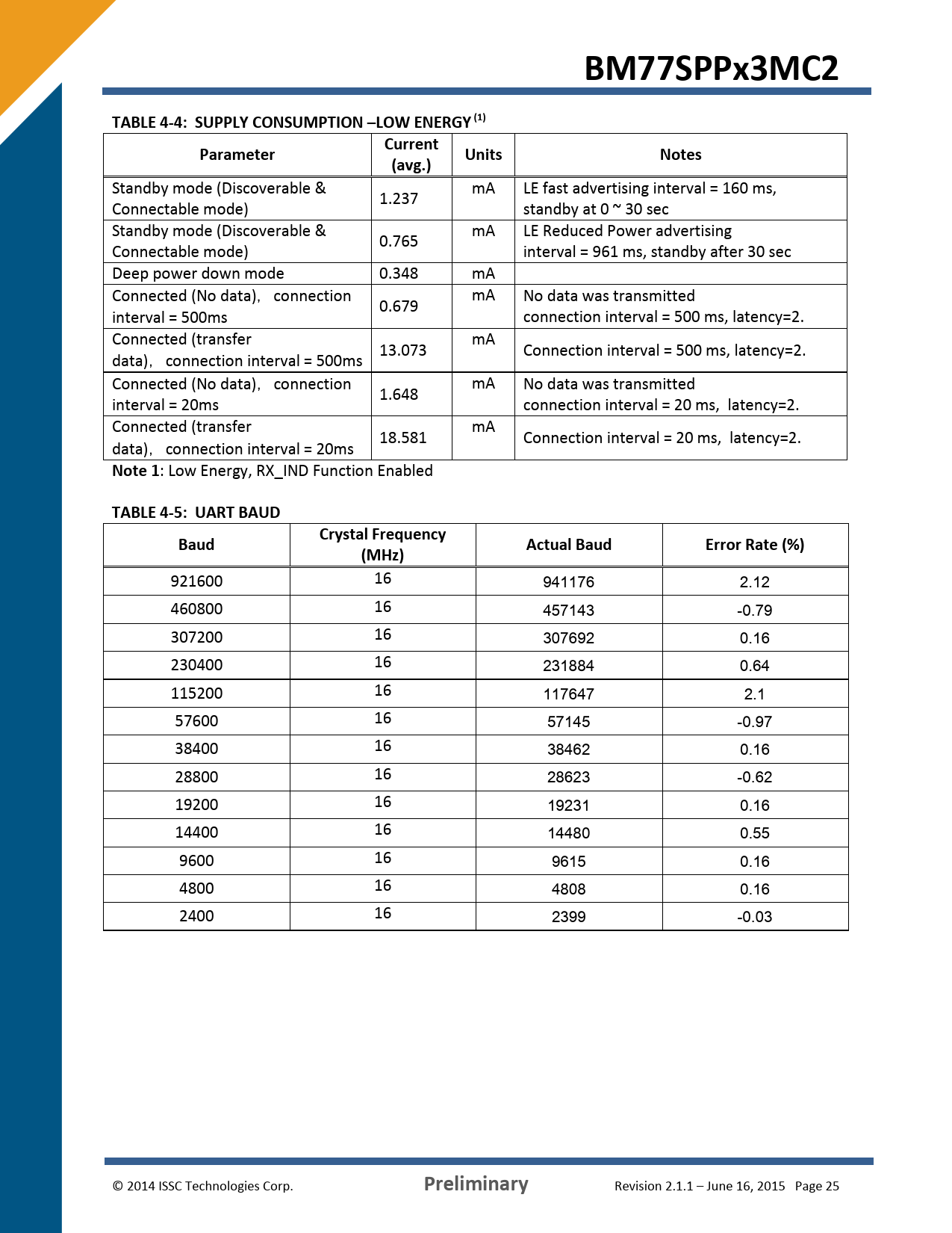

BM77SPPx3MC2. TABLE 4-4: SUPPLY CONSUMPTION –LOW ENERGY (1). Current. Units. Parameter. (avg.). Standby mode (Discoverable &. 1.237
BM77SPPx3MC2 TABLE 4-4: SUPPLY CONSUMPTION –LOW ENERGY (1) Current Units Parameter (avg.) Standby mode (Discoverable & 1.237
BM77SPPx3MC2
Current
Units
Parameter
(avg.)
mA
1.237
Connectable mode)
mA
0.765
Connectable mode)
Deep power down mode
0.348
mA
mA
Connected (No data),connection
0.679
interval = 500ms
Connected (transfer
mA
13.073
data),connection interval = 500ms
mA
1.648
interval = 20ms
Connected (transfer
mA
18.581
data),connection interval = 20ms
Note 1: Low Energy, RX_IND Function Enabled
TABLE 4-5: UART BAUD Notes
LE fast advertising interval = 160 ms,
standby at 0 ~ 30 sec
LE Reduced Power advertising
interval = 961 ms, standby after 30 sec
No data was transmitted
connection interval = 500 ms, latency=2.
Connection interval = 500 ms, latency=2.
connection interval = 20 ms, latency=2.
Connection interval = 20 ms, latency=2. 921600 Crystal Frequency
(MHz)
16 460800 16 457143 -0.79 307200 16 307692 0.16 230400 16 231884 0.64 115200 16 117647 2.1 57600 16 57145 -0.97 38400 16 38462 0.16 28800 16 28623 -0.62 19200 16 19231 0.16 14400 16 14480 0.55 9600 16 9615 0.16 4800 16 4808 0.16 2400 16 2399 -0.03 Baud © 2014 ISSC Technologies Corp. Actual Baud Error Rate (%) 941176 2.12 Preliminary Revision 2.1.1 – June 16, 2015 Page 25
