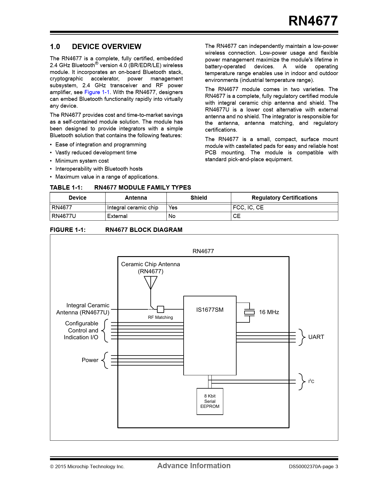

RN4677 1.0 DEVICE OVERVIEW
The RN4677 can independently maintain a low-power wireless connection. Low-power usage and flexible The RN4677 is a complete, fully certified, embedded power management maximize the module's lifetime in 2.4 GHz Bluetooth® version 4.0 (BR/EDR/LE) wireless battery-operated devices. A wide operating module. It incorporates an on-board Bluetooth stack, temperature range enables use in indoor and outdoor cryptographic accelerator, power management environments (industrial temperature range). subsystem, 2.4 GHz transceiver and RF power The RN4677 module comes in two varieties. The amplifier, see Figure 1-1. With the RN4677, designers can embed Bluetooth functionality rapidly into virtually RN4677 is a complete, fully regulatory certified module with integral ceramic chip antenna and shield. The any device. RN4677U is a lower cost alternative with external The RN4677 provides cost and time-to-market savings antenna and no shield. The integrator is responsible for as a self-contained module solution. The module has the antenna, antenna matching, and regulatory been designed to provide integrators with a simple certifications. Bluetooth solution that contains the following features: The RN4677 is a small, compact, surface mount • Ease of integration and programming module with castellated pads for easy and reliable host • Vastly reduced development time PCB mounting. The module is compatible with • Minimum system cost standard pick-and-place equipment. • Interoperability with Bluetooth hosts • Maximum value in a range of applications.
TABLE 1-1: RN4677 MODULE FAMILY TYPES Device Antenna Shield Regulatory Certifications
RN4677 Integral ceramic chip Yes FCC, IC, CE RN4677U External No CE
FIGURE 1-1: RN4677 BLOCK DIAGRAM
RN4677 Ceramic Chip Antenna (RN4677) Integral Ceramic Antenna (RN4677U) IS1677SM 16 MHz RF Matching Configurable Control and Indication I/O UART Power I2C 8 Kbit Serial EEPROM  2015 Microchip Technology Inc.
