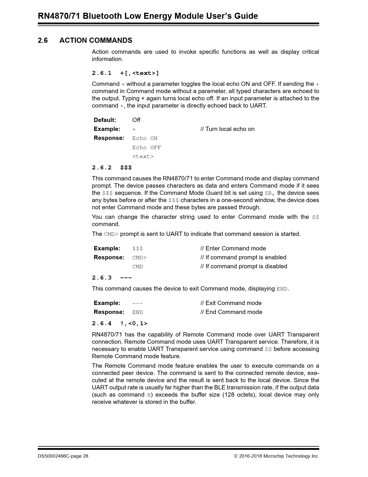

Action commands are used to invoke specific functions as well as display critical information.
2.6.1 +[,<text>]
Command + without a parameter toggles the local echo ON and OFF. If sending the + command in Command mode without a parameter, all typed characters are echoed to the output. Typing + again turns local echo off. If an input parameter is attached to the command +, the input parameter is directly echoed back to UART.
Default:
Off
Example:
+ // Turn local echo on
Response:
Echo ON Echo OFF <text>
2.6.2 $$$
This command causes the RN4870/71 to enter Command mode and display command prompt. The device passes characters as data and enters Command mode if it sees the $$$ sequence. If the Command Mode Guard bit is set using SR, the device sees any bytes before or after the $$$ characters in a one-second window, the device does not enter Command mode and these bytes are passed through. You can change the character string used to enter Command mode with the S$ command. The CMD> prompt is sent to UART to indicate that command session is started.
Example:
$$$ // Enter Command mode
Response:
CMD> // If command prompt is enabled CMD // If command prompt is disabled
2.6.3 ---
This command causes the device to exit Command mode, displaying END.
Example:
--- // Exit Command mode
Response:
END // End Command mode
