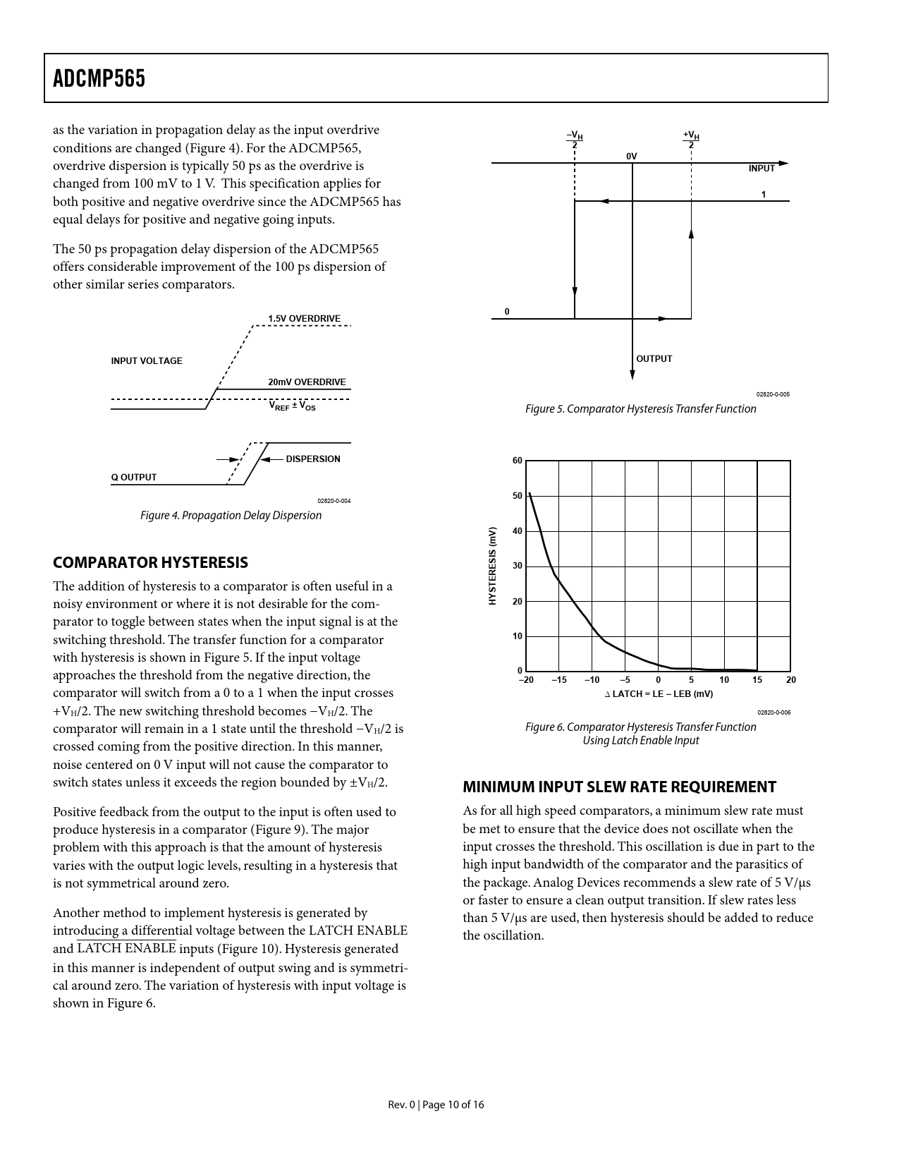

link to page 10 link to page 10 link to page 11 link to page 11 link to page 10 ADCMP565 as the variation in propagation delay as the input overdrive
–VH +VH
conditions are changed (Figure 4). For the ADCMP565,
2 2 0V
overdrive dispersion is typically 50 ps as the overdrive is
INPUT
changed from 100 mV to 1 V. This specification applies for
1
both positive and negative overdrive since the ADCMP565 has equal delays for positive and negative going inputs. The 50 ps propagation delay dispersion of the ADCMP565 offers considerable improvement of the 100 ps dispersion of other similar series comparators.
0 1.5V OVERDRIVE INPUT VOLTAGE OUTPUT 20mV OVERDRIVE
02820-0-005
VREF ± VOS
Figure 5. Comparator Hysteresis Transfer Function
DISPERSION 60 Q OUTPUT 50
02820-0-004 Figure 4. Propagation Delay Dispersion
V) 40 m COMPARATOR HYSTERESIS ESIS ( 30
The addition of hysteresis to a comparator is often useful in a
YSTER
noisy environment or where it is not desirable for the com-
H 20
parator to toggle between states when the input signal is at the switching threshold. The transfer function for a comparator
10
with hysteresis is shown in Figure 5. If the input voltage approaches the threshold from the negative direction, the
0–20 –15 –10 –5 0 5 10 15 20
comparator will switch from a 0 to a 1 when the input crosses ∆
LATCH = LE – LEB (mV)
+VH/2. The new switching threshold becomes −VH/2. The 02820-0-006 comparator will remain in a 1 state until the threshold −VH/2 is Figure 6. Comparator Hysteresis Transfer Function crossed coming from the positive direction. In this manner, Using Latch Enable Input noise centered on 0 V input will not cause the comparator to switch states unless it exceeds the region bounded by ±VH/2.
