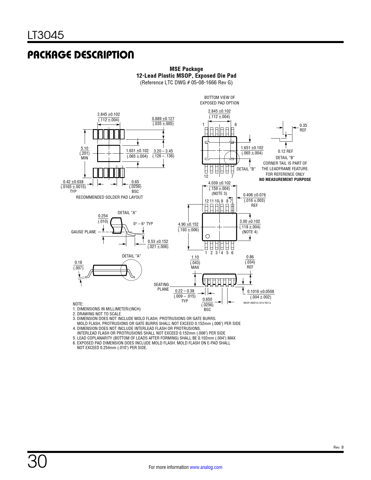

PACKAGE DESCRIPTION. MSE Package. 12-Lead Plastic MSOP, Exposed Die Pad. NO MEASUREMENT PURPOSE
PACKAGE DESCRIPTION MSE Package 12-Lead Plastic MSOP, Exposed Die Pad NO MEASUREMENT PURPOSE
LT3045
(Reference LTC DWG # 05-08-1666 Rev G) BOTTOM VIEW OF EXPOSED PAD OPTION 2.845 ±0.102 2.845 ±0.102 (.112 ±.004) (.112 ±.004) 0.889 ±0.127 (.035 ±.005) 1 6 0.35 REF 5.10 1.651 ±0.102 1.651 ±0.102 (.201) 3.20 – 3.45 (.065 ±.004) 0.12 REF (.065 ±.004) MIN (.126 – .136) DETAIL “B” CORNER TAIL IS PART OF DETAIL “B” THE LEADFRAME FEATURE. 12 7 FOR REFERENCE ONLY
0.42 ±0.038 0.65 4.039 ±0.102 (.0165 ±.0015) (.0256) (.159 ±.004) TYP BSC (NOTE 3) RECOMMENDED SOLDER PAD LAYOUT 0.406 ±0.076 12 11 10 9 8 7 (.016 ±.003) REF DETAIL “A” 0.254 (.010) 0° – 6° TYP 3.00 ±0.102 4.90 ±0.152 (.118 ±.004) GAUGE PLANE (.193 ±.006) (NOTE 4) 0.53 ±0.152 (.021 ±.006) 1 2 3 4 5 6 DETAIL “A” 1.10 0.86 0.18 (.043) (.034) (.007) MAX REF SEATING PLANE 0.22 – 0.38 0.1016 ±0.0508 (.009 – .015) (.004 ±.002) TYP 0.650 MSOP (MSE12) 0213 REV G NOTE: (.0256) 1. DIMENSIONS IN MILLIMETER/(INCH) BSC 2. DRAWING NOT TO SCALE 3. DIMENSION DOES NOT INCLUDE MOLD FLASH, PROTRUSIONS OR GATE BURRS. MOLD FLASH, PROTRUSIONS OR GATE BURRS SHALL NOT EXCEED 0.152mm (.006") PER SIDE 4. DIMENSION DOES NOT INCLUDE INTERLEAD FLASH OR PROTRUSIONS. INTERLEAD FLASH OR PROTRUSIONS SHALL NOT EXCEED 0.152mm (.006") PER SIDE 5. LEAD COPLANARITY (BOTTOM OF LEADS AFTER FORMING) SHALL BE 0.102mm (.004") MAX 6. EXPOSED PAD DIMENSION DOES INCLUDE MOLD FLASH. MOLD FLASH ON E-PAD SHALL NOT EXCEED 0.254mm (.010") PER SIDE. Rev. B 30 For more information www.analog.com Document Outline Features Applications Typical Application Description Absolute Maximum Ratings Pin Configuration Order Information Electrical Characteristics Typical Performance Characteristics Pin Functions Block Diagram Applications Information Typical Applications Package Description Revision History Typical Application Related Parts
