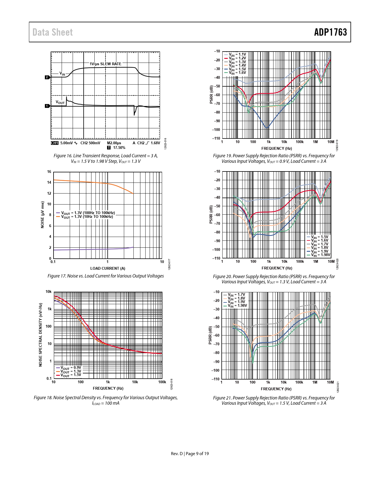

Data Sheet. ADP1763. –10. VIN = 1.1V. –20. VIN = 1.2V. 1V/µs SLEW RATE. IN = 1.3V. VIN = 1.4V. –30. VIN = 1.5V. IN = 1.6V. –40. –50. B) (d –60. OUT
Data Sheet ADP1763 –10 VIN = 1.1V –20 VIN = 1.2V 1V/µs SLEW RATE IN = 1.3V VIN = 1.4V –30 VIN = 1.5V IN = 1.6V –40 –50 B) (d –60 OUT
Data Sheet ADP1763 –10 VIN = 1.1V –20 VIN = 1.2V V 1V/µs SLEW RATE IN = 1.3V VIN = 1.4V –30 VIN = 1.5V V V IN IN = 1.6V 2 –40 –50 B) (d –60 RR V S OUT P –70 1 –80 –90 –100

1292 Figure 16. Line Transient Response, Load Current = 3 A, Figure 19. Power Supply Rejection Ratio (PSRR) vs. Frequency for VIN = 1.5 V to 1.98 V Step, VOUT = 1.3 V Various Input Voltages, VOUT = 0.9 V, Load Current = 3 A
16 –10 –20 14 –30 12 –40 s) 10 rm –50 B) V (d (µ V 8 OUT = 1.3V (100Hz TO 100kHz) –60 E VOUT = 1.3V (10Hz TO 100kHz) RR IS S O P –70 6 N –80 4 VIN = 1.5V –90 VIN = 1.6V VIN = 1.7V 2 –100 VIN = 1.8V VIN = 1.9V VIN = 1.98V 0

12 12 Figure 17. Noise vs. Load Current for Various Output Voltages Figure 20. Power Supply Rejection Ratio (PSRR) vs. Frequency for Various Input Voltages, VOUT = 1.3 V, Load Current = 3 A
10k –10 VIN = 1.7V V –20 IN = 1.8V ) VIN = 1.9V VIN = 1.98V 1k /√Hz –30 V (n Y –40 IT 100 NS –50 B) DE (d L –60 A RR R S T 10 P –70 EC SP –80 ISE 1 O –90 N VOUT = 0.9V V –100 OUT = 1.3V VOUT = 1.5V 0.1

1292 Figure 18. Noise Spectral Density vs. Frequency for Various Output Voltages, Figure 21. Power Supply Rejection Ratio (PSRR) vs. Frequency for ILOAD = 100 mA Various Input Voltages, VOUT = 1.5 V, Load Current = 3 A Rev. D | Page 9 of 19 Document Outline Features Applications General Description Typical Application Circuits Revision History Specifications Input and Output Capacitor: Recommended Specifications Absolute Maximum Ratings Thermal Data Thermal Resistance/Parameter ESD Caution Pin Configuration and Function Descriptions Typical Performance Characteristics Theory of Operation Soft Start Function Adjustable Output Voltage Enable Feature Power-Good (PG) Feature Applications Information Capacitor Selection Output Capacitor Input Bypass Capacitor Input and Output Capacitor Properties Undervoltage Lockout Current-Limit and Thermal Overload Protection Paralleling ADP1763 for High Current Applications Thermal Considerations PCB Layout Considerations Outline Dimensions Ordering Guide
