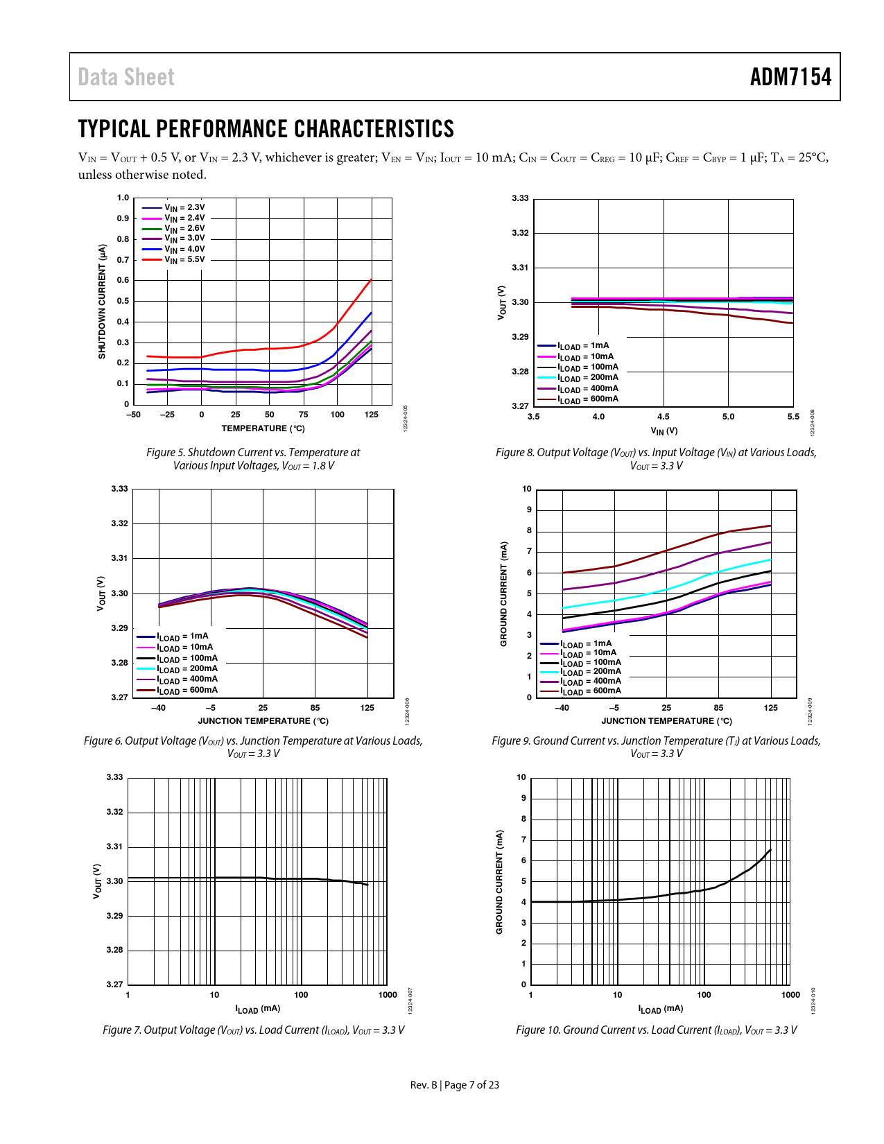

Data Sheet. ADM7154. TYPICAL PERFORMANCE CHARACTERISTICS. 1.0. 3.33. VIN = 2.3V. 0.9. VIN = 2.4V VIN = 2.6V. 3.32. 0.8. VIN = 3.0V
Data Sheet ADM7154 TYPICAL PERFORMANCE CHARACTERISTICS
VIN = VOUT + 0.5 V, or VIN = 2.3 V, whichever is greater; VEN = VIN; IOUT = 10 mA; CIN = COUT = CREG = 10 µF; CREF = CBYP = 1 µF; TA = 25°C, unless otherwise noted.
1.0 3.33 VIN = 2.3V 0.9 VIN = 2.4V VIN = 2.6V 3.32 0.8 VIN = 3.0V A) VIN = 4.0V µ ( 0.7 VIN = 5.5V 3.31 NT 0.6 (V) 0.5 3.30 UT N CURRE O W 0.4 V DO 3.29 0.3 I HUT LOAD = 1mA S ILOAD = 10mA 0.2 I 3.28 LOAD = 100mA I 0.1 LOAD = 200mA ILOAD = 400mA I 0 LOAD = 600mA 3.27 –50 –25 0 25 50 75 100 125

12324- Figure 5. Shutdown Current vs. Temperature at Figure 8. Output Voltage (VOUT) vs. Input Voltage (VIN) at Various Loads, Various Input Voltages, VOUT = 1.8 V VOUT = 3.3 V
3.33 10 9 3.32 8 7 3.31 mA) ( NT 6 (V) 3.30 5 UT OV 4 3.29 UND CURRE I 3 LOAD = 1mA RO I G ILOAD = 1mA LOAD = 10mA I I 2 LOAD = 10mA 3.28 LOAD = 100mA I I LOAD = 100mA LOAD = 200mA ILOAD = 200mA I 1 LOAD = 400mA ILOAD = 400mA ILOAD = 600mA ILOAD = 600mA 3.27 0 –40 –5 25 85 125

12324- Figure 6. Output Voltage (VOUT) vs. Junction Temperature at Various Loads, Figure 9. Ground Current vs. Junction Temperature (TJ) at Various Loads, VOUT = 3.3 V VOUT = 3.3 V
3.33 10 9 3.32 8 7 3.31 mA) ( NT 6 (V) 3.30 5 UT OV 4 3.29 UND CURRE RO 3 G 2 3.28 1 3.27 0 1 10 100 1000
