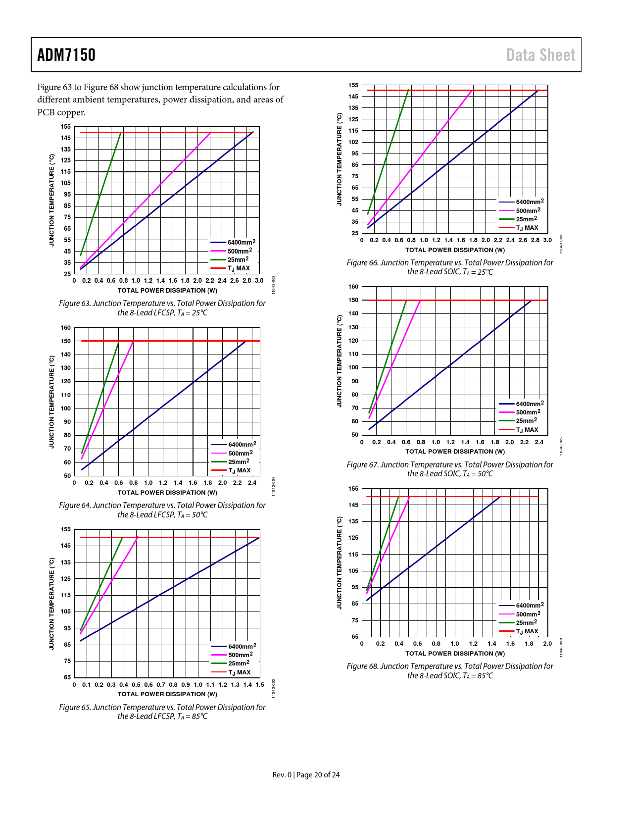

Figure 63 to Figure 68 show junction temperature calculations for
155
different ambient temperatures, power dissipation, and areas of
145
PCB copper.

Figure 66. Junction Temperature vs. Total Power Dissipation for
TJ MAX 25
the 8-Lead SOIC, TA = 25°C 063
0 0.2 0.4 0.6 0.8 1.0 1.2 1.4 1.6 1.8 2.0 2.2 2.4 2.6 2.8 3.0 160 TOTAL POWER DISSIPATION (W)
1043- 1 Figure 63. Junction Temperature vs. Total Power Dissipation for
150
the 8-Lead LFCSP, TA = 25°C

Figure 67. Junction Temperature vs. Total Power Dissipation for
TJ MAX 50
the 8-Lead SOIC, TA = 50°C 064

11043- Figure 64. Junction Temperature vs. Total Power Dissipation for
145
the 8-Lead LFCSP, TA = 50°C

Figure 68. Junction Temperature vs. Total Power Dissipation for
TJ MAX 65
the 8-Lead SOIC, TA = 85°C

1043- 1 Figure 65. Junction Temperature vs. Total Power Dissipation for the 8-Lead LFCSP, TA = 85°C Rev. 0 | Page 20 of 24 Document Outline Features Applications General Description Typical Application Circuit Table of Contents Revision History Specifications Input and Output Capacitor Recommended Specifications Absolute Maximum Ratings Thermal Data Thermal Resistance ESD Caution Pin Configurations and Function Descriptions Typical Performance Characteristics Theory of Operation Applications Information Capacitor Selection Output Capacitor Input and VREG Capacitor REF Capacitor BYP Capacitor Capacitor Properties Enable (EN) and Undervoltage Lockout (UVLO) Start-Up Time REF, BYP, and, VREG pins Current-Limit and Thermal Overload Protection Thermal Considerations Thermal Characterization Parameter (ΨJB) Printed Circuit Board Layout Considerations Outline Dimensions Ordering Guide
