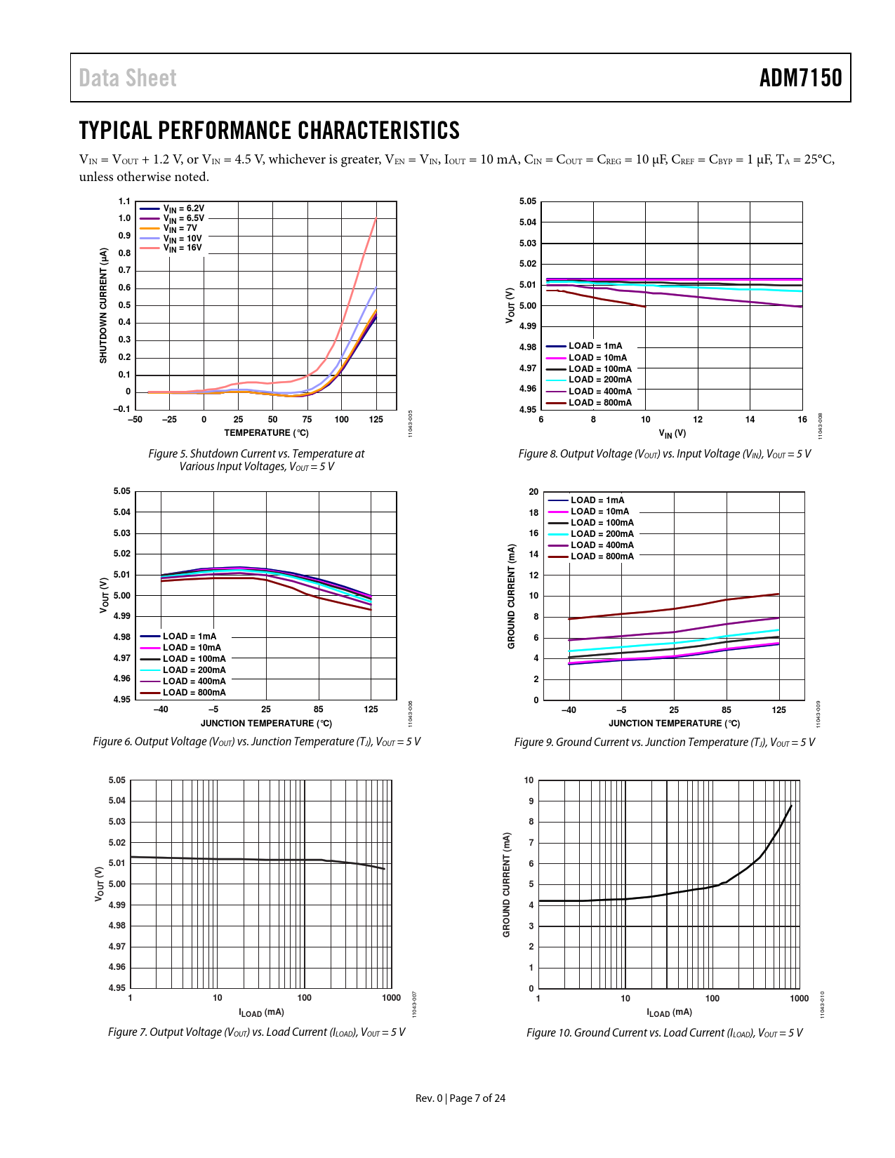

Data Sheet. ADM7150. TYPICAL PERFORMANCE CHARACTERISTICS. 1.1. 5.05. VIN = 6.2V. 1.0. VIN = 6.5V. 5.04. VIN = 7V. 0.9. VIN = 10V. 5.03. 0.8
Data Sheet ADM7150 TYPICAL PERFORMANCE CHARACTERISTICS
VIN = VOUT + 1.2 V, or VIN = 4.5 V, whichever is greater, VEN = VIN, IOUT = 10 mA, CIN = COUT = CREG = 10 µF, CREF = CBYP = 1 µF, TA = 25°C, unless otherwise noted.
1.1 5.05 VIN = 6.2V 1.0 VIN = 6.5V 5.04 VIN = 7V 0.9 VIN = 10V 5.03 V A) 0.8 IN = 16V µ ( 5.02 0.7 NT 0.6 5.01 (V) 0.5 5.00 UT N CURRE O W 0.4 V 4.99 DO 0.3 4.98 LOAD = 1mA HUT S 0.2 LOAD = 10mA 4.97 LOAD = 100mA 0.1 LOAD = 200mA 0 4.96 LOAD = 400mA LOAD = 800mA –0.1 4.95 –50 –25 0 25 50 75 100 125

1043- 1 Figure 5. Shutdown Current vs. Temperature at Figure 8. Output Voltage (VOUT) vs. Input Voltage (VIN), VOUT = 5 V Various Input Voltages, VOUT = 5 V
5.05 20 LOAD = 1mA 5.04 18 LOAD = 10mA LOAD = 100mA 5.03 16 LOAD = 200mA LOAD = 400mA 5.02 mA) 14 LOAD = 800mA ( 5.01 NT 12 (V) 5.00 UT 10 OV 4.99 8 UND CURRE 4.98 LOAD = 1mA RO 6 LOAD = 10mA G 4.97 LOAD = 100mA 4 LOAD = 200mA 4.96 LOAD = 400mA 2 LOAD = 800mA 4.95 0 –40 –5 25 85 125

1043- 1 Figure 6. Output Voltage (VOUT) vs. Junction Temperature (TJ), VOUT = 5 V Figure 9. Ground Current vs. Junction Temperature (TJ), VOUT = 5 V
5.05 10 5.04 9 5.03 8 5.02 mA) 7 ( 5.01 NT 6 (V) 5.00 UT 5 OV 4.99 4 UND CURRE 4.98 RO 3 G 4.97 2 4.96 1 4.95 0 1 10 100 1000

1
LOAD (mA)
