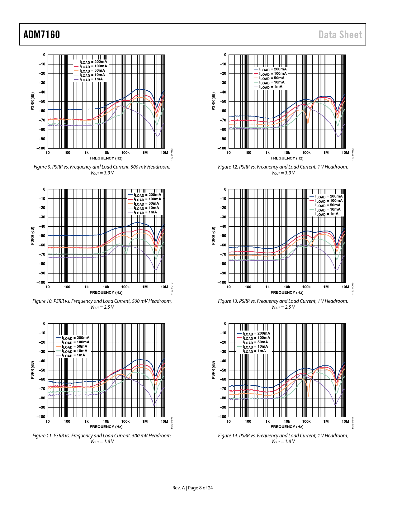

ADM7160. Data Sheet. –10. LOAD = 200mA. ILOAD = 100mA. LOAD = 50mA. –20. LOAD = 10mA. LOAD = 100mA. LOAD = 1mA. –30. ILOAD = 10mA. ILOAD = 1mA
ADM7160 Data Sheet 0 0 I –10 LOAD = 200mA –10 ILOAD = 100mA I I LOAD = 50mA LOAD = 200mA –20 I –20 I LOAD = 10mA LOAD = 100mA I I LOAD = 1mA LOAD = 50mA –30 –30 ILOAD = 10mA ILOAD = 1mA –40 –40 B) B) d d –50 –50 RR ( RR ( S S P –60 P –60 –70 –70 –80 –80 –90 –90 –100 –100 10 100 1k 10k 100k 1M 10M

1334- 1 1 Figure 9. PSRR vs. Frequency and Load Current, 500 mV Headroom, Figure 12. PSRR vs. Frequency and Load Current, 1 V Headroom, VOUT = 3.3 V VOUT = 3.3 V

1334- 1 1 Figure 10. PSRR vs. Frequency and Load Current, 500 mV Headroom, Figure 13. PSRR vs. Frequency and Load Current, 1 V Headroom, VOUT = 2.5 V VOUT = 2.5 V

1334- 1 1 Figure 11. PSRR vs. Frequency and Load Current, 500 mV Headroom, Figure 14. PSRR vs. Frequency and Load Current, 1 V Headroom, VOUT = 1.8 V VOUT = 1.8 V Rev. A | Page 8 of 24 Document Outline Features Applications Application Circuit General Description Table of Contents Revision History Specifications Input and Output Capacitors, Recommended Specifications Absolute Maximum Ratings Thermal Data Thermal Resistance ESD Caution Pin Configurations and Function Descriptions Typical Performance Characteristics Theory of Operation Enable Feature Soft Start Current-Limit and Thermal Overload Protection Applications Information Capacitor Selection Output Capacitor Input Bypass Capacitor Input and Output Capacitor Properties Thermal Considerations PCB Layout Considerations Typical Application Circuits Outline Dimensions Ordering Guide
