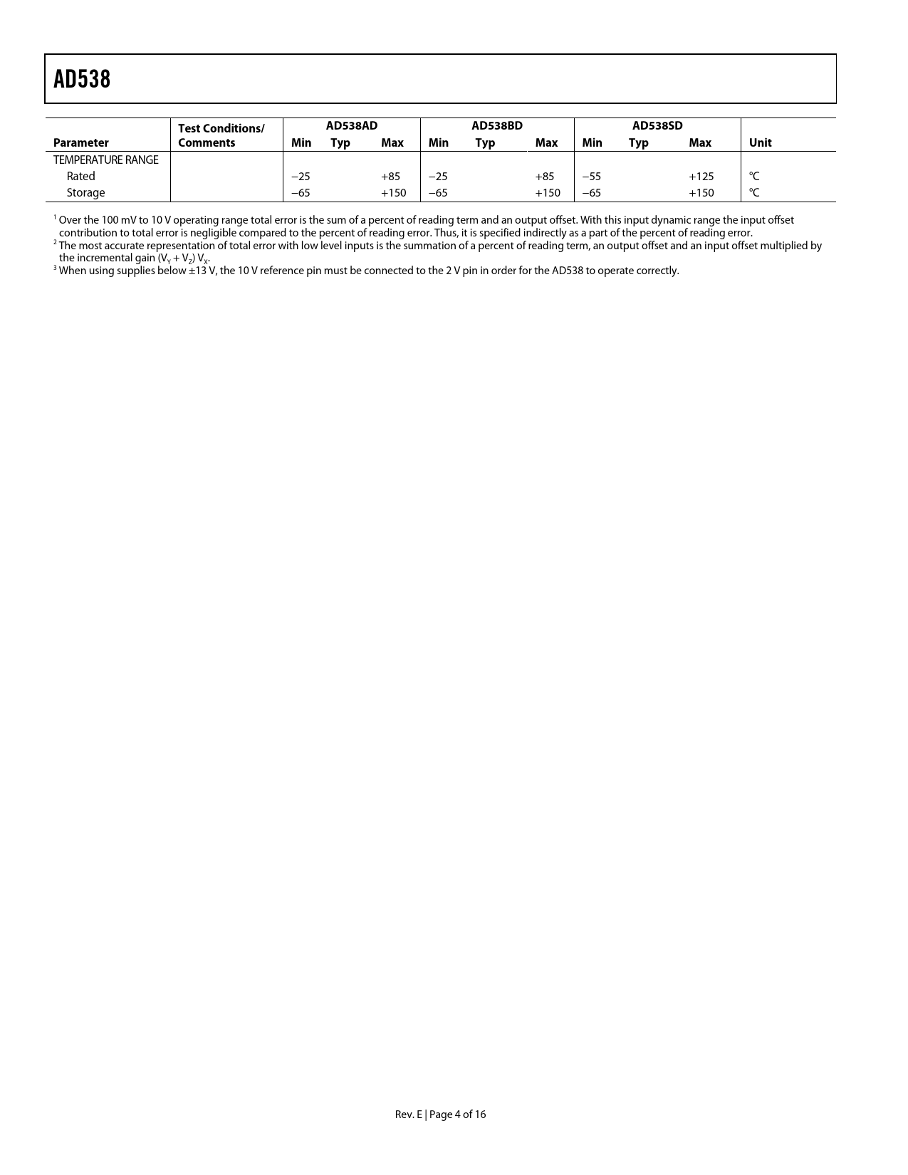

AD538. Test Conditions/. AD538AD. AD538BD. AD538SD. Parameter. Comments. Min. Typ. Max. Unit
AD538 Test Conditions/ AD538AD AD538BD AD538SD Parameter Comments Min Typ Max Unit
AD538 Test Conditions/ AD538AD AD538BD AD538SD Parameter Comments Min Typ Max Min Typ Max Min Typ Max Unit
TEMPERATURE RANGE Rated −25 +85 −25 +85 −55 +125 °C Storage −65 +150 −65 +150 −65 +150 °C 1 Over the 100 mV to 10 V operating range total error is the sum of a percent of reading term and an output offset. With this input dynamic range the input offset contribution to total error is negligible compared to the percent of reading error. Thus, it is specified indirectly as a part of the percent of reading error. 2 The most accurate representation of total error with low level inputs is the summation of a percent of reading term, an output offset and an input offset multiplied by the incremental gain (VY + VZ) VX. 3 When using supplies below ±13 V, the 10 V reference pin must be connected to the 2 V pin in order for the AD538 to operate correctly. Rev. E | Page 4 of 16 Document Outline Features Applications Functional Block Diagram General Description Revision History Specifications Absolute Maximum Ratings ESD Caution Pin Configuration and Function Descriptions Typical Performance Characteristics Theory of Operation Re-Examination of Multiplier/Divider Accuracy Functional Description Stability Precautions Using The Voltage References One-Quadrant Multiplication/Division Two-Quadrant Division Log Ratio Operation Analog Computation Of Powers And Roots Square Root Operation Applications Information Transducer Linearization ARC-Tangent Approximation Outline Dimensions Ordering Guide
