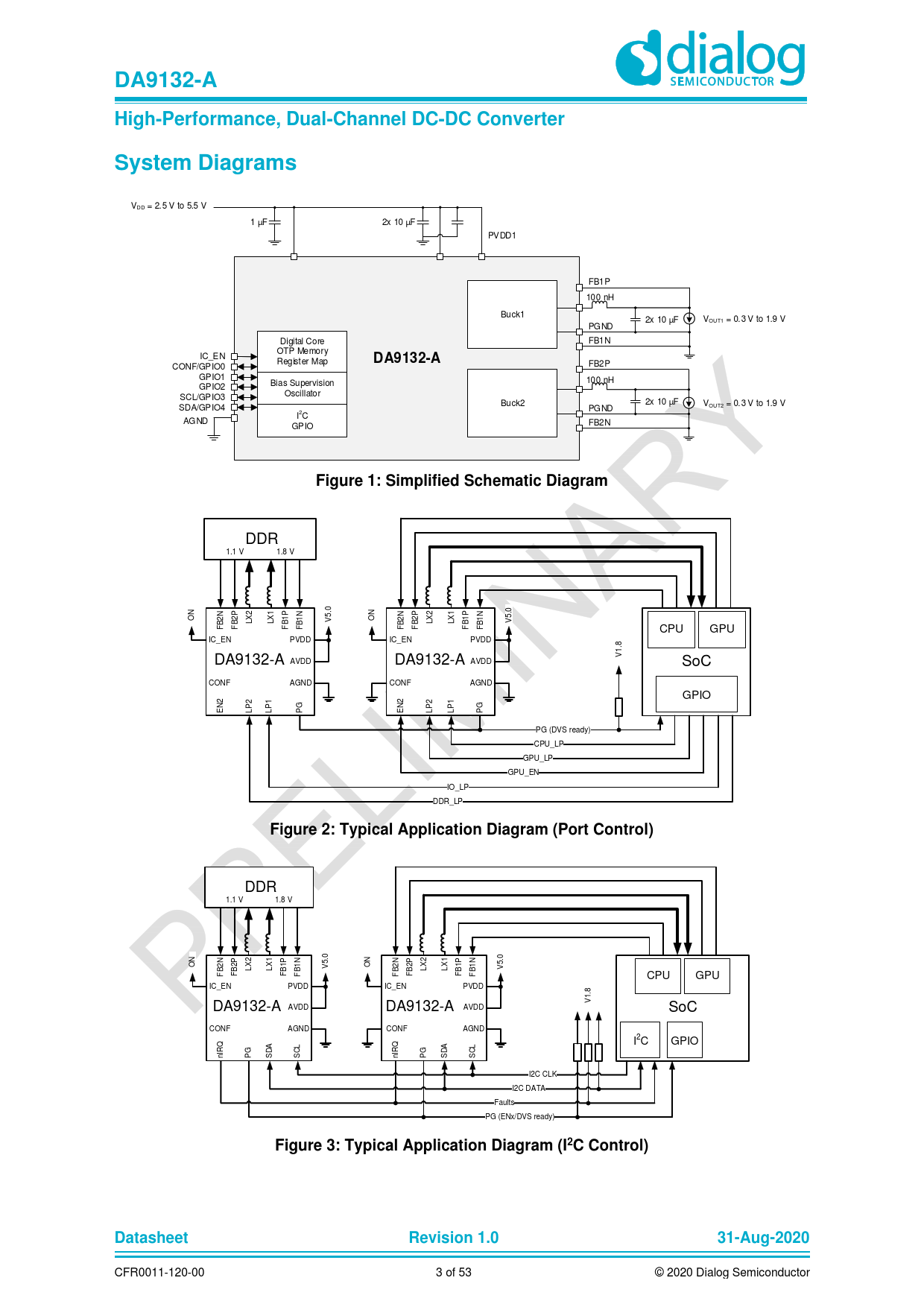

DA9132-A. High-Performance, Dual-Channel DC-DC Converter. System Diagrams. Figure 1: Simplified Schematic Diagram
DA9132-A High-Performance, Dual-Channel DC-DC Converter System Diagrams
VDD = 2.5 V to 5.5 V 1 µF 2x 10 µF PVDD1 FB1P 100 nH Buck1 2x 10 µF VOUT1 = 0.3 V to 1.9 V PGND Digital Core FB1N OTP Memory IC_EN Register Map
DA9132-A
CONF/GPIO0 FB2P GPIO1 100 nH Bias Supervision GPIO2 SCL/GPIO3 Oscillator Buck2 2x 10 µF V SDA/GPIO4 PGND OUT2 = 0. 3 V to 1.9 V I2C AG ND FB2N GPIO
DDR 1.1 V 1.8 V 0. 0 N P 2 1 P N 5 N P 2 1 P N . ON 2 2 X X 1 1 V ON 2 2 X X 1 1 5 B B L L B B B B L L B B V F F F F F F F F CPU GPU IC_EN PVDD IC_EN PVDD 8.1 DA9132-A V AVDD DA9132-A AVDD SoC CONF AGND CONF AGND GPIO 2 2 1 2 2 1 N P P N P P E L L PG E L L PG PG (DVS ready) CPU_LP GPU_LP GPU_EN IO_LP DDR_LP
Figure 2: Typical Application Diagram (Port Control)
DDR 1.1 V 1.8 V 0. 0 N P 2 1 P N 5 N P 2 1 P N . ON 2 2 X X 1 1 V ON 2 2 X X 1 1 5 B B L L B B B B L L B B V F F F F F F F F CPU GPU IC_EN PVDD IC_EN PVDD 8.1 DA9132-A AVDD DA9132-A V AVDD SoC CONF AGND CONF AGND Q Q I2C GPIO A L A L RI D C RI D C n PG S S n PG S S I2C CLK I2C DATA Faults PG (ENx/DVS ready)
Figure 3: Typical Application Diagram (I2C Control) Datasheet Revision 1.0 31-Aug-2020
