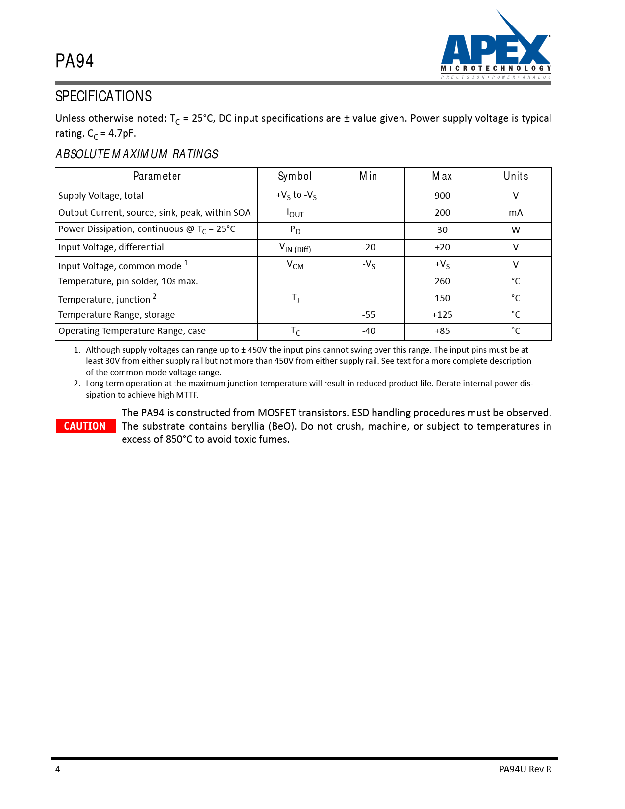

PA94. SPECIFICATIONS. ABSOLUTE MAXIMUM RATINGS. Parameter. Symbol. Min. Max Units. CAUTION
PA94 SPECIFICATIONS ABSOLUTE MAXIMUM RATINGS Parameter Symbol Min Max Units CAUTION
PA94 SPECIFICATIONS
Unless otherwise noted: TC = 25°C, DC input specifications are ± value given. Power supply voltage is typical rating. CC = 4.7pF.
Supply Voltage, total +VS to ‐VS 900 V Output Current, source, sink, peak, within SOA IOUT 200 mA Power Dissipation, continuous @ TC = 25°C PD 30 W Input Voltage, differential VIN (Diff) ‐20 +20 V Input Voltage, common mode 1 VCM ‐VS +VS V Temperature, pin solder, 10s max. 260 °C Temperature, junction 2 TJ 150 °C Temperature Range, storage ‐55 +125 °C Operating Temperature Range, case TC ‐40 +85 °C 1. Although supply voltages can range up to ± 450V the input pins cannot swing over this range. The input pins must be at least 30V from either supply rail but not more than 450V from either supply rail. See text for a more complete description of the common mode voltage range. 2. Long term operation at the maximum junction temperature will result in reduced product life. Derate internal power dis‐ sipation to achieve high MTTF. The PA94 is constructed from MOSFET transistors. ESD handling procedures must be observed.
CAUTION
The substrate contains beryllia (BeO). Do not crush, machine, or subject to temperatures in excess of 850°C to avoid toxic fumes. 4 PA94U Rev R Document Outline PA94 Features Applications Description Figure 1: Equivalent Schematic Typical connection Figure 2: Typical Connection Pinout and Description Table Figure 3: External Connections Specifications Absolute Maximum Ratings Input Gain Output Power Supply Thermal Typical Performance Graphs Safe Operating Area (SOA) Figure 12: SOA General Typical Application Figure 13: Typical Application Phase Compensation Internal Power Dissipation And Heatsink Selection Current Limit Common Mode Input Range Input Protection Figure 14: Overvoltage Protection Power Supply Protection Stability External Components Cautions Package Options Package Style DQ
