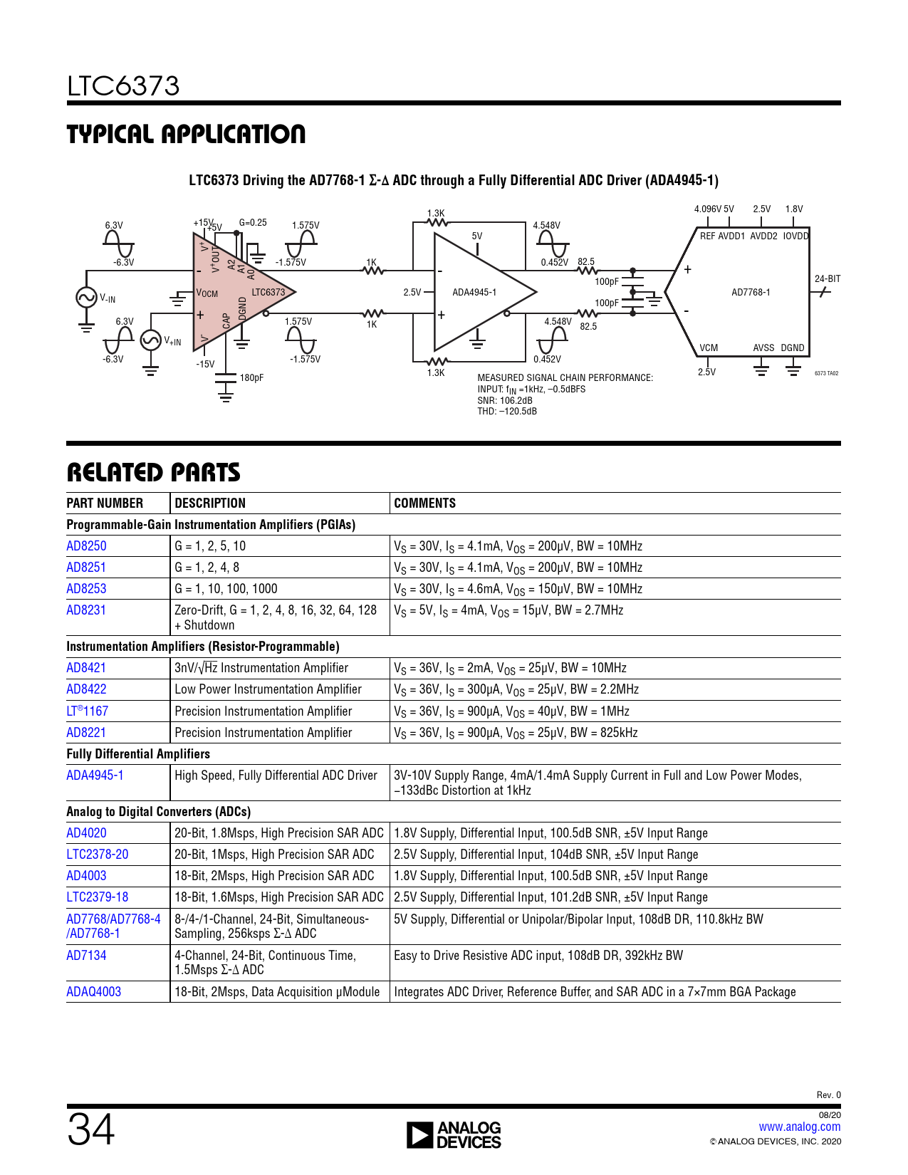

TYPICAL APPLICATION. LTC6373 Driving the AD7768-1 ∑-Δ ADC through a Fully Differential ADC Driver (ADA4945-1)
TYPICAL APPLICATION LTC6373 Driving the AD7768-1 ∑-Δ ADC through a Fully Differential ADC Driver (ADA4945-1)
LTC6373
1.3K 4.096V 5V 2.5V 1.8V +15V 6.3V G=0.25 1.575V 4.548V +5V 5V REF AVDD1 AVDD2 IOVDD + V -6.3V + OUT -1.575V 1K 0.452V 82.5 - V A2 A1 A0 - + 100pF 24-BIT VOCM LTC6373 2.5V ADA4945-1 V AD7768-1 -IN 100pF + - DGND + 6.3V 1.575V CAP 1K 4.548V 82.5 - V V +IN VCM AVSS DGND -6.3V -1.575V -15V 0.452V 180pF 1.3K 2.5V 6373 TA02 MEASURED SIGNAL CHAIN PERFORMANCE: INPUT: fIN =1kHz, –0.5dBFS SNR: 106.2dB THD: –120.5dB
