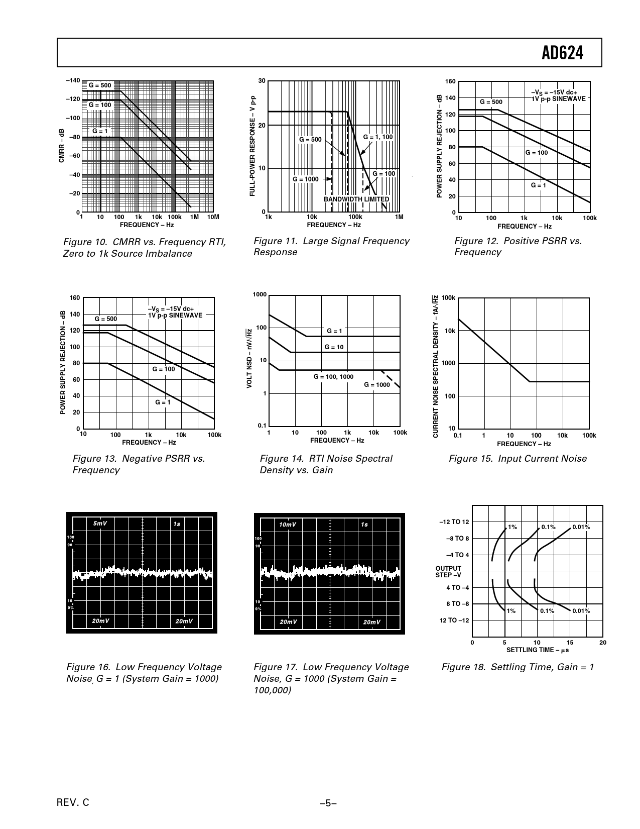

AD624. –140. 160. G = 500. –VS = –15V dc+. –120. 140. 1V p-p SINEWAVE. G = 100. V p-p –. 120. –100. G = 1. 100. –80. G = 1, 100. –60. CMRR. –40. G = 1000. –20
AD624 –140 160 G = 500 –VS = –15V dc+ –120 140 1V p-p SINEWAVE G = 100 V p-p – 120 –100 G = 1 100 –80 G = 1, 100 –60 CMRR –40 G = 1000 –20
AD624 –140 30 160 G = 500 –VS = –15V dc+ –120 140 1V p-p SINEWAVE G = 100 dB G = 500 V p-p – 120 –100 20 G = 1 100 dB –80 G = 1, 100 G = 500 80 G = 100 –60 CMRR 60 10 –40 G = 100
G = 1000 40 G = 1 –20 FULL-POWER RESPONSE POWER SUPPLY REJECTION 20 BANDWIDTH LIMITED 0 0 0 1 10 100 1k 10k 100k 1M 10M 1k 10k 100k 1M 10 100 1k 10k 100k FREQUENCY – Hz FREQUENCY – Hz FREQUENCY – Hz
Figure 10. CMRR vs. Frequency RTI, Figure 11. Large Signal Frequency Figure 12. Positive PSRR vs. Zero to 1k Source Imbalance Response Frequency
1000 160 100k Hz –VS = –15V dc+ 140 1V p-p SINEWAVE fA/ dB G = 500 100 120 Hz G = 1 10k 100 nV/ G = 10 10 80 1000 G = 100 G = 100, 1000 60 VOLT NSD G = 1000 40 1 100 G = 1 POWER SUPPLY REJECTION 20 0.1 0 10 10 100 1k 10k 100k 1 10 100 1k 10k 100k CURRENT NOISE SPECTRAL DENSITY 0.1 1 10 100 10k 100k FREQUENCY – Hz FREQUENCY – Hz FREQUENCY – Hz
Figure 13. Negative PSRR vs. Figure 14. RTI Noise Spectral Figure 15. Input Current Noise Frequency Density vs. Gain
–12 TO 12 1% 0.1% 0.01% –8 TO 8 –4 TO 4 OUTPUT STEP –V 4 TO –4 8 TO –8 1% 0.1% 0.01% 12 TO –12 0 5 10 15 20 SETTLING TIME –
s
