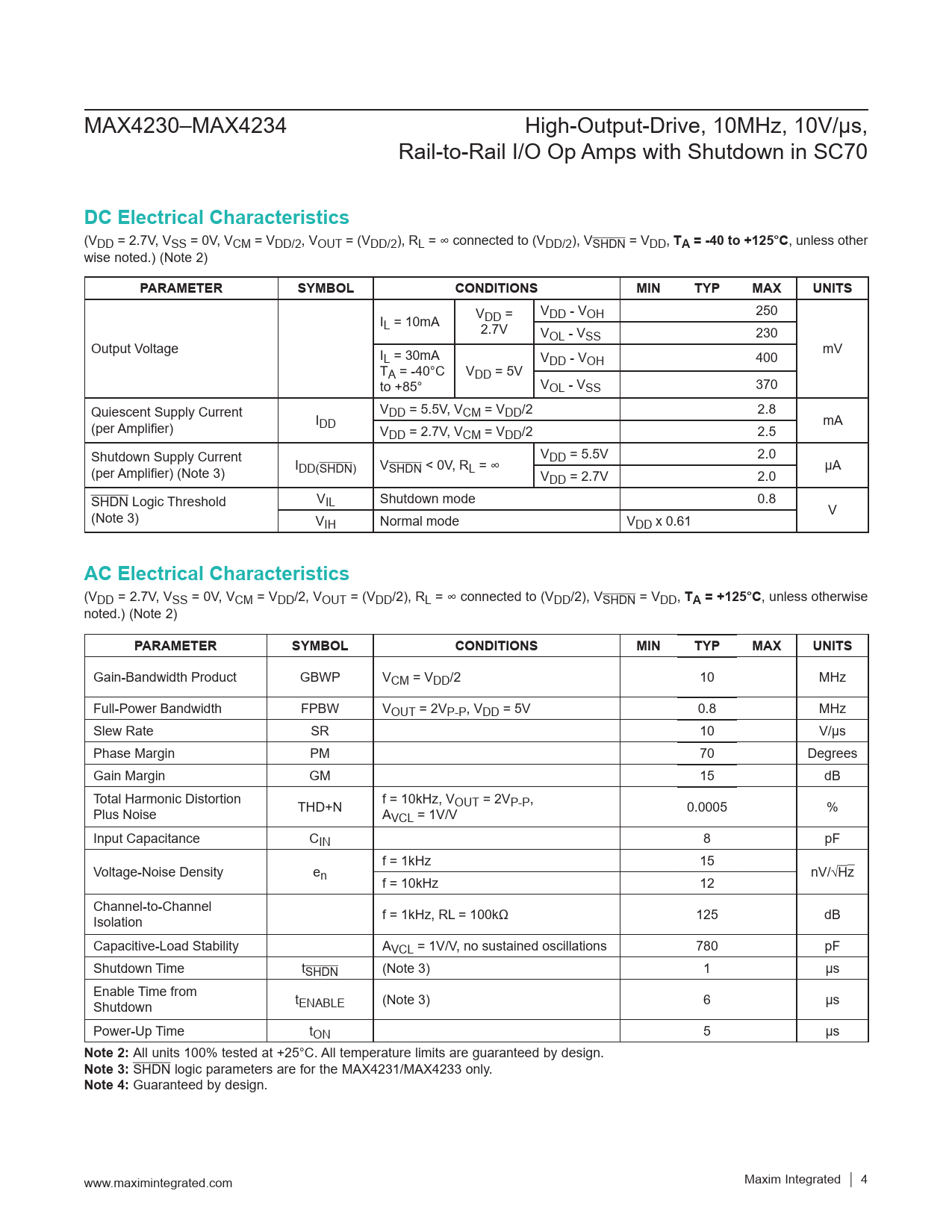

DC Electrical Characteristics. TA = -40 to +125°C. PARAMETER. SYMBOL. CONDITIONS. MIN. TYP. MAX. UNITS. AC Electrical Characteristics
MAX4230–MAX4234 High-Output-Drive, 10MHz, 10V/μs, Rail-to-Rail I/O Op Amps with Shutdown in SC70
(VDD = 2.7V, VSS = 0V, VCM = VDD/2, VOUT = (VDD/2), RL = ∞ connected to (VDD/2), VSHDN = VDD,
TA = -40 to +125°C
, unless other wise noted.) (Note 2)
PARAMETER SYMBOL CONDITIONS MIN TYP MAX UNITS
V I DD - VOH 250 L = 10mA VDD = 2.7V VOL - VSS 230 Output Voltage mV IL = 30mA VDD - VOH 400 TA = -40°C VDD = 5V to +85° VOL - VSS 370 Quiescent Supply Current VDD = 5.5V, VCM = VDD/2 2.8 (per Amplifier) IDD mA VDD = 2.7V, VCM = VDD/2 2.5 Shutdown Supply Current VDD = 5.5V 2.0 (per Amplifier) (Note 3) IDD(SHDN) VSHDN < 0V, RL = ∞ µA VDD = 2.7V 2.0 SHDN Logic Threshold VIL Shutdown mode 0.8 (Note 3) V VIH Normal mode VDD x 0.61
TA = +125°C
, unless otherwise noted.) (Note 2)
Gain-Bandwidth Product GBWP VCM = VDD/2 10 MHz Full-Power Bandwidth FPBW VOUT = 2VP-P, VDD = 5V 0.8 MHz Slew Rate SR 10 V/μs Phase Margin PM 70 Degrees Gain Margin GM 15 dB Total Harmonic Distortion Plus Noise THD+N f = 10kHz, VOUT = 2VP-P, AVCL = 1V/V 0.0005 % Input Capacitance CIN 8 pF f = 1kHz 15 Voltage-Noise Density en nV/√Hz f = 10kHz 12 Channel-to-Channel Isolation f = 1kHz, RL = 100kΩ 125 dB Capacitive-Load Stability AVCL = 1V/V, no sustained oscillations 780 pF Shutdown Time tSHDN (Note 3) 1 µs Enable Time from Shutdown tENABLE (Note 3) 6 µs Power-Up Time tON 5 µs
Note 2:
All units 100% tested at +25°C. All temperature limits are guaranteed by design.
Note 3:
SHDN logic parameters are for the MAX4231/MAX4233 only.
Note 4:
Guaranteed by design. www.maximintegrated.com Maxim Integrated │ 4
