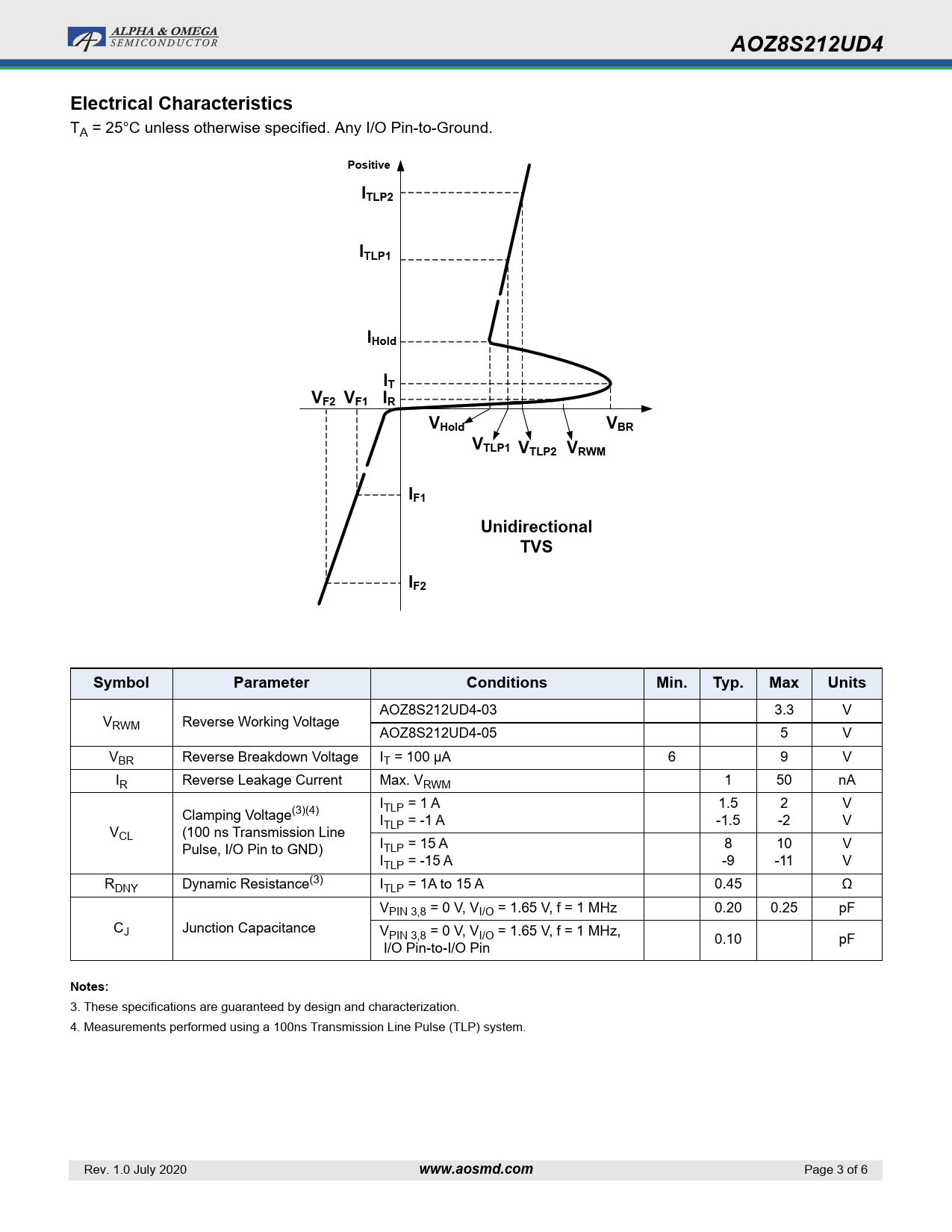

Description4-Channel Ultra-Low Capacitance TVS Diode Array
Pages / Page6 / 3 — AOZ8S212UD4. Electrical Characteristics. Positive. ITLP2. ITLP1. IHold. …
File Format / SizePDF / 532 Kb
AOZ8S212UD4. Electrical Characteristics. Positive. ITLP2. ITLP1. IHold. VF2 VF1 IR. VHold. VBR. VTLP1 VTLP2 VRWM. IF1. Unidirectional. TVS. IF2
AOZ8S212UD4 Electrical Characteristics Positive ITLP2 ITLP1 IHold VF2 VF1 IR VHold VBR VTLP1 VTLP2 VRWM IF1 Unidirectional TVS IF2
TA = 25°C unless otherwise specified. Any I/O Pin-to-Ground.
Positive ITLP2 ITLP1 IHold IT VF2 VF1 IR VHold VBR VTLP1 VTLP2 VRWM IF1 Unidirectional TVS IF2 Symbol Parameter Conditions Min. Typ. Max Units
AOZ8S212UD4-03 3.3 V VRWM Reverse Working Voltage AOZ8S212UD4-05 5 V VBR Reverse Breakdown Voltage IT = 100 µA 6 9 V IR Reverse Leakage Current Max. VRWM 1 50 nA I 1.5 2 V Clamping Voltage(3)(4) TLP = 1 A I -1.5 -2 V V TLP = -1 A CL (100 ns Transmission Line Pulse, I/O Pin to GND) ITLP = 15 A 8 10 V ITLP = -15 A -9 -11 V RDNY Dynamic Resistance(3) ITLP = 1A to 15 A 0.45 Ω VPIN 3,8 = 0 V, VI/O = 1.65 V, f = 1 MHz 0.20 0.25 pF CJ Junction Capacitance VPIN 3,8 = 0 V, VI/O = 1.65 V, f = 1 MHz, 0.10 pF I/O Pin-to-I/O Pin
