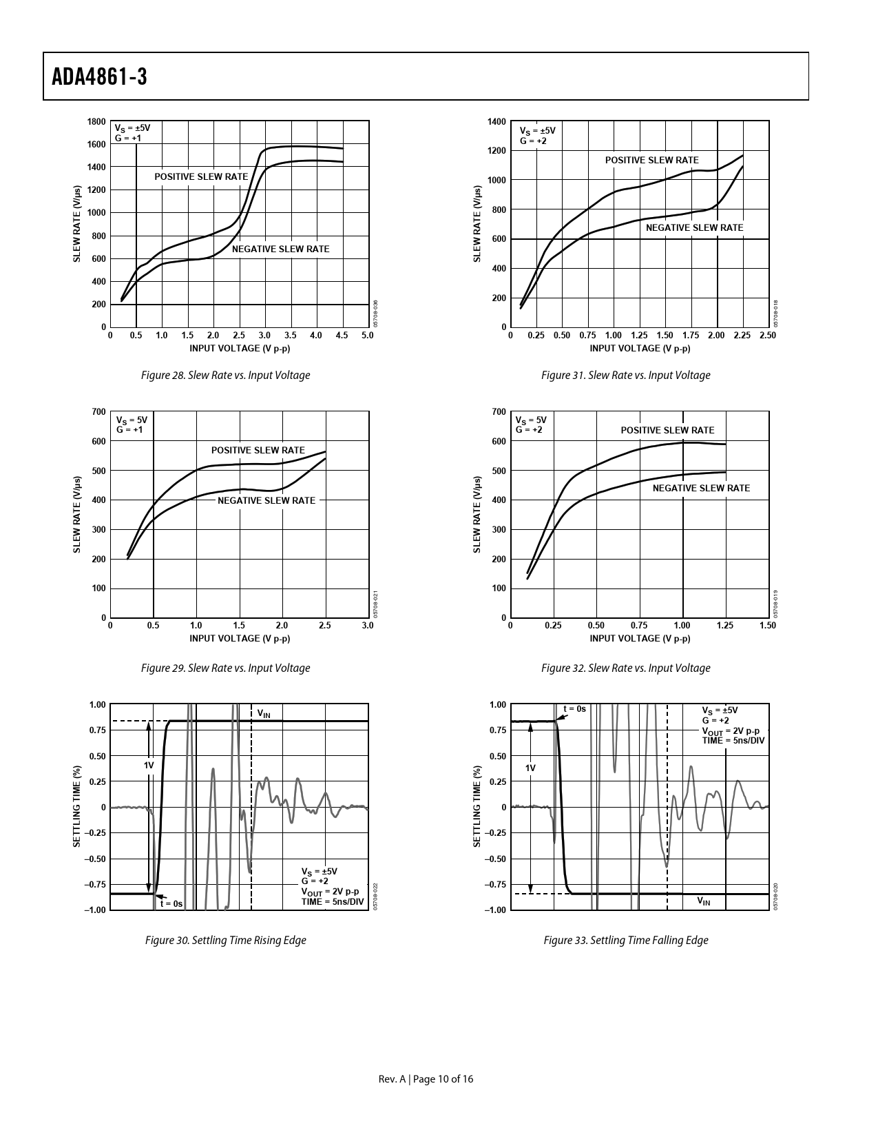

ADA4861-3. 1800. 1400. VS = ±5V. G = +1. S = ±5V. 1600. G = +2. 1200. POSITIVE SLEW RATE. 1000. µs 1200. E (V/ 1000. 800. E (V/. NEGATIVE SLEW RATE
ADA4861-3 1800 1400 VS = ±5V V G = +1 S = ±5V 1600 G = +2 1200 POSITIVE SLEW RATE 1400 POSITIVE SLEW RATE ) 1000 ) µs 1200 µs E (V/ 1000 800 E (V/ T T A A NEGATIVE SLEW RATE R 800 R 600 EW NEGATIVE SLEW RATE EW L L S 600 S 400 400 200 200
036 018 08- 08- 57 57 0
0 0
0
0 0.5 1.0 1.5 2.0 2.5 3.0 3.5 4.0 4.5 5.0 0 0.25 0.50 0.75 1.00 1.25 1.50 1.75 2.00 2.25 2.50 INPUT VOLTAGE (V p-p) INPUT VOLTAGE (V p-p)
Figure 28. Slew Rate vs. Input Voltage Figure 31. Slew Rate vs. Input Voltage
700 700 VS = 5V VS = 5V G = +1 G = +2 POSITIVE SLEW RATE 600 600 POSITIVE SLEW RATE 500 ) 500 ) µs µs NEGATIVE SLEW RATE 400 E (V/ NEGATIVE SLEW RATE 400 E (V/ T T A A R R 300 300 EW EW L L S S 200 200 100 100
021 019 08- 08-
0
57 57 0
0
0
0 0.5 1.0 1.5 2.0 2.5 3.0 0 0.25 0.50 0.75 1.00 1.25 1.50 INPUT VOLTAGE (V p-p) INPUT VOLTAGE (V p-p)
Figure 29. Slew Rate vs. Input Voltage Figure 32. Slew Rate vs. Input Voltage
1.00 1.00 V t = 0s V IN S = ±5V G = +2 0.75 0.75 VOUT = 2V p-p TIME = 5ns/DIV 0.50 0.50 ) 1V ) % 1V % ( 0.25 ( E 0.25 E M M TI TI G 0 G 0 IN IN TL TL T –0.25 T –0.25 E E S S –0.50 –0.50 VS = ±5V –0.75 G = +2 –0.75
22 20 0
VOUT = 2V p-p
0 8- 8-
t = 0s TIME = 5ns/DIV
70
V
70
IN –1.00
05
–1.00
05 Figure 30. Settling Time Rising Edge Figure 33. Settling Time Falling Edge Rev. A | Page 10 of 16 Document Outline FEATURES APPLICATIONS PIN CONFIGURATION GENERAL DESCRIPTION TABLE OF CONTENTS REVISION HISTORY SPECIFICATIONS ABSOLUTE MAXIMUM RATINGS THERMAL RESISTANCE Maximum Power Dissipation ESD CAUTION TYPICAL PERFORMANCE CHARACTERISTICS APPLICATIONS GAIN CONFIGURATIONS 20 MHz ACTIVE LOW-PASS FILTER RGB VIDEO DRIVER DRIVING TWO VIDEO LOADS POWER-DOWN PINS SINGLE-SUPPLY OPERATION POWER SUPPLY BYPASSING LAYOUT OUTLINE DIMENSIONS ORDERING GUIDE
