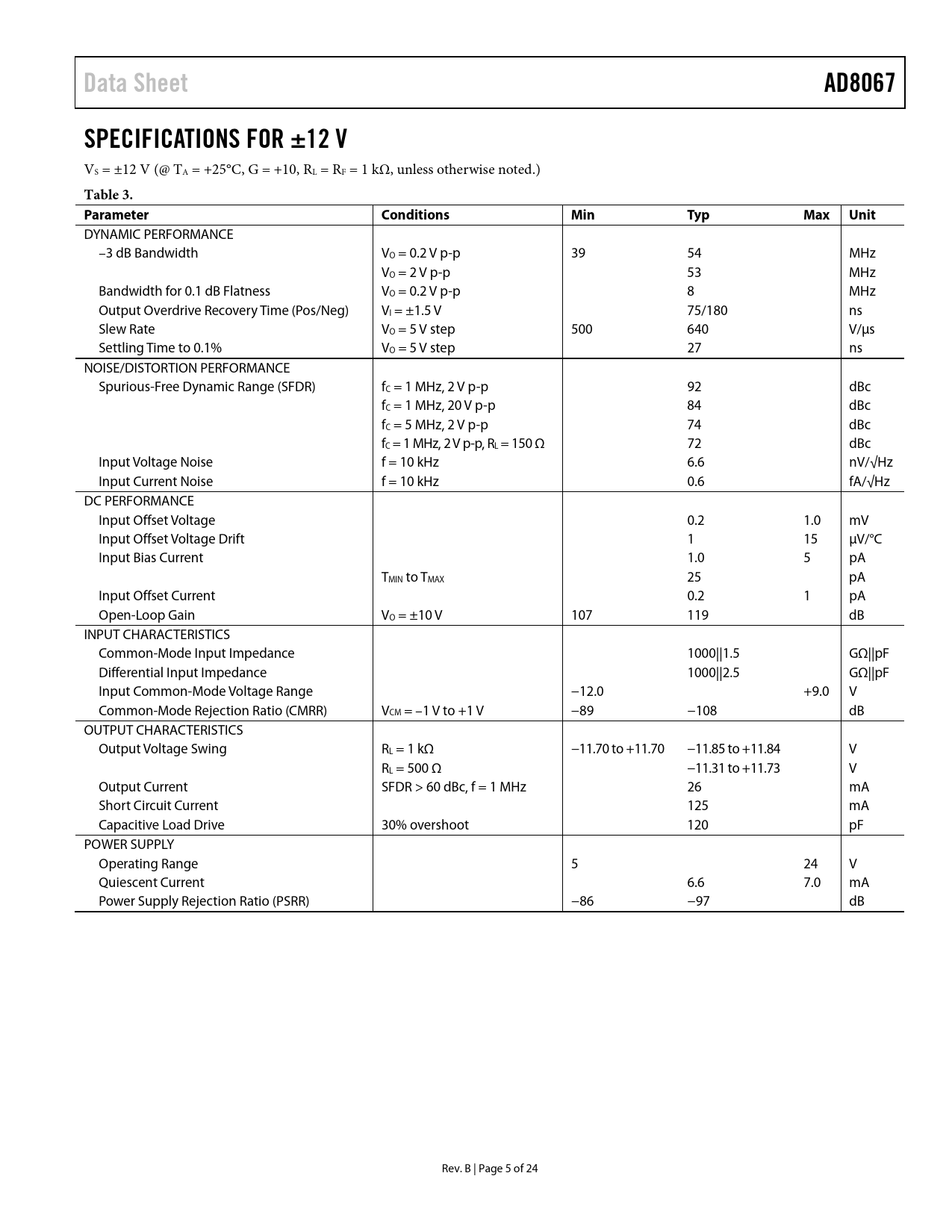

Data Sheet. AD8067. SPECIFICATIONS FOR ±12 V. Table 3. Parameter. Conditions. Min. Typ. Max. Unit
Data Sheet AD8067 SPECIFICATIONS FOR ±12 V Table 3 Parameter Conditions Min Typ Max Unit
VS = ±12 V (@ TA = +25°C, G = +10, RL = RF = 1 kΩ, unless otherwise noted.)
Table 3. Parameter Conditions Min Typ Max Unit
DYNAMIC PERFORMANCE –3 dB Bandwidth VO = 0.2 V p-p 39 54 MHz VO = 2 V p-p 53 MHz Bandwidth for 0.1 dB Flatness VO = 0.2 V p-p 8 MHz Output Overdrive Recovery Time (Pos/Neg) VI = ±1.5 V 75/180 ns Slew Rate VO = 5 V step 500 640 V/µs Settling Time to 0.1% VO = 5 V step 27 ns NOISE/DISTORTION PERFORMANCE Spurious-Free Dynamic Range (SFDR) fC = 1 MHz, 2 V p-p 92 dBc fC = 1 MHz, 20 V p-p 84 dBc fC = 5 MHz, 2 V p-p 74 dBc fC = 1 MHz, 2 V p-p, RL = 150 Ω 72 dBc Input Voltage Noise f = 10 kHz 6.6 nV/√Hz Input Current Noise f = 10 kHz 0.6 fA/√Hz DC PERFORMANCE Input Offset Voltage 0.2 1.0 mV Input Offset Voltage Drift 1 15 µV/°C Input Bias Current 1.0 5 pA TMIN to TMAX 25 pA Input Offset Current 0.2 1 pA Open-Loop Gain VO = ±10 V 107 119 dB INPUT CHARACTERISTICS Common-Mode Input Impedance 1000||1.5 GΩ||pF Differential Input Impedance 1000||2.5 GΩ||pF Input Common-Mode Voltage Range −12.0 +9.0 V Common-Mode Rejection Ratio (CMRR) VCM = –1 V to +1 V −89 −108 dB OUTPUT CHARACTERISTICS Output Voltage Swing RL = 1 kΩ −11.70 to +11.70 −11.85 to +11.84 V RL = 500 Ω −11.31 to +11.73 V Output Current SFDR > 60 dBc, f = 1 MHz 26 mA Short Circuit Current 125 mA Capacitive Load Drive 30% overshoot 120 pF POWER SUPPLY Operating Range 5 24 V Quiescent Current 6.6 7.0 mA Power Supply Rejection Ratio (PSRR) −86 −97 dB Rev. B | Page 5 of 24 Document Outline Features Applications Connection Diagram (Top View) General Description Revision History Specifications for ±5 V Specifications for +5 V Specifications for ±12 V Absolute Maximum Ratings Maximum Power Dissipation ESD Caution Typical Performance Characteristics Test Circuits Theory of Operation Basic Frequency Response Resistor Selection for Wideband Operation DC Error Calculations Input and Output Overload Behavior Input Protection Capacitive Load Drive Layout, Grounding, and Bypassing Considerations Layout Grounding Power Supply Bypassing Applications Wideband Photodiode Preamp Using the AD8067 at Gains of Less Than 8 Single-Supply Operation High Gain, High Bandwidth Composite Amplifier Outline Dimensions Ordering Guide
