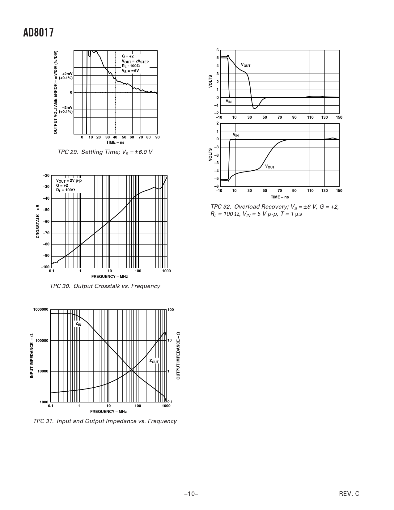

AD8017. G = +2. /DIV). VOUT = 2VSTEP R. L - 100. OUT. VS =. +2mV. mV/DIV (% (+0.1%). VOLTS. VIN. –2mV. (+0.1%). –10. 110. 130. 150. OUTPUT VOLTAGE ERROR
AD8017 G = +2 /DIV) VOUT = 2VSTEP R L - 100 OUT VS = +2mV mV/DIV (% (+0.1%) VOLTS VIN –2mV (+0.1%) –10 110 130 150 OUTPUT VOLTAGE ERROR
AD8017 6 G = +2 /DIV) 5 VOUT = 2VSTEP R V L - 100
4 OUT VS =
ⴞ
6V +2mV 3 mV/DIV (% (+0.1%) – 2 VOLTS 1 0 0 VIN –1 –2mV (+0.1%) –2 –10 10 30 50 70 90 110 130 150 2 OUTPUT VOLTAGE ERROR 1 V 0 10 20 30 40 50 60 70 80 90 IN 0 TIME – ns –3
TPC 29. Settling Time; VS = ±6.0 V
–3 VOLTS –3 VOUT –4 –20 –5 VOUT = 2V p-p –30 G = +2 –6 RL = 100
–10 10 30 50 70 90 110 130 150 –40 TIME – ns
TPC 32. Overload Recovery; V
dB –50
S = ±6 V, G = +2,
RL = 100 Ω, VIN = 5 V p-p, T = 1 µs
–60 –70 CROSSTALK –80 –90 –100 0.1 1 10 100 1000 FREQUENCY – MHz
TPC 30. Output Crosstalk vs. Frequency
1000000 100 ZIN
– – 100000 10 ZOUT 10000 1 INPUT IMPEDANCE OUTPUT IMPEDANCE 1000 0.1 0.1 1 10 100 1000 FREQUENCY – MHz
TPC 31. Input and Output Impedance vs. Frequency –10– REV. C
