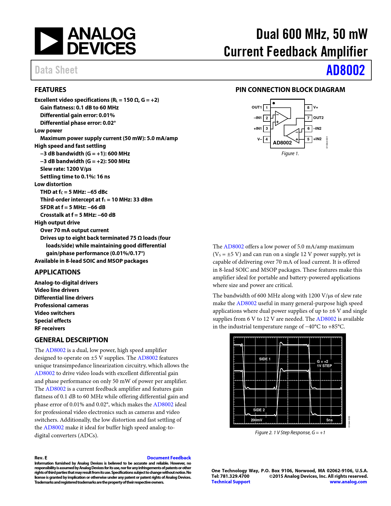

Dual 600 MHz, 50 mW. Current Feedback Amplifier. Data Sheet. AD8002. FEATURES. PIN CONNECTION BLOCK DIAGRAM
Datasheet AD8002 Analog Devices, Revision: E
Dual 600 MHz, 50 mW Current Feedback Amplifier Data Sheet AD8002 FEATURES PIN CONNECTION BLOCK DIAGRAM Excellent video specifications (RL = 150 Ω, G = +2) Gain flatness: 0.1 dB to 60 MHz OUT1 1 8 V+ Differential gain error: 0.01% –IN1 2 7 OUT2 Differential phase error: 0.02° Low power +IN1 3 6 –IN2 Maximum power supply current (50 mW): 5.0 mA/amp V– 4 5 +IN2
001
High speed and fast settling AD8002
01044-
−3 dB bandwidth (G = +1): 600 MHz
Figure 1.
−3 dB bandwidth (G = +2): 500 MHz Slew rate: 1200 V/µs Settling time to 0.1%: 16 ns Low distortion THD at fC = 5 MHz: −65 dBc Third-order intercept at f1 = 10 MHz: 33 dBm SFDR at f = 5 MHz: −66 dB Crosstalk at f = 5 MHz: −60 dB High output drive Over 70 mA output current Drives up to eight back terminated 75 Ω loads (four loads/side) while maintaining good differential
The AD8002 offers a low power of 5.0 mA/amp maximum
gain/phase performance (0.01%/0.17°)
(VS = ±5 V) and can run on a single 12 V power supply, yet is
Available in 8-lead SOIC and MSOP packages
capable of delivering over 70 mA of load current. It is offered
APPLICATIONS
in 8-lead SOIC and MSOP packages. These features make this amplifier ideal for portable and battery-powered applications
Analog-to-digital drivers
where size and power are critical.
Video line drivers Differential line drivers
The bandwidth of 600 MHz along with 1200 V/µs of slew rate
Professional cameras
make the AD8002 useful in many general-purpose high speed
Video switchers
applications where dual power supplies of up to ±6 V and single
Special effects
supplies from 6 V to 12 V are needed. The AD8002 is available
RF receivers
in the industrial temperature range of −40°C to +85°C.
GENERAL DESCRIPTION
The AD8002 is a dual, low power, high speed amplifier designed to operate on ±5 V supplies. The AD8002 features
SIDE 1
unique transimpedance linearization circuitry, which allows the
G = +2 1V STEP
AD8002 to drive video loads with excellent differential gain and phase performance on only 50 mW of power per amplifier. The AD8002 is a current feedback amplifier and features gain flatness of 0.1 dB to 60 MHz while offering differential gain and phase error of 0.01% and 0.02°, which makes the AD8002 ideal for professional video electronics such as cameras and video
SIDE 2
switchers. Additionally, the low distortion and fast settling of 003
200mV 5ns
the AD8002 make it ideal for buffer high speed analog-to- 01044- digital converters (ADCs). Figure 2. 1 V Step Response, G = +1
