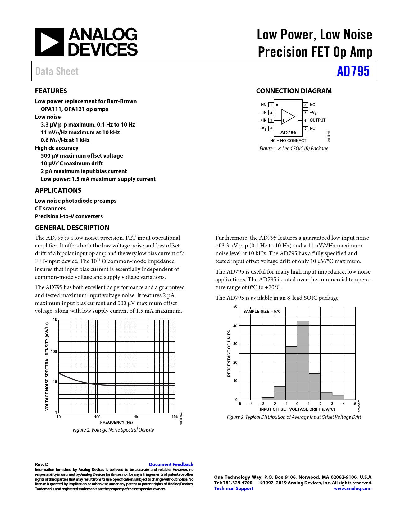

Low Power, Low Noise Precision FET Op Amp Data Sheet AD795 FEATURES CONNECTION DIAGRAM Low power replacement for Burr-Brown NC 1 8 NC OPA111, OPA121 op amps –IN 2 7 +VS Low noise +IN 3 6 OUTPUT 3.3 μV p-p maximum, 0.1 Hz to 10 Hz –VS 4 5 NC 11 nV/√Hz maximum at 10 kHz AD795
001 45-
0.6 fA/√Hz at 1 kHz NC = NO CONNECT
008
High dc accuracy
Figure 1. 8-Lead SOIC (R) Package
500 μV maximum offset voltage 10 μV/°C maximum drift 2 pA maximum input bias current Low power: 1.5 mA maximum supply current APPLICATIONS Low noise photodiode preamps CT scanners Precision l-to-V converters GENERAL DESCRIPTION
The AD795 is a low noise, precision, FET input operational Furthermore, the AD795 features a guaranteed low input noise amplifier. It offers both the low voltage noise and low offset of 3.3 μV p-p (0.1 Hz to 10 Hz) and a 11 nV/√Hz maximum drift of a bipolar input op amp and the very low bias current of a noise level at 10 kHz. The AD795 has a fully specified and FET-input device. The 1014 Ω common-mode impedance tested input offset voltage drift of only 10 μV/°C maximum. insures that input bias current is essentially independent of The AD795 is useful for many high input impedance, low noise common-mode voltage and supply voltage variations. applications. The AD795 is rated over the commercial tempera- The AD795 has both excellent dc performance and a guaranteed ture range of 0°C to +70°C. and tested maximum input voltage noise. It features 2 pA The AD795 is available in an 8-lead SOIC package. maximum input bias current and 500 μV maximum offset
50
voltage, along with low supply current of 1.5 mA maximum.
SAMPLE SIZE = 570 1k ) Hz 40 V/ S T (n Y T UNI SI F 30 O EN 100 E D G L A A R NT 20 T RCE PEC E S P 10 10 ISE O N E G A T 0 L –5 –4 –3 –2 –1 0 1 2 3 4 5
0035-
VO INPUT OFFSET VOLTAGE DRIFT (µV/°C)
84
1
00 2
10 100 1k 10k
005- Figure 3. Typical Distribution of Average Input Offset Voltage Drift
FREQUENCY (Hz)
84 00 Figure 2. Voltage Noise Spectral Density
