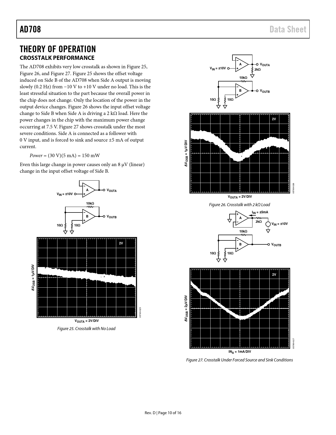

AD708 Data Sheet THEORY OF OPERATION CROSSTALK PERFORMANCE
The AD708 exhibits very low crosstalk as shown in Figure 25,
A VOUTA VIN = ±10V 2kΩ
Figure 26, and Figure 27. Figure 25 shows the offset voltage induced on Side B of the AD708 when Side A output is moving
10kΩ
slowly (0.2 Hz) from −10 V to +10 V under no load. This is the least stressful situation to the part because the overall power in
B VOUTB
the chip does not change. Only the location of the power in the
10Ω 10Ω
output device changes. Figure 26 shows the input offset voltage change to Side B when Side A is driving a 2 kΩ load. Here the power changes in the chip with the maximum power change
2V
occurring at 7.5 V. Figure 27 shows crosstalk under the most severe conditions. Side A is connected as a follower with 0 V input, and is forced to sink and source ±5 mA of output
V
current.
/DI V
Power = (30 V)(5 mA) = 150 mW
= SB
Even this large change in power causes only an 8 μV (linear)
V O Δ
change in the input offset voltage of Side B. 026
A VOUTA V
05789-
IN = ±10V VOUTA = 2V/DIV 10kΩ
Figure 26. Crosstalk with 2 kΩ Load
IIN = ±5mA B VOUTB A 2kΩ 10Ω 10Ω VIN = ±10V 10kΩ 2V B VOUTB 10Ω 10Ω V /DI V 2V 1µ = SB V O Δ V /DI V
025
= SB
05789-
V O V Δ OUTA = 2V/DIV
Figure 25. Crosstalk with No Load 027 05789-
INA = 1mA/DIV
