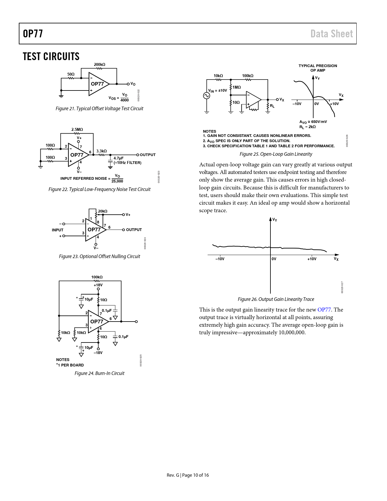

Figure 21. Typical Offset Voltage Test Circuit

Figure 25. Open-Loop Gain Linearity
100Ω 3 4.7µF 4 (≈10Hz FILTER)
Actual open-loop voltage gain can vary greatly at various output
V–
voltages. All automated testers use endpoint testing and therefore

O INPUT REFERRED NOISE = 25,000
only show the average gain. This causes errors in high closed- 00320- Figure 22. Typical Low-Frequency Noise Test Circuit loop gain circuits. Because this is difficult for manufacturers to test, users should make their own evaluations. This simple test circuit makes it easy. An ideal op amp would show a horizontal

scope trace.

00320- Figure 23. Optional Offset Nulling Circuit

Figure 26. Output Gain Linearity Trace

This is the output gain linearity trace for the new OP77. The
2 7
output trace is virtually horizontal at all points, assuring
6 OP77 3
extremely high gain accuracy. The average open-loop gain is
4 10kΩ 10kΩ
truly impressive—approximately 10,000,000.
