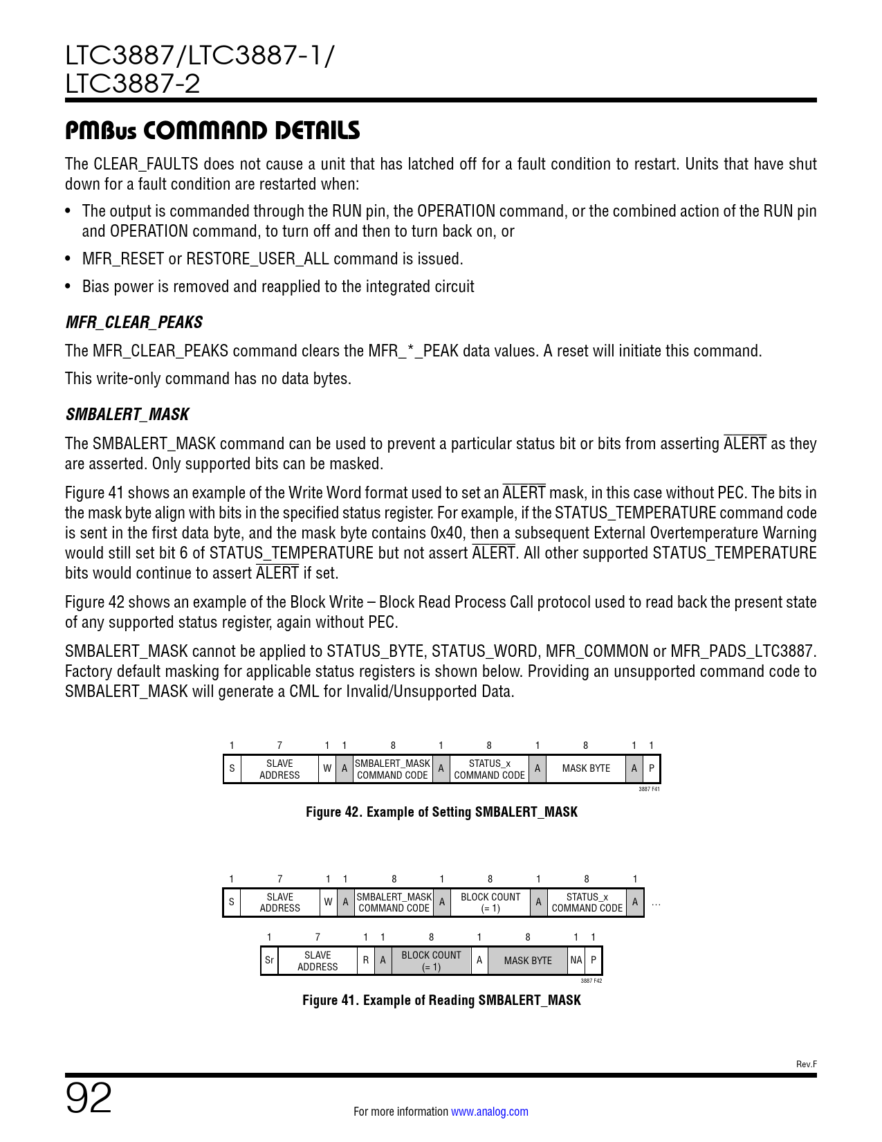

PMBus COMMAND DETAILS
The CLEAR_FAULTS does not cause a unit that has latched off for a fault condition to restart. Units that have shut down for a fault condition are restarted when: • The output is commanded through the RUN pin, the OPERATION command, or the combined action of the RUN pin and OPERATION command, to turn off and then to turn back on, or • MFR_RESET or RESTORE_USER_ALL command is issued. • Bias power is removed and reapplied to the integrated circuit
MFR_CLEAR_PEAKS
The MFR_CLEAR_PEAKS command clears the MFR_*_PEAK data values. A reset will initiate this command. This write-only command has no data bytes.
SMBALERT_MASK
The SMBALERT_MASK command can be used to prevent a particular status bit or bits from asserting ALERT as they are asserted. Only supported bits can be masked. Figure 41 shows an example of the Write Word format used to set an ALERT mask, in this case without PEC. The bits in the mask byte align with bits in the specified status register. For example, if the STATUS_TEMPERATURE command code is sent in the first data byte, and the mask byte contains 0x40, then a subsequent External Overtemperature Warning would still set bit 6 of STATUS_TEMPERATURE but not assert ALERT. All other supported STATUS_TEMPERATURE bits would continue to assert ALERT if set. Figure 42 shows an example of the Block Write – Block Read Process Call protocol used to read back the present state of any supported status register, again without PEC. SMBALERT_MASK cannot be applied to STATUS_BYTE, STATUS_WORD, MFR_COMMON or MFR_PADS_LTC3887. Factory default masking for applicable status registers is shown below. Providing an unsupported command code to SMBALERT_MASK will generate a CML for Invalid/Unsupported Data. 1 7 1 1 8 1 8 1 8 1 1 SLAVE SMBALERT_MASK STATUS_x S W A A A MASK BYTE A P ADDRESS COMMAND CODE COMMAND CODE 3887 F41
Figure 42. Example of Setting SMBALERT_MASK
1 7 1 1 8 1 8 1 8 1 SLAVE SMBALERT_MASK BLOCK COUNT S W A A STATUS_x A A … ADDRESS COMMAND CODE (= 1) COMMAND CODE 1 7 1 1 8 1 8 1 1 Sr SLAVE BLOCK COUNT R A A MASK BYTE NA P ADDRESS (= 1) 3887 F42
Figure 41. Example of Reading SMBALERT_MASK
