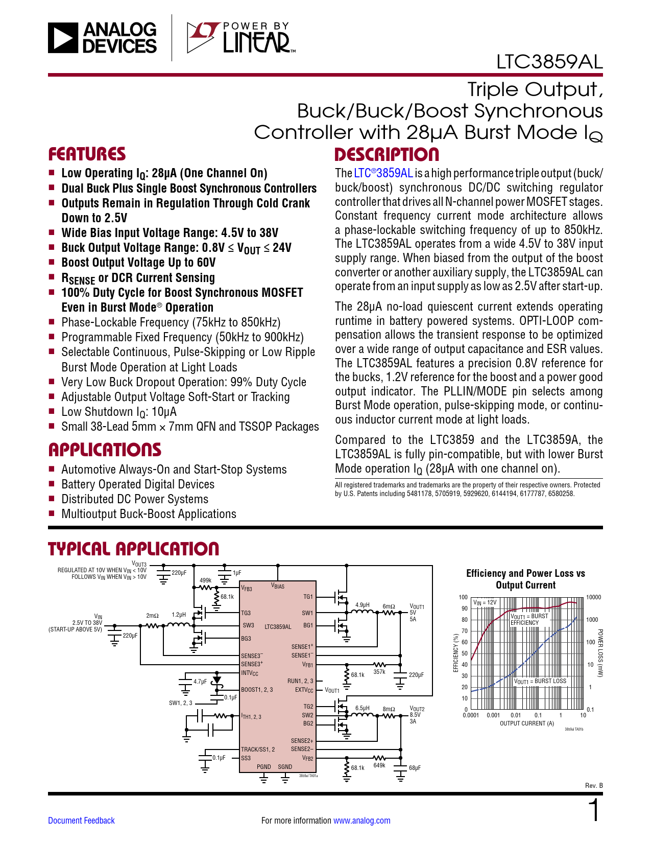

TYPICAL APPLICATION
VOUT3 REGULATED AT 10V WHEN VIN < 10V 220µF 1µF FOLLOWS V
Efficiency and Power Loss vs
IN WHEN VIN > 10V 499k V VBIAS
Output Current
FB3 68.1k TG1 100 10000 4.9µH V 6mΩ V IN = 12V OUT1 90 V 2mΩ 1.2µH TG3 SW1 5V IN VOUT1 = BURST 2.5V TO 38V 5A 80 1000 SW3 EFFICIENCY LTC3859AL BG1 (START-UP ABOVE 5V) POWER LOSS (mW) 70 220µF BG3 60 100 SENSE1+ SENSE3– SENSE1– 50 SENSE3+ VFB1 40 10 INTV EFFICIENCY (%) CC 357k 68.1k 220µF 30 4.7µF RUN1, 2, 3 VOUT1 = BURST LOSS BOOST1, 2, 3 EXTV 20 1 CC VOUT1 0.1µF 10 SW1, 2, 3 TG2 6.5µH 8mΩ VOUT2 0 0.1 ITH1, 2, 3 SW2 8.5V 0.0001 0.001 0.01 0.1 1 10 BG2 3A OUTPUT CURRENT (A) 3859al TA01b SENSE2+ TRACK/SS1, 2 SENSE2– 0.1µF SS3 VFB2 PGND SGND 649k 68.1k 68µF 3859al TA01a Rev. B Document Feedback For more information www.analog.com 1 Document Outline Features Applications Typical Application Description Absolute Maximum Ratings Pin Configuration Order Information Electrical Characteristics Typical Performance Characteristics Pin Functions Functional Diagram Operation Applications Information Typical Applications Package Description Revision History Typical Application Related Parts
