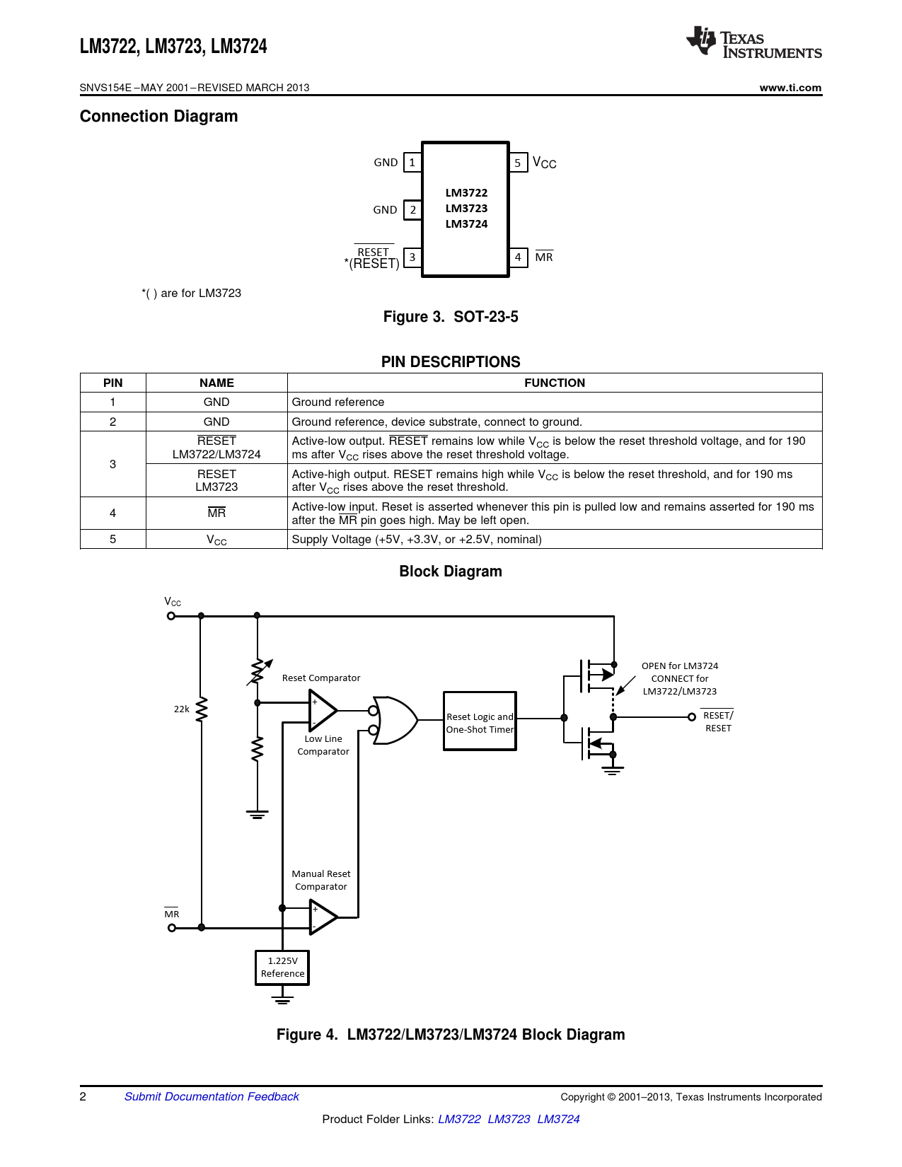

LM3722,. LM3723,. LM3724. www.ti.com. Connection Diagram. LM3722. LM3723. Figure 3. SOT-23-5. PIN DESCRIPTIONS. PIN. NAME. FUNCTION
LM3722, LM3723, LM3724 www.ti.com Connection Diagram LM3722 LM3723 Figure 3 SOT-23-5 PIN DESCRIPTIONS PIN NAME FUNCTION
SNVS154E – MAY 2001 – REVISED MARCH 2013
GND 1 5 VCC
LM3722
GND 2
LM3723 LM3724
RESET 3 4 MR *(RESET) *( ) are for LM3723
Figure 3. SOT-23-5 PIN DESCRIPTIONS PIN NAME FUNCTION
1 GND Ground reference 2 GND Ground reference, device substrate, connect to ground. RESET Active-low output. RESET remains low while VCC is below the reset threshold voltage, and for 190 LM3722/LM3724 ms after VCC rises above the reset threshold voltage. 3 RESET Active-high output. RESET remains high while VCC is below the reset threshold, and for 190 ms LM3723 after VCC rises above the reset threshold. Active-low input. Reset is asserted whenever this pin is pulled low and remains asserted for 190 ms 4 MR after the MR pin goes high. May be left open. 5 VCC Supply Voltage (+5V, +3.3V, or +2.5V, nominal)
Block Diagram
VCC OPEN for LM3724 Reset Comparator CONNECT for LM3722/LM3723 + 22k Reset Logic and RESET/ - One-Shot Timer RESET Low Line Comparator Manual Reset Comparator + MR - 1.225V Reference
Figure 4. LM3722/LM3723/LM3724 Block Diagram
