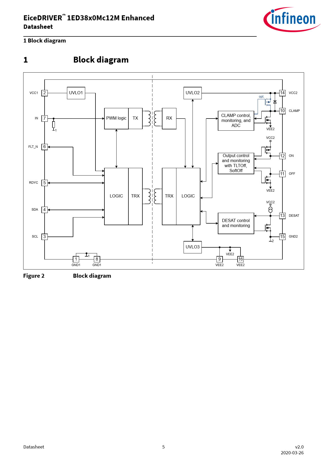

DescriptionEiceDRIVER 1ED38x0Mc12M Enhanced. Single-channel isolated gate driver IC with I2C configurability for DESAT, Soft-off, UVLO, Miller clamp and two-level turn-off

EiceDRIVER™ 1ED38x0Mc12M Enhanced. Datasheet. 1 Block diagram. Block diagram. Figure 2
EiceDRIVER™ 1ED38x0Mc12M Enhanced Datasheet 1 Block diagram Block diagram Figure 2
EiceDRIVER™ 1ED38x0Mc12M Enhanced Datasheet 1 Block diagram 1 Block diagram
VCC1 2 UVLO1 UVLO2 14 VCC2 opt. 10 CLAMP CLAMP control, IN 7 PWM logic TX RX monitoring, and ADC 1 VEE2 VCC2 FLT_N 6 Output control 12 ON and monitoring with TLTOff, SoftOff 11 OFF RDYC 5 VEE2 LOGIC TRX TRX LOGIC VCC2 SDA 4 13 DESAT DESAT control and monitoring SCL 3 15 GND2 2 UVLO3 VEE2 1 1 8 9 16 GND1 GND1 VEE2 VEE2
Figure 2 Block diagram
