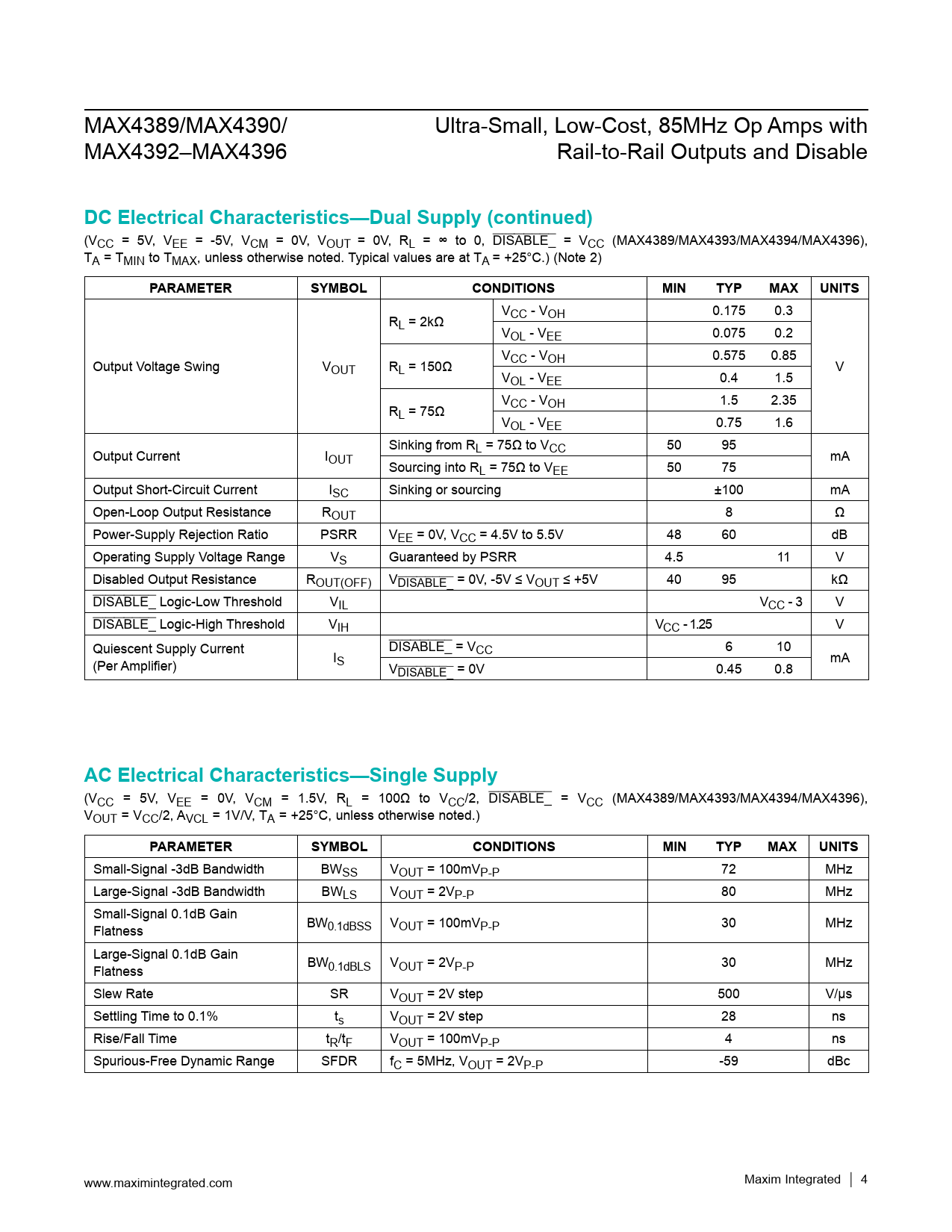

DC Electrical Characteristics—Dual Supply (continued). PARAMETER. SYMBOL. CONDITIONS. MIN. TYP. MAX. UNITS
DC Electrical Characteristics—Dual Supply (continued) PARAMETER SYMBOL CONDITIONS MIN TYP MAX UNITS
MAX4389/MAX4390/ Ultra-Small, Low-Cost, 85MHz Op Amps with MAX4392–MAX4396 Rail-to-Rail Outputs and Disable
(VCC = 5V, VEE = -5V, VCM = 0V, VOUT = 0V, RL = ∞ to 0, DISABLE_ = VCC (MAX4389/MAX4393/MAX4394/MAX4396), TA = TMIN to TMAX, unless otherwise noted. Typical values are at TA = +25°C.) (Note 2)
V R CC - VOH 0.175 0.3 L = 2kΩ VOL - VEE 0.075 0.2 V Output Voltage Swing V CC - VOH 0.575 0.85 OUT RL = 150Ω V VOL - VEE 0.4 1.5 V R CC - VOH 1.5 2.35 L = 75Ω VOL - VEE 0.75 1.6 Sinking from R Output Current I L = 75Ω to VCC 50 95 OUT mA Sourcing into RL = 75Ω to VEE 50 75 Output Short-Circuit Current ISC Sinking or sourcing ±100 mA Open-Loop Output Resistance ROUT 8 Ω Power-Supply Rejection Ratio PSRR VEE = 0V, VCC = 4.5V to 5.5V 48 60 dB Operating Supply Voltage Range VS Guaranteed by PSRR 4.5 11 V Disabled Output Resistance ROUT(OFF) VDISABLE_ = 0V, -5V ≤ VOUT ≤ +5V 40 95 kΩ DISABLE_ Logic-Low Threshold VIL VCC - 3 V DISABLE_ Logic-High Threshold VIH VCC - 1.25 V Quiescent Supply Current DISABLE_ = VCC 6 10 (Per Amplifier) IS mA VDISABLE_ = 0V 0.45 0.8
AC Electrical Characteristics—Single Supply
(VCC = 5V, VEE = 0V, VCM = 1.5V, RL = 100Ω to VCC/2, DISABLE_ = VCC (MAX4389/MAX4393/MAX4394/MAX4396), VOUT = VCC/2, AVCL = 1V/V, TA = +25°C, unless otherwise noted.)
Small-Signal -3dB Bandwidth BWSS VOUT = 100mVP-P 72 MHz Large-Signal -3dB Bandwidth BWLS VOUT = 2VP-P 80 MHz Small-Signal 0.1dB Gain Flatness BW0.1dBSS VOUT = 100mVP-P 30 MHz Large-Signal 0.1dB Gain Flatness BW0.1dBLS VOUT = 2VP-P 30 MHz Slew Rate SR VOUT = 2V step 500 V/µs Settling Time to 0.1% ts VOUT = 2V step 28 ns Rise/Fall Time tR/tF VOUT = 100mVP-P 4 ns Spurious-Free Dynamic Range SFDR fC = 5MHz, VOUT = 2VP-P -59 dBc www.maximintegrated.com Maxim Integrated │
