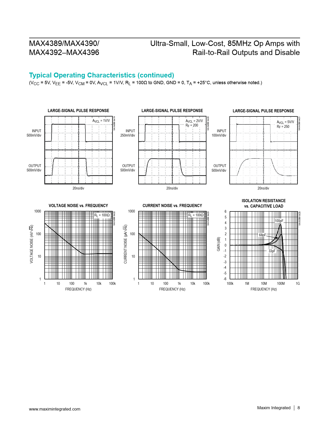

Typical Operating Characteristics (continued). LARGE-SIGNAL PULSE RESPONSE. ISOLATION RESISTANCE. VOLTAGE NOISE vs. FREQUENCY
MAX4389/MAX4390/ Ultra-Small, Low-Cost, 85MHz Op Amps with MAX4392–MAX4396 Rail-to-Rail Outputs and Disable
(VCC = 5V, VEE = -5V, VCM = 0V, AVCL = 1V/V, RL = 100Ω to GND, GND = 0, TA = +25°C, unless otherwise noted.)
LARGE-SIGNAL PULSE RESPONSE LARGE-SIGNAL PULSE RESPONSE LARGE-SIGNAL PULSE RESPONSE
AVCL = 1V/V AVCL = 2V/V A R VCL = 5V/V F = 200 RF = 250 MAX4389 toc19 INPUT MAX4389 toc20 INPUT MAX4389 toc21 INPUT 500mV/div 250mV/div 100mV/div OUTPUT OUTPUT OUTPUT 500mV/div 500mV/div 500mV/div 20ns/div 20ns/div 20ns/div
ISOLATION RESISTANCE VOLTAGE NOISE vs. FREQUENCY CURRENT NOISE vs. FREQUENCY vs. CAPACITIVE LOAD
1000 1000 6 RL = 100Ω RL = 100Ω 5 4 100pF MAX4389 toc22 MAX4389 toc23 MAX4389 toc24 √Hz) √Hz) 3 100 100 2 68pF 1 0 GAIN (dB) -1 33pF 10 10 -2 VOLTAGE NOISE (nV/ CURRENT NOISE (pA/ -3 -4 -5 1 1 -6 1 10 100 1k 10k 100k 1 10 100 1k 10k 100k 100k 1M 10M 100M 1G FREQUENCY (Hz) FREQUENCY (Hz) FREQUENCY (Hz) www.maximintegrated.com Maxim Integrated │ 8
