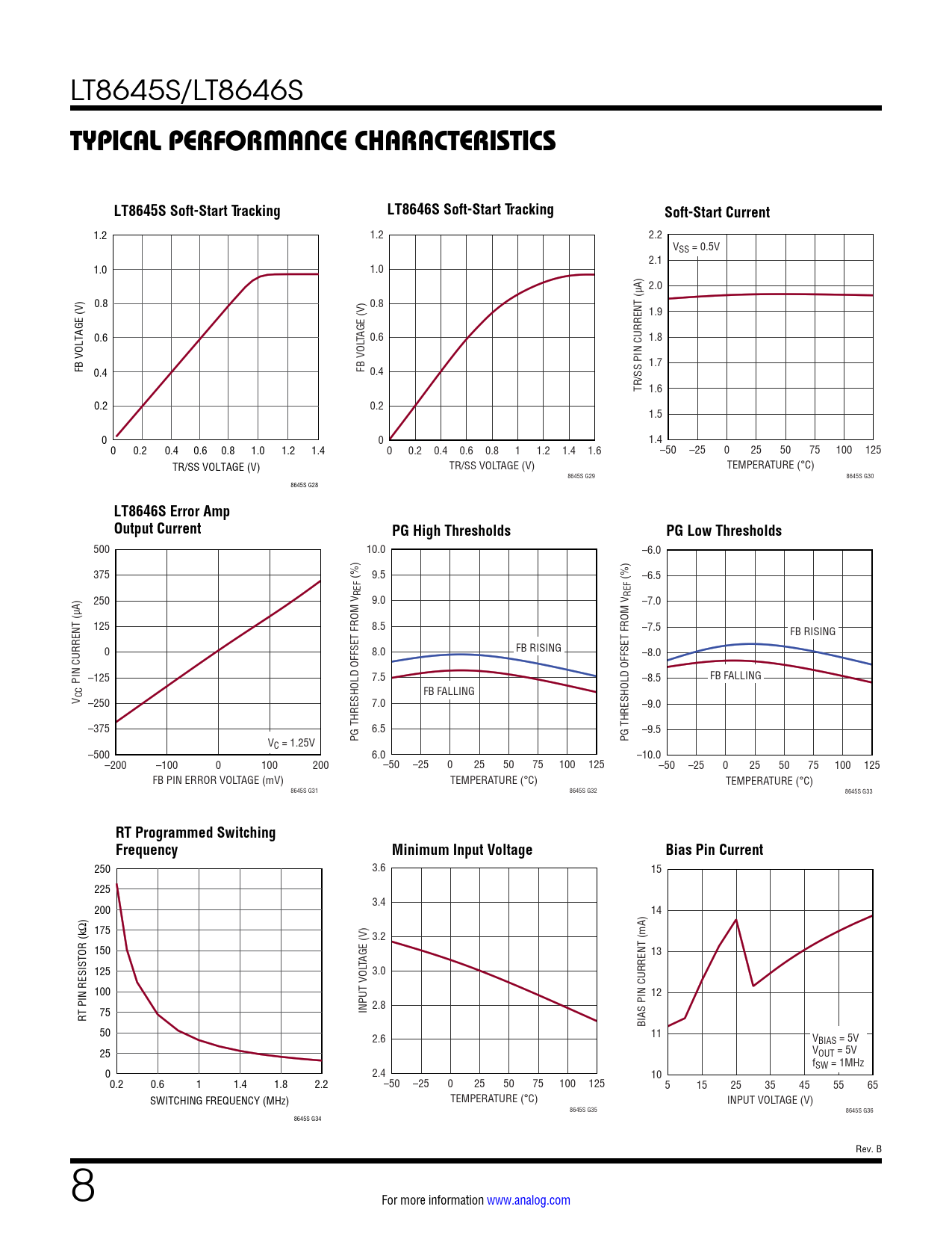

TYPICAL PERFORMANCE CHARACTERISTICS. LT8645S Soft-Start Tracking. LT8646S Soft-Start Tracking. Soft-Start Current
LT8645S/LT8646S
TYPICAL PERFORMANCE CHARACTERISTICS LT8645S Soft-Start Tracking LT8646S Soft-Start Tracking Soft-Start Current LT8646S Soft-Start Tracking
1.2 1.2 2.2 VSS = 0.5V 2.1 1.0 1.0 2.0 0.8 0.8 1.9 0.6 TAGE (V) 0.6 1.8 FB VOLTAGE (V) 1.7 0.4 FB VOL 0.4 TR/SS PIN CURRENT (µA) 1.6 0.2 0.2 1.5 0 0 1.4 0 0.2 0.4 0.6 0.8 1.0 1.2 1.4 0 0.2 0.4 0.6 0.8 1 1.2 1.4 1.6 –50 –25 0 25 50 75 100 125 TR/SS VOLTAGE (V) TR/SS VOLTAGE (V) TEMPERATURE (°C) 8645S G29 8645S G30 8645S G28
LT8646S Error Amp Output Current LT8646S Error Amp Output Current PG High Thresholds PG Low Thresholds
500 10.0 –6.0 375 9.5 (%) –6.5 (%) REF REF 250 9.0 –7.0 125 8.5 –7.5 FB RISING 0 FB RISING 8.0 –8.0 –125 –8.5 FB FALLING PIN CURRENT (µA) 7.5 FB FALLING V CC –250 7.0 –9.0 –375 6.5 –9.5 V PG THRESHOLD OFFSET FROM V PG THRESHOLD OFFSET FROM V C = 1.25V –500 6.0 –10.0 –200 –100 0 100 200 –50 –25 0 25 50 75 100 125 –50 –25 0 25 50 75 100 125 FB PIN ERROR VOLTAGE (mV) TEMPERATURE (°C) TEMPERATURE (°C) 8645S G31 8645S G32 8645S G33
RT Programmed Switching Frequency Minimum Input Voltage Bias Pin Current
