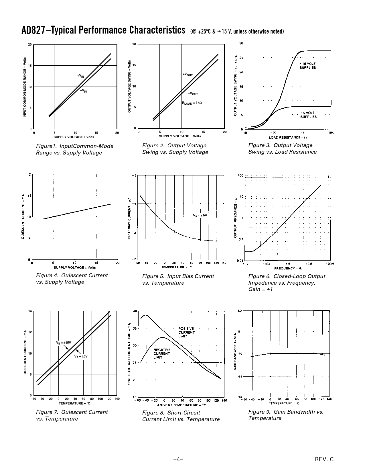

AD827–Typical Performance Characteristics (@ +25. C &. 15 V, unless otherwise noted). OUT. –VIN. –VOUT. RLOAD = 1k
AD827–Typical Performance Characteristics (@ +25 C & 15 V, unless otherwise noted) OUT –VIN –VOUT RLOAD = 1k
ⴗ
C &
ⴞ
15 V, unless otherwise noted) 20 20 15 15 +V +V OUT IN 10 10 –VIN –VOUT RLOAD = 1k
Ω
5 5 OUTPUT VOLTAGE SWING – Volts INPUT COMMON-MODE RANGE – Volts 0 0 0 5 10 15 20 0 5 10 15 20 SUPPLY VOLTAGE
Volts SUPPLY VOLTAGE
Volts
Figure1. InputCommon-Mode Figure 2. Output Voltage Figure 3. Output Voltage Range vs. Supply Voltage Swing vs. Supply Voltage Swing vs. Load Resistance Figure 4. Quiescent Current Figure 5. Input Bias Current Figure 6. Closed-Loop Output vs. Supply Voltage vs. Temperature Impedance vs. Frequency, Gain = +1
14 12 VS =
15V 10 VS =
5V QUIESCENT CURRENT – mA 8 0 –60 –40 –20 0 20 40 60 80 100 120 140 TEMPERATURE –
C
Figure 7. Quiescent Current Figure 8. Short-Circuit Figure 9. Gain Bandwidth vs. vs. Temperature Current Limit vs. Temperature Temperature –4– REV. C Document Outline FEATURES CONNECTION DIAGRAMS PRODUCT DESCRIPTION APPLICATION HIGHLIGHTS SPECIFICATIONS ABSOLUTE MAXIMUM RATINGS ORDERING GUIDE METALLIZATION PHOTOGRAPH Typical Performance Characteristics INPUT PROTECTION PRECAUTIONS VIDEO LINE DRIVER A HIGH SPEED THREE OP AMP INSTRUMENTATION AMPLIFIER CIRCUIT A TWO-CHIP VOLTAGE-CONTROLLED AMPLIFIER (VCA) WITH EXPONENTIAL RESPONSE Guidelines for Grounding and Bypassing OUTLINE DIMENSIONS Revision History
