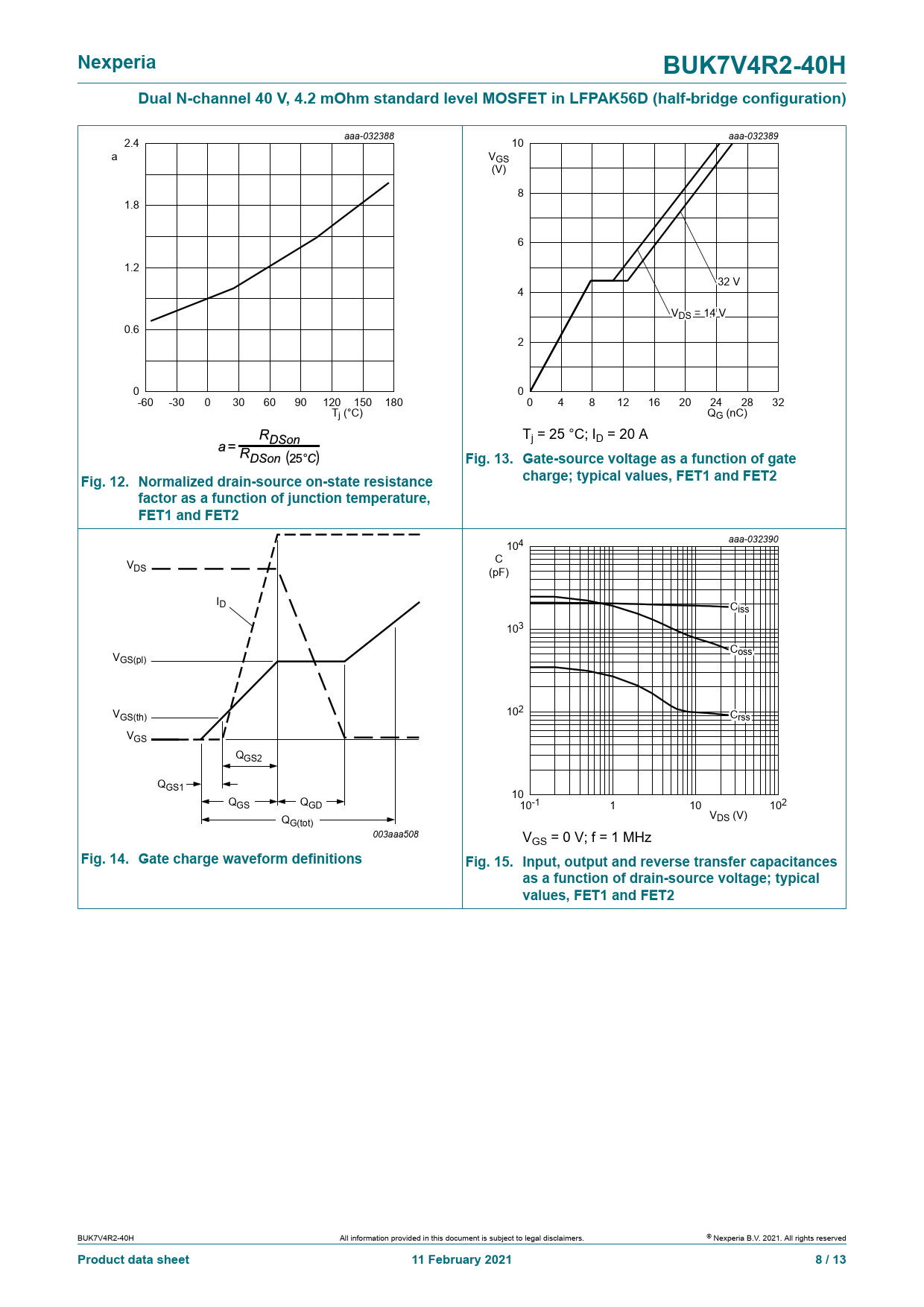

aaa-032388 2.4 aaa-032389 10 a VGS (V ( ) V 8 1.8 6 1.2 32 3 2 V 4 VDS = 1 4 1 4 V 0.6 2 0 0 -60 -30 0 30 60 90 120 150 180 0 4 8 12 16 20 24 28 32 Tj (°C) QG (nC) Tj = 25 °C; ID = 20 A
Fig. 13. Gate-source voltage as a function of gate Fig. 12. Normalized drain-source on-state resistance charge; typical values, FET1 and FET2 factor as a function of junction temperature, FET1 and FET2
aaa-032390 104 V C DS (p ( F p ) ID Ciss 103 C V oss o GS(pl) VGS(th) 102 Crss VGS QGS2 QGS1 10 QGS QGD 10-1 1 10 102 Q V G(tot) DS (V) 003aaa508 VGS = 0 V; f = 1 MHz
Fig. 14. Gate charge waveform definitions Fig. 15. Input, output and reverse transfer capacitances as a function of drain-source voltage; typical values, FET1 and FET2
