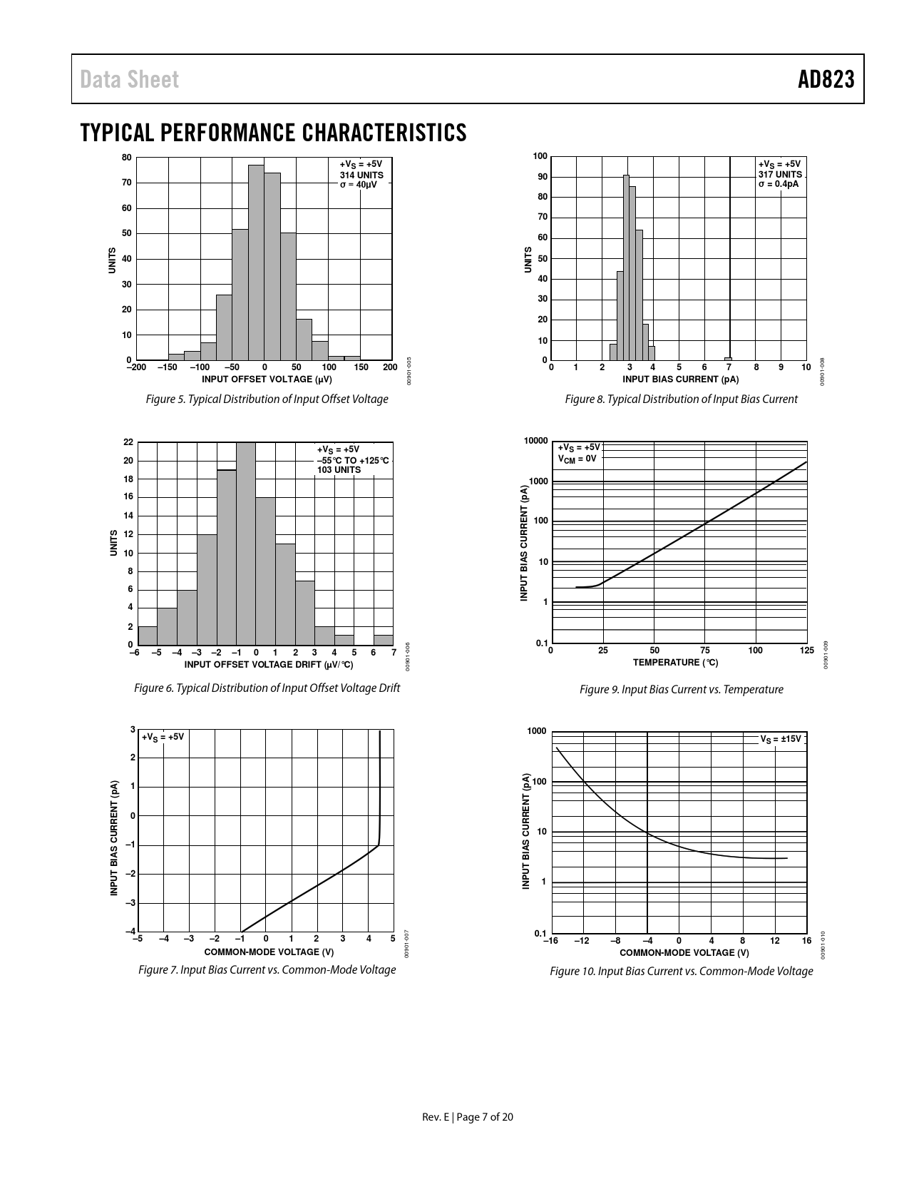

Data Sheet. AD823. TYPICAL PERFORMANCE CHARACTERISTICS. 100. +VS = +5V. 314 UNITS. 317 UNITS. σ = 40µV. σ = 0.4pA. T 40. T 50. UNI. –200. –150
Data Sheet AD823 TYPICAL PERFORMANCE CHARACTERISTICS 80 100 +VS = +5V +VS = +5V 314 UNITS 90 317 UNITS 70 σ = 40µV σ = 0.4pA 80 60 70 50 60 S S T 40 T 50 UNI UNI 40 30 30 20 20 10 10 0 0 –200 –150 –100 –50 0 50 100 150 200
005
0 1 2 3 4 5 6 7 8 9 10
008
INPUT OFFSET VOLTAGE (µV) INPUT BIAS CURRENT (pA)
00901- 00901- Figure 5. Typical Distribution of Input Offset Voltage Figure 8. Typical Distribution of Input Bias Current
22 10000 +V +V S = +5V S = +5V 20 –55°C TO +125°C VCM = 0V 103 UNITS 18 1000 A) 16 p ( 14 NT 100 S T 12 CURRE UNI 10 AS 10 8 BI UT 6 INP 1 4 2 0 0.1 –6 –5 –4 –3 –2 –1 0 1 2 3 4 5 6 7
006
0 25 50 75 100 125
009
INPUT OFFSET VOLTAGE DRIFT (µV/°C) TEMPERATURE (°C)
00901- 00901- Figure 6. Typical Distribution of Input Offset Voltage Drift Figure 9. Input Bias Current vs. Temperature
3 1000 +VS = +5V VS = ±15V 2 A) 100 A) 1 p p ( ( NT NT 0 10 CURRE CURRE –1 AS AS BI BI –2 UT UT 1 INP INP –3 –4 0.1 –5 –4 –3 –2 –1 0 1 2 3 4 5
007
–16 –12 –8 –4 0 4 8 12 16
010
COMMON-MODE VOLTAGE (V) COMMON-MODE VOLTAGE (V)
00901- 00901- Figure 7. Input Bias Current vs. Common-Mode Voltage Figure 10. Input Bias Current vs. Common-Mode Voltage Rev. E | Page 7 of 20 Document Outline Features Applications Connection Diagram General Description Table of Contents Revision History Specifications Absolute Maximum Ratings Thermal Resistance ESD Caution Typical Performance Characteristics Theory of Operation Output Impedance Application Notes Input Characteristics Output Characteristics A/D Driver 3 V, Single-Supply Stereo Headphone Driver Second-Order Low-Pass Filter Single-Supply Half-Wave and Full-Wave Rectifiers Outline Dimensions Ordering Guide
