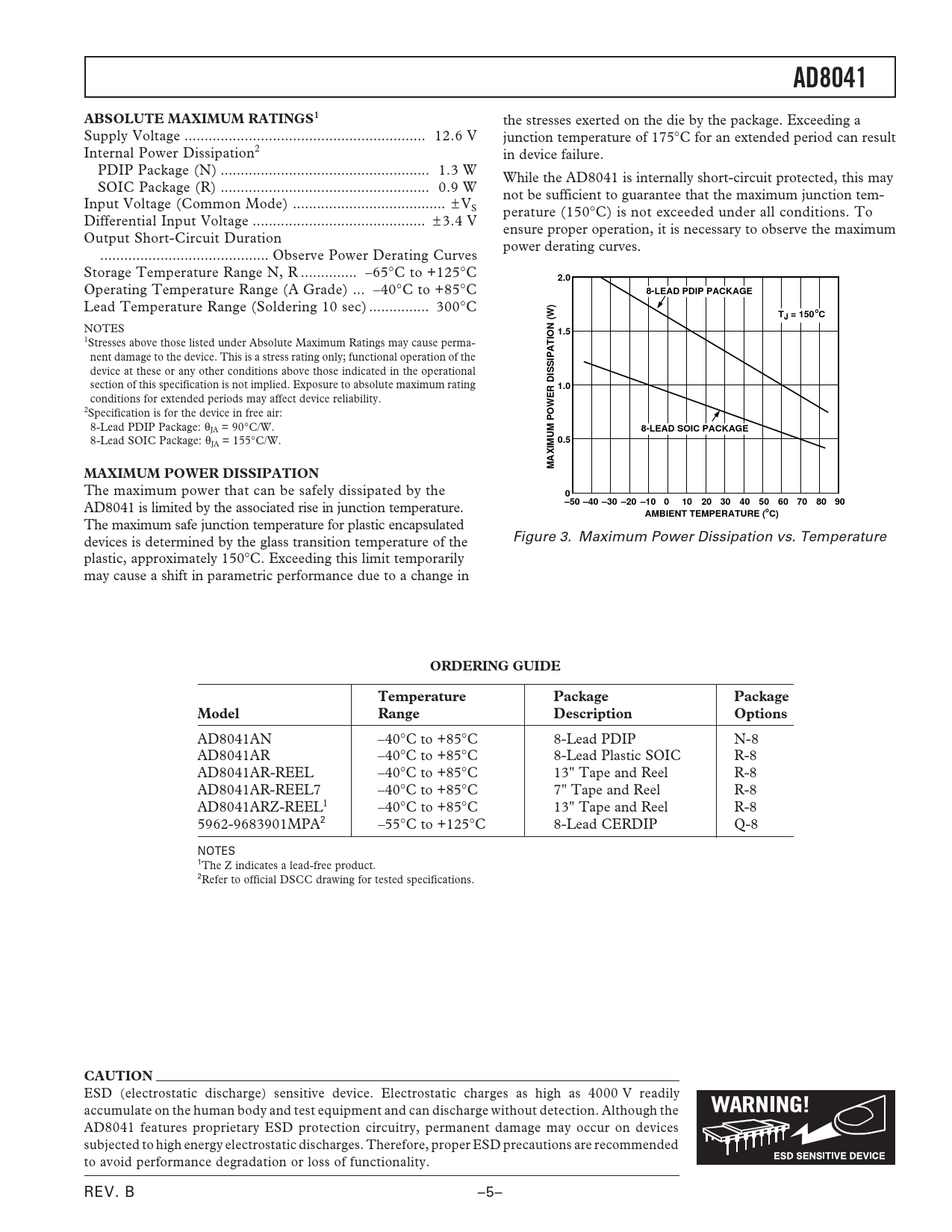

AD8041 ABSOLUTE MAXIMUM RATINGS1
the stresses exerted on the die by the package. Exceeding a Supply Voltage .. 12.6 V junction temperature of 175°C for an extended period can result Internal Power Dissipation2 in device failure. PDIP Package (N) .. 1.3 W While the AD8041 is internally short-circuit protected, this may SOIC Package (R) .. 0.9 W not be sufficient to guarantee that the maximum junction tem- Input Voltage (Common Mode) .. ± VS perature (150°C) is not exceeded under all conditions. To Differential Input Voltage ... ± 3.4 V ensure proper operation, it is necessary to observe the maximum Output Short-Circuit Duration power derating curves. .. Observe Power Derating Curves Storage Temperature Range N, R .. –65°C to +125°C
2.0
Operating Temperature Range (A Grade) ... –40°C to +85°C
8-LEAD PDIP PACKAGE
Lead Temperature Range (Soldering 10 sec) ... 300°C
TJ = 150
C
NOTES
1.5
1Stresses above those listed under Absolute Maximum Ratings may cause perma- nent damage to the device. This is a stress rating only; functional operation of the device at these or any other conditions above those indicated in the operational section of this specification is not implied. Exposure to absolute maximum rating
1.0
conditions for extended periods may affect device reliability. 2Specification is for the device in free air: 8-Lead PDIP Package: θJA = 90°C/W.
8-LEAD SOIC PACKAGE
8-Lead SOIC Package: θ
0.5
JA = 155°C/W.
MAXIMUM POWER DISSIPATION (W) MAXIMUM POWER DISSIPATION
The maximum power that can be safely dissipated by the
0
AD8041 is limited by the associated rise in junction temperature.
–50 –40 –30 –20 –10 0 10 20 30 40 50 60 70 80 90 AMBIENT TEMPERATURE (
C)
The maximum safe junction temperature for plastic encapsulated devices is determined by the glass transition temperature of the Figure 3. Maximum Power Dissipation vs. Temperature plastic, approximately 150°C. Exceeding this limit temporarily may cause a shift in parametric performance due to a change in
