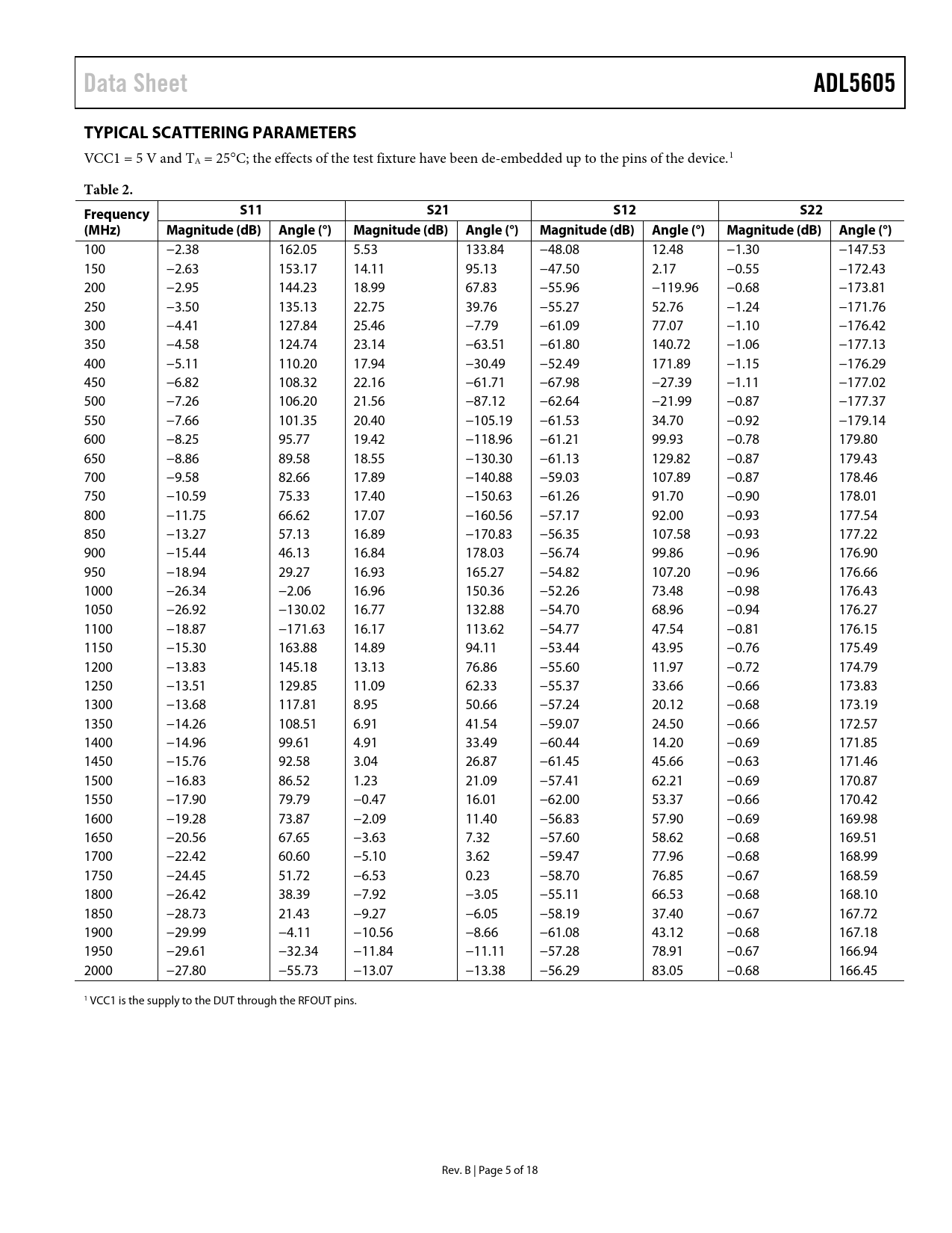

Data Sheet. ADL5605. TYPICAL SCATTERING PARAMETERS. Table 2. Frequency. S11. S21. S12. S22. (MHz). Magnitude (dB) Angle (°)
Data Sheet ADL5605 TYPICAL SCATTERING PARAMETERS Table 2 Frequency S11 S21 S12 S22 (MHz) Magnitude (dB) Angle (°)
VCC1 = 5 V and TA = 25°C; the effects of the test fixture have been de-embedded up to the pins of the device.1
Table 2. Frequency S11 S21 S12 S22 (MHz) Magnitude (dB) Angle (°) Magnitude (dB) Angle (°) Magnitude (dB) Angle (°) Magnitude (dB) Angle (°)
100 −2.38 162.05 5.53 133.84 −48.08 12.48 −1.30 −147.53 150 −2.63 153.17 14.11 95.13 −47.50 2.17 −0.55 −172.43 200 −2.95 144.23 18.99 67.83 −55.96 −119.96 −0.68 −173.81 250 −3.50 135.13 22.75 39.76 −55.27 52.76 −1.24 −171.76 300 −4.41 127.84 25.46 −7.79 −61.09 77.07 −1.10 −176.42 350 −4.58 124.74 23.14 −63.51 −61.80 140.72 −1.06 −177.13 400 −5.11 110.20 17.94 −30.49 −52.49 171.89 −1.15 −176.29 450 −6.82 108.32 22.16 −61.71 −67.98 −27.39 −1.11 −177.02 500 −7.26 106.20 21.56 −87.12 −62.64 −21.99 −0.87 −177.37 550 −7.66 101.35 20.40 −105.19 −61.53 34.70 −0.92 −179.14 600 −8.25 95.77 19.42 −118.96 −61.21 99.93 −0.78 179.80 650 −8.86 89.58 18.55 −130.30 −61.13 129.82 −0.87 179.43 700 −9.58 82.66 17.89 −140.88 −59.03 107.89 −0.87 178.46 750 −10.59 75.33 17.40 −150.63 −61.26 91.70 −0.90 178.01 800 −11.75 66.62 17.07 −160.56 −57.17 92.00 −0.93 177.54 850 −13.27 57.13 16.89 −170.83 −56.35 107.58 −0.93 177.22 900 −15.44 46.13 16.84 178.03 −56.74 99.86 −0.96 176.90 950 −18.94 29.27 16.93 165.27 −54.82 107.20 −0.96 176.66 1000 −26.34 −2.06 16.96 150.36 −52.26 73.48 −0.98 176.43 1050 −26.92 −130.02 16.77 132.88 −54.70 68.96 −0.94 176.27 1100 −18.87 −171.63 16.17 113.62 −54.77 47.54 −0.81 176.15 1150 −15.30 163.88 14.89 94.11 −53.44 43.95 −0.76 175.49 1200 −13.83 145.18 13.13 76.86 −55.60 11.97 −0.72 174.79 1250 −13.51 129.85 11.09 62.33 −55.37 33.66 −0.66 173.83 1300 −13.68 117.81 8.95 50.66 −57.24 20.12 −0.68 173.19 1350 −14.26 108.51 6.91 41.54 −59.07 24.50 −0.66 172.57 1400 −14.96 99.61 4.91 33.49 −60.44 14.20 −0.69 171.85 1450 −15.76 92.58 3.04 26.87 −61.45 45.66 −0.63 171.46 1500 −16.83 86.52 1.23 21.09 −57.41 62.21 −0.69 170.87 1550 −17.90 79.79 −0.47 16.01 −62.00 53.37 −0.66 170.42 1600 −19.28 73.87 −2.09 11.40 −56.83 57.90 −0.69 169.98 1650 −20.56 67.65 −3.63 7.32 −57.60 58.62 −0.68 169.51 1700 −22.42 60.60 −5.10 3.62 −59.47 77.96 −0.68 168.99 1750 −24.45 51.72 −6.53 0.23 −58.70 76.85 −0.67 168.59 1800 −26.42 38.39 −7.92 −3.05 −55.11 66.53 −0.68 168.10 1850 −28.73 21.43 −9.27 −6.05 −58.19 37.40 −0.67 167.72 1900 −29.99 −4.11 −10.56 −8.66 −61.08 43.12 −0.68 167.18 1950 −29.61 −32.34 −11.84 −11.11 −57.28 78.91 −0.67 166.94 2000 −27.80 −55.73 −13.07 −13.38 −56.29 83.05 −0.68 166.45 1 VCC1 is the supply to the DUT through the RFOUT pins. Rev. B | Page 5 of 18 Document Outline FEATURES APPLICATIONS GENERAL DESCRIPTION FUNCTIONAL BLOCK DIAGRAM TABLE OF CONTENTS REVISION HISTORY SPECIFICATIONS TYPICAL SCATTERING PARAMETERS ABSOLUTE MAXIMUM RATINGS THERMAL RESISTANCE ESD CAUTION PIN CONFIGURATION AND FUNCTION DESCRIPTIONS TYPICAL PERFORMANCE CHARACTERISTICS 748 MHZ FREQUENCY TUNING BAND 881 MHZ FREQUENCY TUNING BAND 943 MHZ FREQUENCY TUNING BAND GENERAL APPLICATIONS INFORMATION BASIC LAYOUT CONNECTIONS Power Supply RF Input Interface RF Output Interface Power-Down ADL5605 MATCHING ACPR AND EVM THERMAL CONSIDERATIONS SOLDERING INFORMATION AND RECOMMENDED PCB LAND PATTERN EVALUATION BOARD OUTLINE DIMENSIONS ORDERING GUIDE
