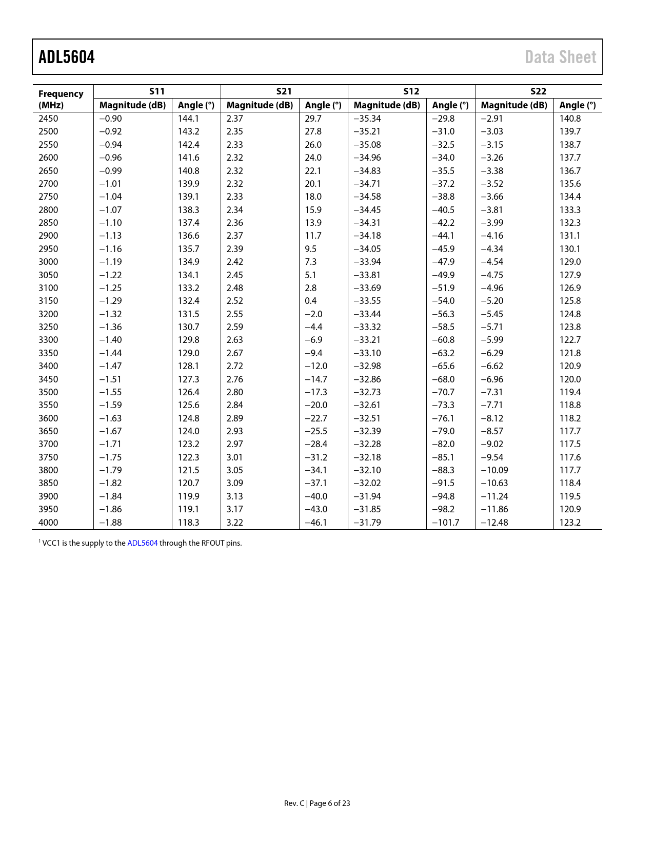

ADL5604. Data Sheet. Frequency. S11. S21. S12. S22. (MHz)
ADL5604 Data Sheet Frequency S11 S21 S12 S22 (MHz)
ADL5604 Data Sheet Frequency S11 S21 S12 S22 (MHz) Magnitude (dB) Angle (°) Magnitude (dB) Angle (°) Magnitude (dB) Angle (°) Magnitude (dB) Angle (°)
2450 −0.90 144.1 2.37 29.7 −35.34 −29.8 −2.91 140.8 2500 −0.92 143.2 2.35 27.8 −35.21 −31.0 −3.03 139.7 2550 −0.94 142.4 2.33 26.0 −35.08 −32.5 −3.15 138.7 2600 −0.96 141.6 2.32 24.0 −34.96 −34.0 −3.26 137.7 2650 −0.99 140.8 2.32 22.1 −34.83 −35.5 −3.38 136.7 2700 −1.01 139.9 2.32 20.1 −34.71 −37.2 −3.52 135.6 2750 −1.04 139.1 2.33 18.0 −34.58 −38.8 −3.66 134.4 2800 −1.07 138.3 2.34 15.9 −34.45 −40.5 −3.81 133.3 2850 −1.10 137.4 2.36 13.9 −34.31 −42.2 −3.99 132.3 2900 −1.13 136.6 2.37 11.7 −34.18 −44.1 −4.16 131.1 2950 −1.16 135.7 2.39 9.5 −34.05 −45.9 −4.34 130.1 3000 −1.19 134.9 2.42 7.3 −33.94 −47.9 −4.54 129.0 3050 −1.22 134.1 2.45 5.1 −33.81 −49.9 −4.75 127.9 3100 −1.25 133.2 2.48 2.8 −33.69 −51.9 −4.96 126.9 3150 −1.29 132.4 2.52 0.4 −33.55 −54.0 −5.20 125.8 3200 −1.32 131.5 2.55 −2.0 −33.44 −56.3 −5.45 124.8 3250 −1.36 130.7 2.59 −4.4 −33.32 −58.5 −5.71 123.8 3300 −1.40 129.8 2.63 −6.9 −33.21 −60.8 −5.99 122.7 3350 −1.44 129.0 2.67 −9.4 −33.10 −63.2 −6.29 121.8 3400 −1.47 128.1 2.72 −12.0 −32.98 −65.6 −6.62 120.9 3450 −1.51 127.3 2.76 −14.7 −32.86 −68.0 −6.96 120.0 3500 −1.55 126.4 2.80 −17.3 −32.73 −70.7 −7.31 119.4 3550 −1.59 125.6 2.84 −20.0 −32.61 −73.3 −7.71 118.8 3600 −1.63 124.8 2.89 −22.7 −32.51 −76.1 −8.12 118.2 3650 −1.67 124.0 2.93 −25.5 −32.39 −79.0 −8.57 117.7 3700 −1.71 123.2 2.97 −28.4 −32.28 −82.0 −9.02 117.5 3750 −1.75 122.3 3.01 −31.2 −32.18 −85.1 −9.54 117.6 3800 −1.79 121.5 3.05 −34.1 −32.10 −88.3 −10.09 117.7 3850 −1.82 120.7 3.09 −37.1 −32.02 −91.5 −10.63 118.4 3900 −1.84 119.9 3.13 −40.0 −31.94 −94.8 −11.24 119.5 3950 −1.86 119.1 3.17 −43.0 −31.85 −98.2 −11.86 120.9 4000 −1.88 118.3 3.22 −46.1 −31.79 −101.7 −12.48 123.2 1 VCC1 is the supply to the ADL5604 through the RFOUT pins. Rev. C | Page 6 of 23 Document Outline Features Functional Block Diagram General Description Table of Contents Revision History Specifications Typical Scattering Parameters Absolute Maximum Ratings ESD Caution Pin Configuration and Function Descriptions Typical Performance Characteristics Applications Information Basic Layout Connections Power Supply RF Input Interface RF Output Interface Power-Down Circuit ADL5604 Match ACPR and EVM Thermal Considerations Soldering Information and Recommended PCB Land Pattern Evaluation Board Outline Dimensions Ordering Guide
