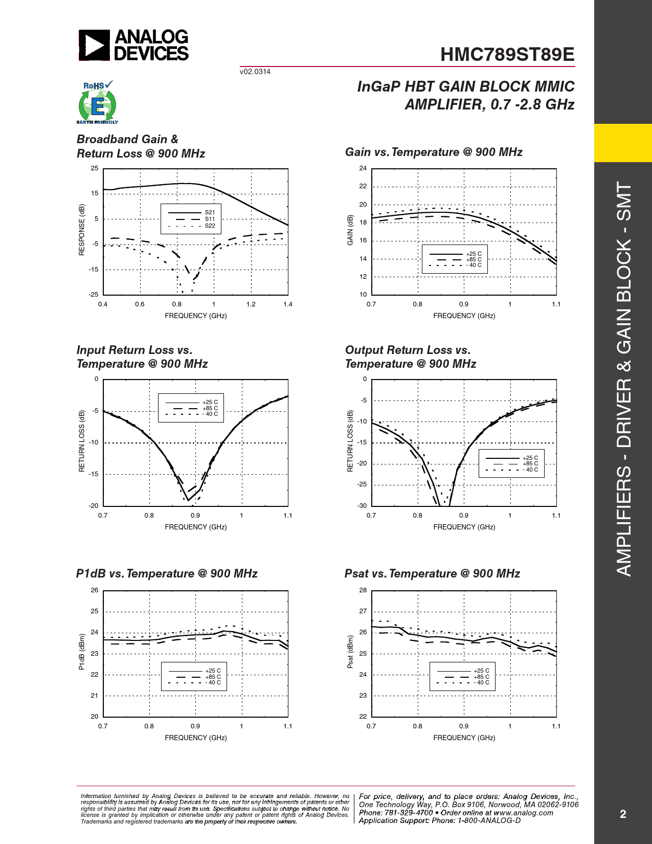

HMC789ST89E. InGaP HBT GAIN BLOCK MMIC. AMPLIFIER, 0.7 -2.8 GHz. Broadband Gain & Return Loss @ 900 MHz
HMC789ST89E InGaP HBT GAIN BLOCK MMIC AMPLIFIER, 0.7 -2.8 GHz Broadband Gain & Return Loss @ 900 MHz
HMC789ST89E
v02.0314
InGaP HBT GAIN BLOCK MMIC AMPLIFIER, 0.7 -2.8 GHz Broadband Gain & Return Loss @ 900 MHz Gain vs. Temperature @ 900 MHz
25 24 22 15 T 20 M S21 (dB) 5 S11 18 S22 (dB) -5 16 GAIN +25 C K - S RESPONSE 14 +85 C - 40 C C -15 12 LO -25 10 0.4 0.6 0.8 1 1.2 1.4 0.7 0.8 0.9 1 1.1 FREQUENCY (GHz) FREQUENCY (GHz) IN B A
Input Return Loss vs. Output Return Loss vs. Temperature @ 900 MHz Temperature @ 900 MHz
0 0 R & G +25 C -5 E -5 +85 C - 40 C (dB) (dB) -10 IV R LOSS -10 LOSS -15 +25 C -20 +85 C RETURN RETURN - 40 C -15 S - D -25 R -20 -30 IE 0.7 0.8 0.9 1 1.1 0.7 0.8 0.9 1 1.1 FREQUENCY (GHz) FREQUENCY (GHz) LIF P M
P1dB vs. Temperature @ 900 MHz Psat vs. Temperature @ 900 MHz
A 26 28 25 27 24 26 (dBm) 23 (dBm) 25 P1dB Psat 22 +25 C +25 C +85 C 24 +85 C - 40 C - 40 C 21 23 20 22 0.7 0.8 0.9 1 1.1 0.7 0.8 0.9 1 1.1 FREQUENCY (GHz) FREQUENCY (GHz) I F nf o or r p mati r o in cfe ur , d nish e e l d iv b e y r A y a nalo n g d t Devi o p ces i la s c bele o ieve rd d t e o rbs e : H acc iutrtatite e M and ic reli rao bl w e. a H v o e C wever o , nrp o For price, delivery, and to place orders: Analog Devices, Inc., responsibility is assumed by Analog Devices for its use, nor for any infringements of patents or other oration, 2 Elizabeth Drive, Chelmsford, MA 01824 One Technology Way, P.O. Box 9106, Norwood, MA 02062-9106 Phone: 978-250-3343 Fax: 978-250-3373 O rights of third parties that may result from its use. Specifications subject to change without notice. No rd Phoe n r O e: 7 n- 81-li 3 n 2 e a 9-4 t w 70 ww 0 • O . rdh e itt r o it nle i . n co e a m license is granted by implication or otherwise under any patent or patent rights of Analog Devices. t www.analog.com
