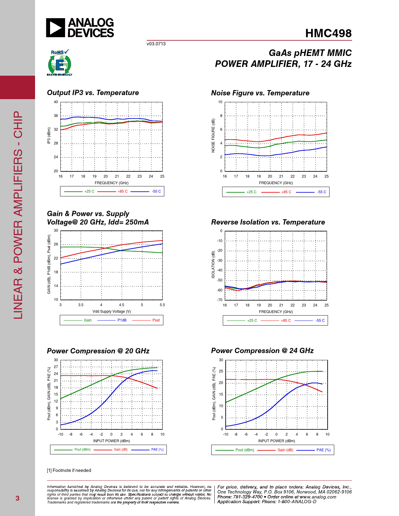

HMC498. GaAs pHEMT MMIC. POWER AMPLIFIER, 17 - 24 GHz. Output IP3 vs. Temperature. Noise Figure vs. Temperature
HMC498 GaAs pHEMT MMIC POWER AMPLIFIER, 17 - 24 GHz Output IP3 vs Temperature Noise Figure vs Temperature
HMC498
v03.0713
GaAs pHEMT MMIC POWER AMPLIFIER, 17 - 24 GHz Output IP3 vs. Temperature Noise Figure vs. Temperature
40 10 IP 36 8 ) H B d ( ) E 32 m 6 R U (dB IG 3 F IP 28 E 4 S - C IS O N R 24 2 IE 20 0 16 17 18 19 20 21 22 23 24 25 16 17 18 19 20 21 22 23 24 25 LIF FREQUENCY (GHz) FREQUENCY (GHz) P +25 C +85 C -55 C +25 C +85 C -55 C M
Gain & Power vs. Supply
R A
Voltage@ 20 GHz, Idd= 250mA Reverse Isolation vs. Temperature
E 30 0 ) W m B d -10 26 O t ( a s ) -20 ), P B d m 22 ( B N -30 d ( IO B T d A 1 18 L -40 O R & P ), P IS B d -50 A ( 14 IN A -60 E G 10 -70 IN 3 3.5 4 4.5 5 5.5 16 17 18 19 20 21 22 23 24 25 Vdd Supply Voltage (V) L FREQUENCY (GHz) Gain P1dB Psat +25 C +85 C -55 C
Power Compression @ 20 GHz Power Compression @ 24 GHz
30 30 ) 27 ) % % ( 25 24 ( E E A A 21 ), P ), P 20 B B d 18 d ( IN 15 IN A 15 A ), G 12 ), G m m B 10 9 B d d t ( t ( u 6 u o o P 5 P 3 0 0 -10 -8 -6 -4 -2 0 2 4 6 8 10 -10 -8 -6 -4 -2 0 2 4 6 8 10 INPUT POWER (dBm) INPUT POWER (dBm) Pout (dBm) Gain (dB) PAE (%) Pout (dBm) Gain (dB) PAE (%) [1] Footnote if needed Inf F or o m r p atio r n ifc ur e n , d ishe e d lbiv y e A r n y a alog n D d t evic o p es is la beclie o eved rd to ebre sa: H ccur iattti e tae M nd re ilicarbloew . H a o ve C wever, o n rp o For price, delivery, and to place orders: Analog Devices, Inc., responsibility is assumed by Analog Devices for its use, nor for any infringements of patents or other oration, 2 Elizabeth Drive, Chelmsford, MA 01824 One Technology Way, P.O. Box 9106, Norwood, MA 02062-9106 Phone: 978-250-3343 Fax: 978-250-3373 O rights of third parties that may result from its use. Specifications subject to change without notice. No P rd hone e r O : 7 n 81- -3li 2n 9 e a -47 t w 0 w 0 • O w rd .h e it r o t niltie n .c e ao t m
