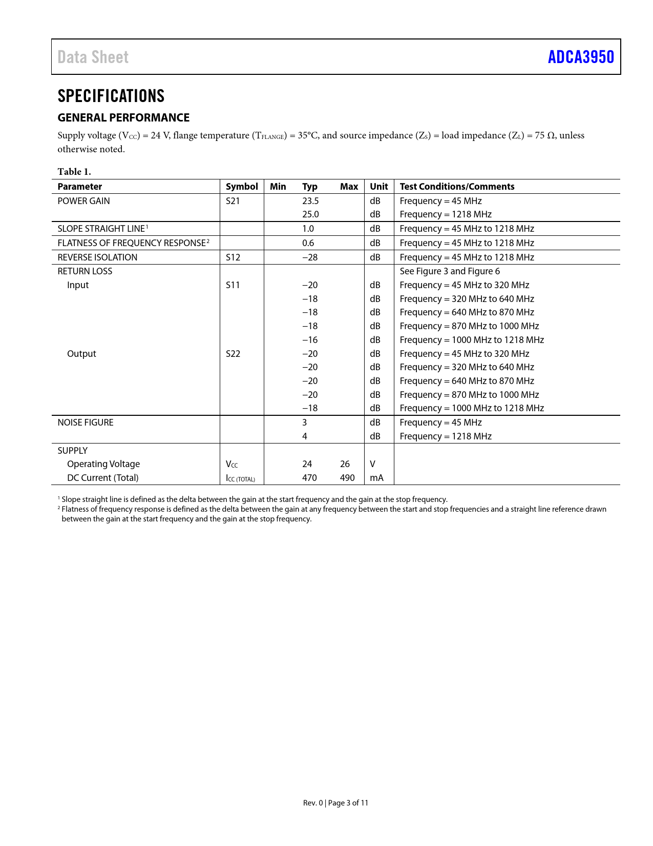

Data Sheet ADCA3950 SPECIFICATIONS GENERAL PERFORMANCE
Supply voltage (VCC) = 24 V, flange temperature (TFLANGE) = 35°C, and source impedance (ZS) = load impedance (ZL) = 75 Ω, unless otherwise noted.
Table 1. Parameter Symbol Min Typ Max Unit Test Conditions/Comments
POWER GAIN S21 23.5 dB Frequency = 45 MHz 25.0 dB Frequency = 1218 MHz SLOPE STRAIGHT LINE1 1.0 dB Frequency = 45 MHz to 1218 MHz FLATNESS OF FREQUENCY RESPONSE2 0.6 dB Frequency = 45 MHz to 1218 MHz REVERSE ISOLATION S12 −28 dB Frequency = 45 MHz to 1218 MHz RETURN LOSS See Figure 3 and Figure 6 Input S11 −20 dB Frequency = 45 MHz to 320 MHz −18 dB Frequency = 320 MHz to 640 MHz −18 dB Frequency = 640 MHz to 870 MHz −18 dB Frequency = 870 MHz to 1000 MHz −16 dB Frequency = 1000 MHz to 1218 MHz Output S22 −20 dB Frequency = 45 MHz to 320 MHz −20 dB Frequency = 320 MHz to 640 MHz −20 dB Frequency = 640 MHz to 870 MHz −20 dB Frequency = 870 MHz to 1000 MHz −18 dB Frequency = 1000 MHz to 1218 MHz NOISE FIGURE 3 dB Frequency = 45 MHz 4 dB Frequency = 1218 MHz SUPPLY Operating Voltage VCC 24 26 V DC Current (Total) ICC (TOTAL) 470 490 mA 1 Slope straight line is defined as the delta between the gain at the start frequency and the gain at the stop frequency. 2 Flatness of frequency response is defined as the delta between the gain at any frequency between the start and stop frequencies and a straight line reference drawn between the gain at the start frequency and the gain at the stop frequency. Rev. 0 | Page 3 of 11 Document Outline FEATURES APPLICATIONS GENERAL DESCRIPTION FUNCTIONAL BLOCK DIAGRAM TABLE OF CONTENTS REVISION HISTORY SPECIFICATIONS GENERAL PERFORMANCE DISTORTION DATA (ALL DIGITAL CHANNEL PLAN) DISTORTION DATA (MIXED SIGNAL CHANNEL PLAN) ABSOLUTE MAXIMUM RATINGS ESD CAUTION PIN CONFIGURATION AND FUNCTION DESCRIPTIONS TYPICAL PERFORMANCE CHARACTERISTICS S-PARAMETERS 18 dB TILT PERFORMANCE THEORY OF OPERATION APPLICATIONS INFORMATION OUTLINE DIMENSIONS ORDERING GUIDE
